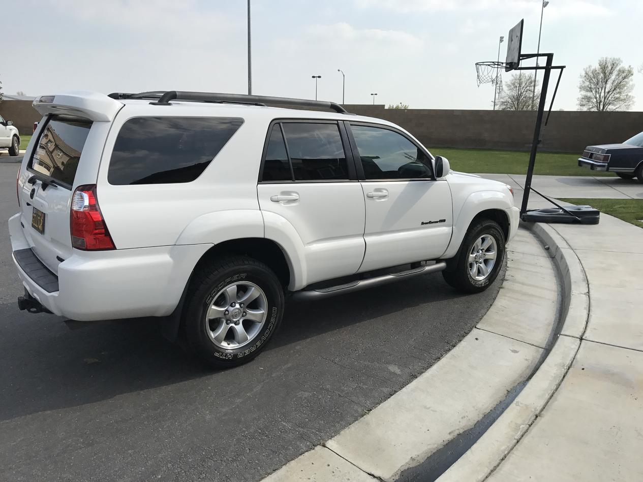

The 4Runner does not see much off-roading action and will mostly be used on the road with the occasional trips to the beach and snowboarding. I would like to give it a nice stance as I hate the wheels being so far into the fenders.

Bilsteins 5100 all around with stock springs (xreas removed at 69k due to leaking). Need to replace the stock springs. Current setup is too bouncy for my liking.
Wanting help with picking the best wheel / tire / spring combo for my usage? I would like to avoid having to do too much trimming.

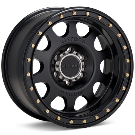

Wheels: Method Racing Wheels MR311 VEX
17x8.5 0mm offset $860 + $212(TPMS kit) = $1,072

Wheel spacers would poke your tires out and are cheaper than a wheel upgrade. But with a wheel upgrade, if you can sell your current set its not a bad option either.

The bouncy ride is mostly when going over uneven road surface (intersection, sometimes highway sections) at high speeds (65-80mph) when the 4runner lands back down, it tends to be quite bouncy and feel a bit unstable. This could just me mentally adjusting to getting back into a SUV after driving the ISF.
I thought of doing wheel spacers alone, but really wanted to get rid of the stock look. I am also not a fan of people that put spacers only and then the stance looks weird as it looks like the skinny tires are way out there. I've always modified my cars and the 4Runner just feels quite stock at the moment. I figured some black wheels with some all terrain tires would give it that wider stance that I love on so many rigs I see on here. Again this vehicle will mostly be driven in town with occasional out of town trips, thus road noise isn't a concern or anything. I will look into the Load C tires as I am not familiar with it.
Should I stick with the stock size or get something a bit wider for a more aggressive stance. What size do you recommend for the 17x8.5 wheel size. BTW your truck looks awesome. I have been following your build thread from a while back.
