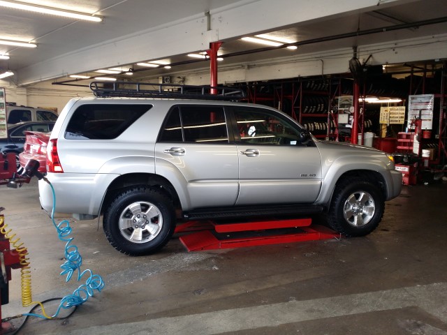

another option on tire size would be 255/75/17. i have the same size tire in 18's and love how they fill the fender. all depending on what tires your going with and coming from you gain about an inch with the tires. i have stuffed both front and rear to the bump stops and dont rub. other then moving the front fender liner its perfect
im running bfg rugged terrains 255/70/18 (32")
before fender liner moved
