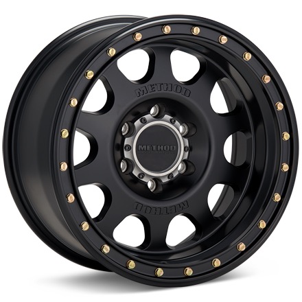

I just placed an order for a set of wheels and tires for my 2006 4Runner SE.
The X-Reas were removed a while back and currently running blisteins with stock springs all around.
Wheels ordered:
Method MR311 VEX 17 x 8.5 (0 offset).
Tires ordered:
BF Goodrich All Terrain KO2s 265/70 R17.
Currently the truck has the spidertraxx spacers on it, which I am planning to remove as I am hoping I wont need them with the new wheels & tires.
Americas Tire Co. assured me that the setup should work without rubbing. Bit hesistant on that as I was initially planning to go with 265/65 R17. But they insisted they would test fit and ensure it works without rubbing. They are willing to do minor trimming for me.
I am planning to move the bilsteins from the bottom setting to the one in the middle.
I have about $500 left in my mod budget. Any suggestions on whether its worth to change the springs. Truck doesn't see much off-roading, just some snowboarding trips.

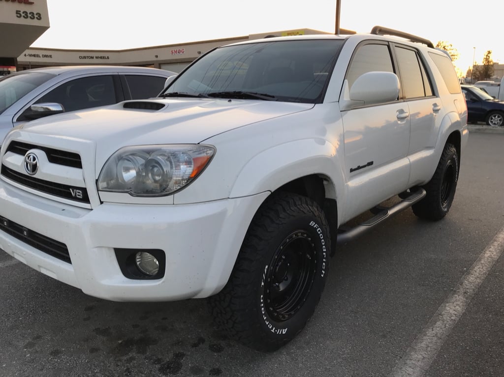

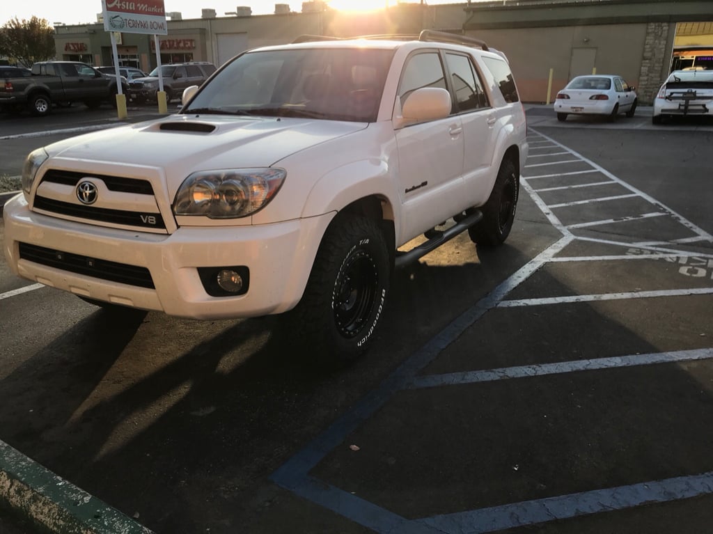

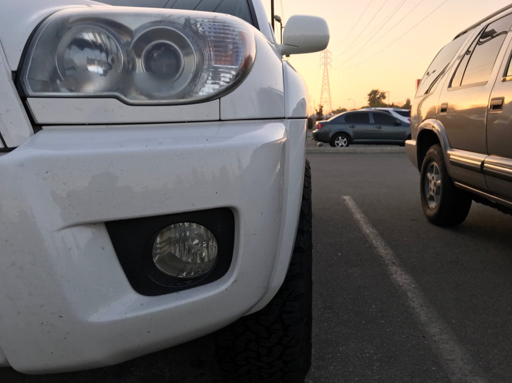

Waiting here to get alignment done. Photos don’t do it justice. Have minor rubbing on the fender and mud flap up front. Having them adjust the front bilsteins to the 1.75 or top notch to hopefully get rid of the rubbing without having to remove the mud flaps or mess with the liner. If not then tomorrow will be figuring out how to do that.
Looks killer, there is a post on here about how to do it. I just did it today, you can remove the 10mm screws underneath your front bumper that hold the wheel liner, pull it forward and get an idea where you want it to be without rubbing. Drill a new hole into the liner and button it back up. I also removed my mud flaps. Zero rubbing with 265/70/17's.

Looks awesome man. Yeah I’m just getting the alignment done. Will be removing the mud flaps tomorrow and then having my local mechanic adjust the bilsteins from .85 to 1.75 on Monday morning. Big brand tire wanted $220 to adjust the bilsteins,so I passed on that (have another mechanic that ca do it for much cheaper).
