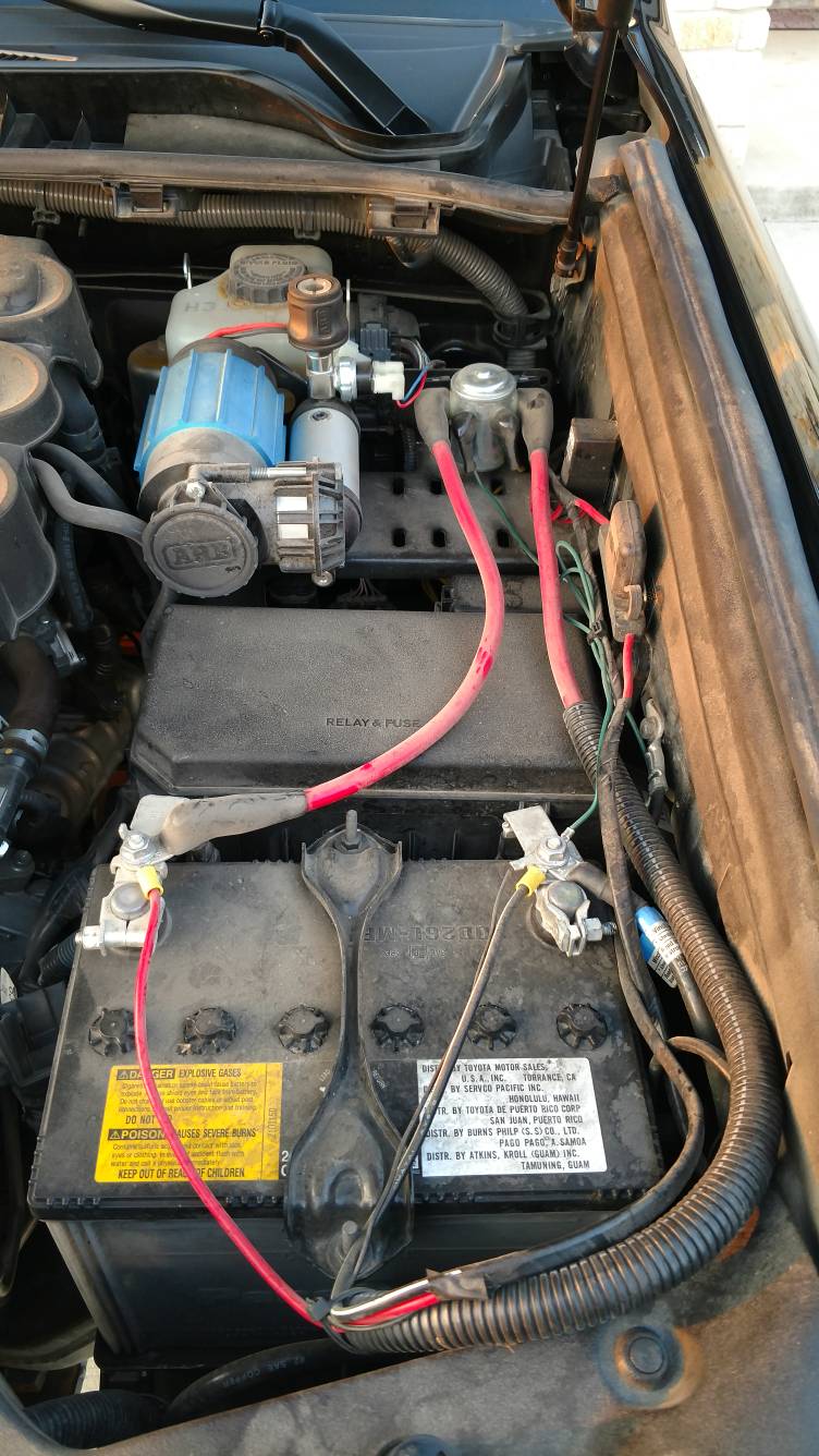

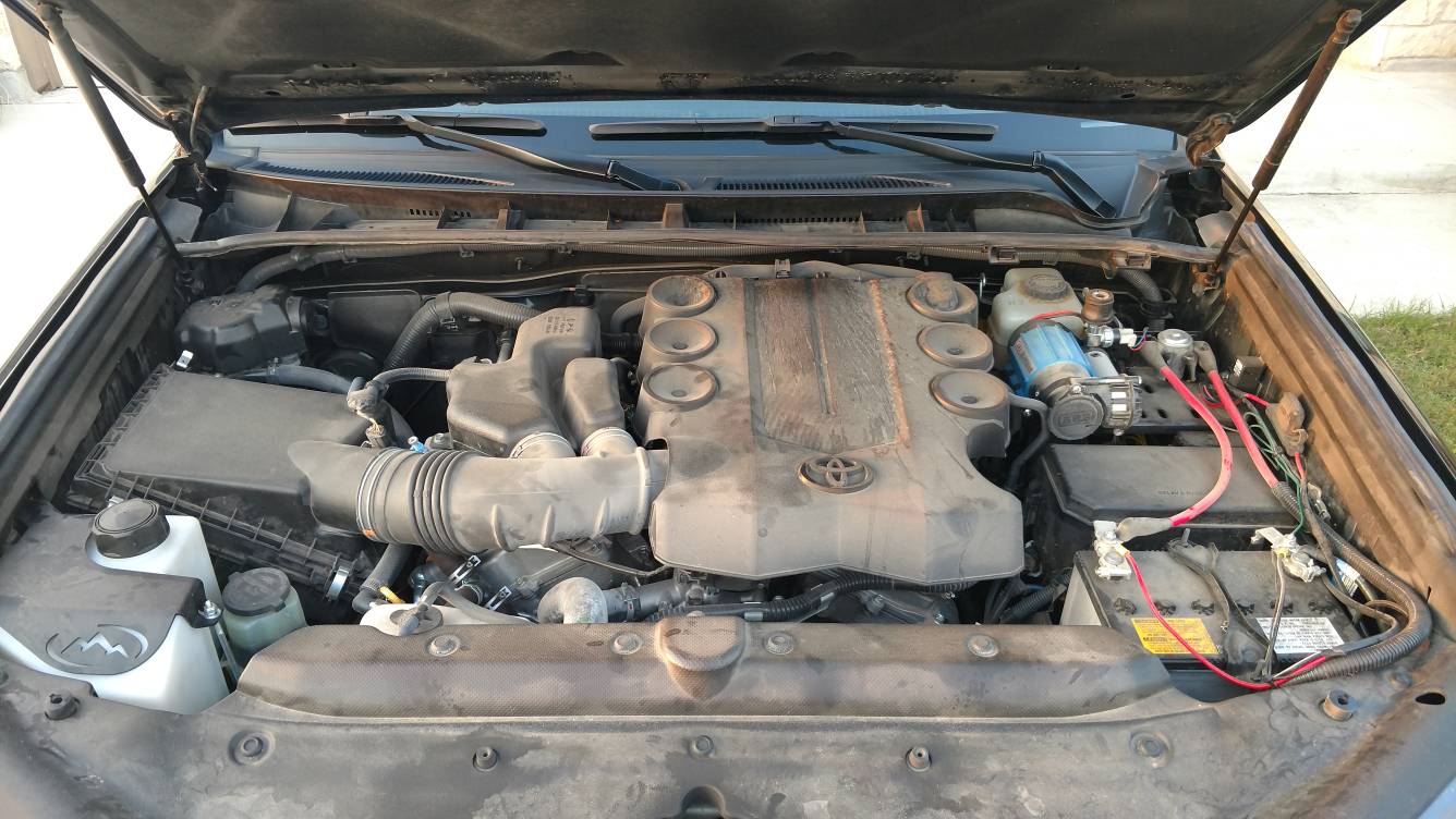

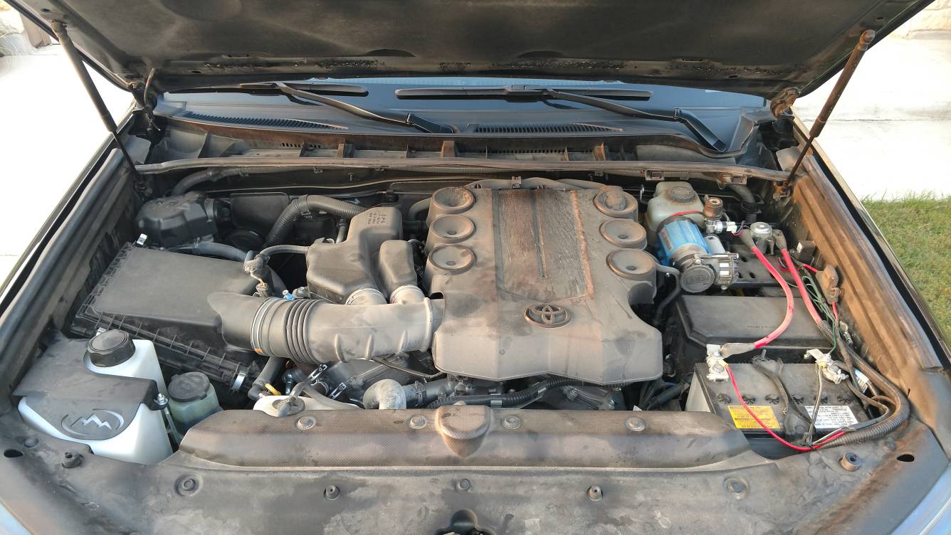

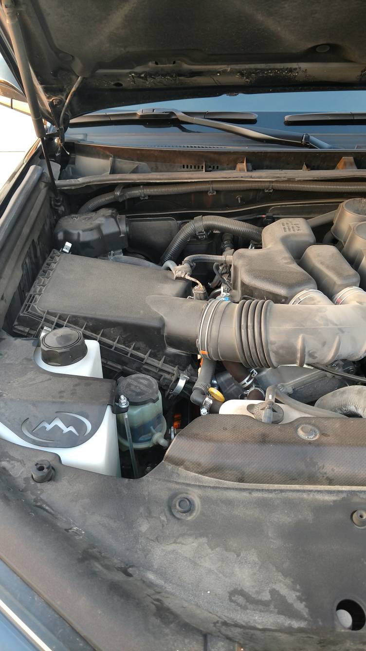

Now that we've cleared that up, my main question is, when I do get an SPOD where will I put it, OR will I be able to put it anywhere without messing with my current mounts and configuration? View the photos below. Accessories on the right side of the engine bay include a Slee Offroad ARB compressor mount with the Warn power disrupt solenoid attached as well. On the left I have an Expedition One washer reservoir with the other stuff relocated behind the airbox. I'll be installing an X2 Power 31M battery in a Pelfreybilt battery cage, and would like to tackle this SPOD thing relatively at the same time. Here are the photos:

^^^^agreed, mine is mounted on top of fuse box, and controlled by AOB switches in the blank factory spots
I went with sPOD SE 8 circuit mounted on the fuse box. I only have my ARB single compressor (slee mount) and a rigid 30in wired so far. If I didn't want it mounted on the fuse box, I'd probably fab a bracket or perhaps an [MENTION=125603]bandi[/MENTION] mount on the rear firewall side of the passenger side.

Put it right on top of the fuse box.

Pretty hectic schedule right now but I'll see what I can do. The SPOD actually is designed to mount their and if I remember right, it came with the hardware needed
I talked with one of the sPOD techs, he had me measure the clearance between the top of fuse box and hood. Using that measurement he said the universal bracket would be the right choice for mounting. Bracket mounts to fuse box, source unit to bracket.
If you plan on using AOB switches to control your toys, you will want the wiring harness with just pigtails. This gives you just a harness with insulated disconnects to run behind the dashboard and wire your individual switches to.
