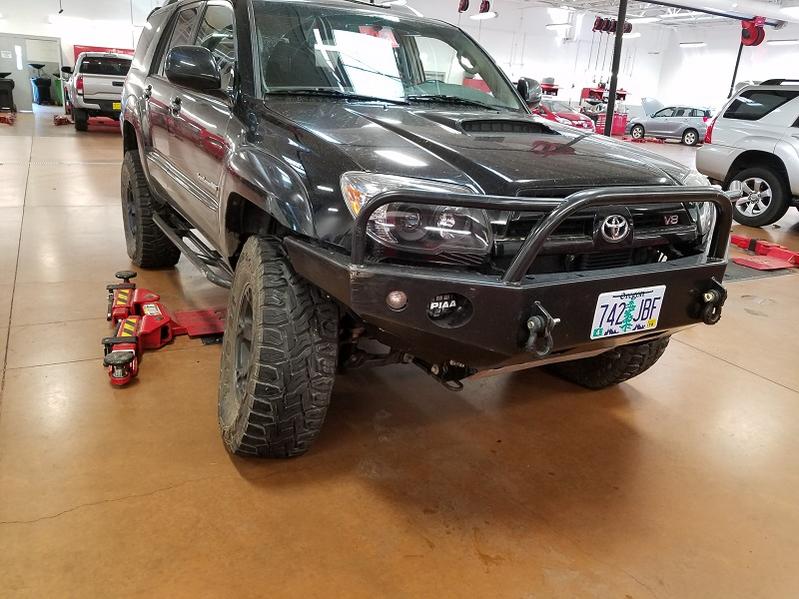

That's with the steering straight ahead.
The wheel was cambered in so badly and the caster was so screwed up on the passenger side where it took the log that the wheel was rubbing the UCA even after we pulled it all the way out on the UBJ and added a 3/4" Spacer off BackOff's 4Runner. The UBJ plate (the one with the SPC Logo) is actually worn away some from the friction and the UBJ is torn open and contaminated. The passenger side at the least needs a new UBJ, but I'm not sure if the arm is straight or not still.
In any case at this point I put an order in for the Camburg Kinetiks, They have beefier heims than the ICONs and most of the others out there and are designed to easily hit 5~5.5 degrees of Caster. Though I am a bit annoyed that for such an expensive UCA they couldn't make the heims adjustable on the vehicle.
