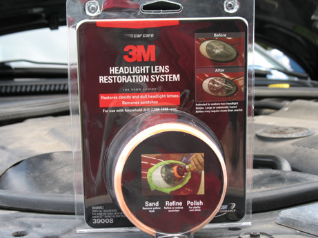

From the 3M website product sheet:
3M™ Headlight Lens Restoration System 39008
Plastic lenses can yellow with age, reducing headlight brightness, and new lenses can be expensive. The 3MTM Headlight Lens Restoration System lets you shine and restore plastic lenses, including headlights, taillights, fog and directional lights. Now you can produce professional results with the 3MTM Headlight Lens Restoration System and a household drill (1200-1600 rpm).
Formatting of the word plastic added. You might try the 3M 1-800 number--I doubt you are the first to make this mistake.
lol yeah unfortunately when we first did it he my buddy didn't have the label and when i saw the sand paper and wet sanding that was going to be involved i was skeptical for using it for glass He's a douche and thinks everything can work for everything though sw we went with it.
You do have a point, however but it doesn't say anything for glass. you think it would put some kind of warning right?? i may call them and see what they say.

got this email from 3M
Thank you for contacting 3M. We are sorry to hear of the glass lens
problems.
The lens restoration kit is specifically for plastic lens'. I have
notified marketing that a clarifying statement in the packaging may be
needed.
Polishing glass is a very challenging task. Glass scratches readily from
the harder aluminum oxide abrasive mineral but does not polish with
standard compounds. Cerium oxide is typically the final step in removing
light scratches. This mineral mechanically and chemically reacts with
glass to form a smooth surface. In order to polish glass the operator
needs to create a little heat at the interface which risks cracking and
defects or nicks in the glass. We do not recommend attempting a fix on
your lens as the time and energy would be better directed at replacing it.
If a replacement is no longer available, you might check into suppliers of
glass polishing compounds (cerium oxide) and see if it will help remove
most of the light scratches. I would not attempt to remove them all.
Regards,
Scott Femrite
3M Automotive Aftermarket Division
3M Collision Home Page
