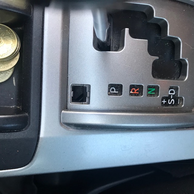

I have no idea when or where I lost the little clip in the front of the shifter, but started cleaning the interior today and felt like something was missing here. I tried looking up the part but all I could find was the entire shifter assembly.
Any help would be appreciated
pic for reference:

That is not a panel clip. What you are missing is a cosmetic plug for transmission override (if you stick a screwdriver there trans will shift in neutral without the ignition key. This used by tow service etc...).
Mine was lost when I picked up the rig brand new. I didn't know anything was missing untii 5-6 months later looking at pics on ths forum.
It cost me $4 to order it from my local dealer, looks like $1.19 online
Shift Lever Cap - Silver 33554-35110
