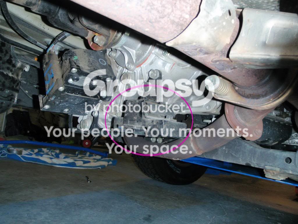

:help: I'm having trouble installing the cross member. This part is in the way.
What is this part?
Can it be removed?
P1311061copy_zps18c78bf7.jpg~original
Thanks in advance for the help.
I'll post pics when I get this finished.
Jim
That... is a thing... Its purpose, is to be there?
A more helpful edit here... Its called a Transfer Dynamic Dampener, basically a weight to help reduce vibration. You can remove it and not have anything go ka boom, maybe the driveline will vibrate a bit more? Not exactly sure how a dangling rubber weight helps dampen vibration there...
Is that dampener something that is added only to the transmissions that are found to have some intrinsic vibration ? Not sure that mine has it and if it does (if all vehicles get them) then perhaps you need to look at your mounting location for the cross member because I encountered nothing between the frame rails to impede the installation on my rig.
The issue I ran into was getting it to fit between the rails at the ends of the cross member; that involved a bit of trickery. (and grinding)
If you look at this picture, it does not appear that you should be getting any interference from the transfer case...

I really don't think it does much. I bent mine on a wheeling trip last year (it dangles really low, so it's the first thing to go) and posted up here. The consensus was that nobody really seemed to think it was an issue. I've also had no issues driving with it bent.

I have removed those dampeners but never felt good about it. What we do in the shop is remove the large bolts that hold them to the tcase, and move the whole thing up, installing it with just one bolt with thread locker on it. So lower hole in the damper gets the bolt and that gets threaded into the upper threaded hole in the tcase. Works fine and it does not seem to upset the perfect balance that Toyota designed in. :)
