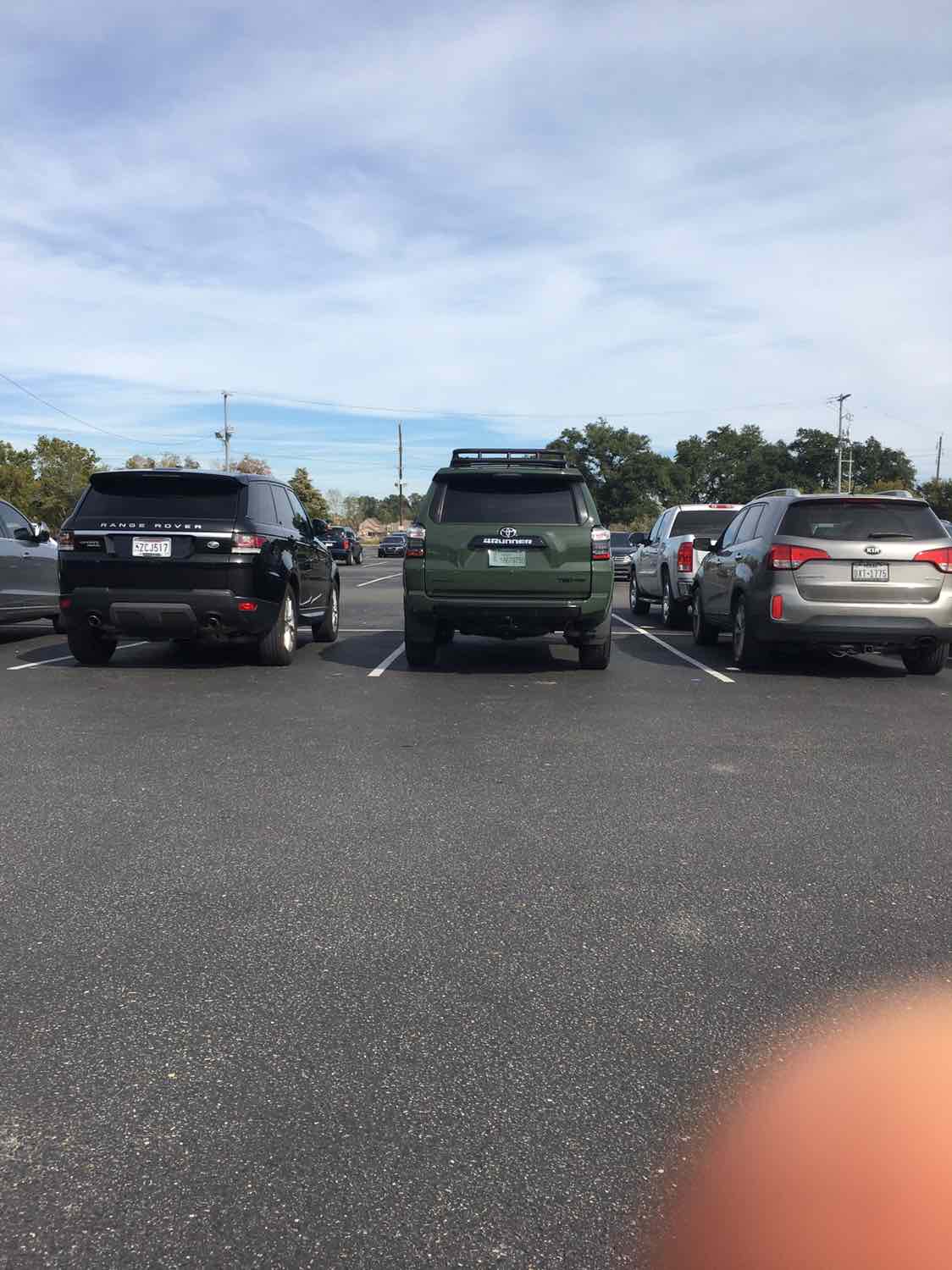

When you look at the pro from the back, it doesn’t look like it really needs a lift. Instead it looks like it sits at too narrow of a stance —something wider tired and wheel spacers would solve (although the front could use another 1/2-1”)

Here’s a pic from behind:
Pic didn’t post..... here we go:

I've noticed that tires look bigger or smaller in photos depending on a variety of factors including what angle the photo is taken at.
I photo of my vehicle directly from the side with 265/70/17 Wildpeak AT3Ws may make the tires look too small. But in person, with the wheel spacers, the stance basically looks perfect from almost all angles.
I'd just do the wheel spacers since you're kind of planning to anyway and then decide if you really want to go bigger/taller after you see it yourself.
