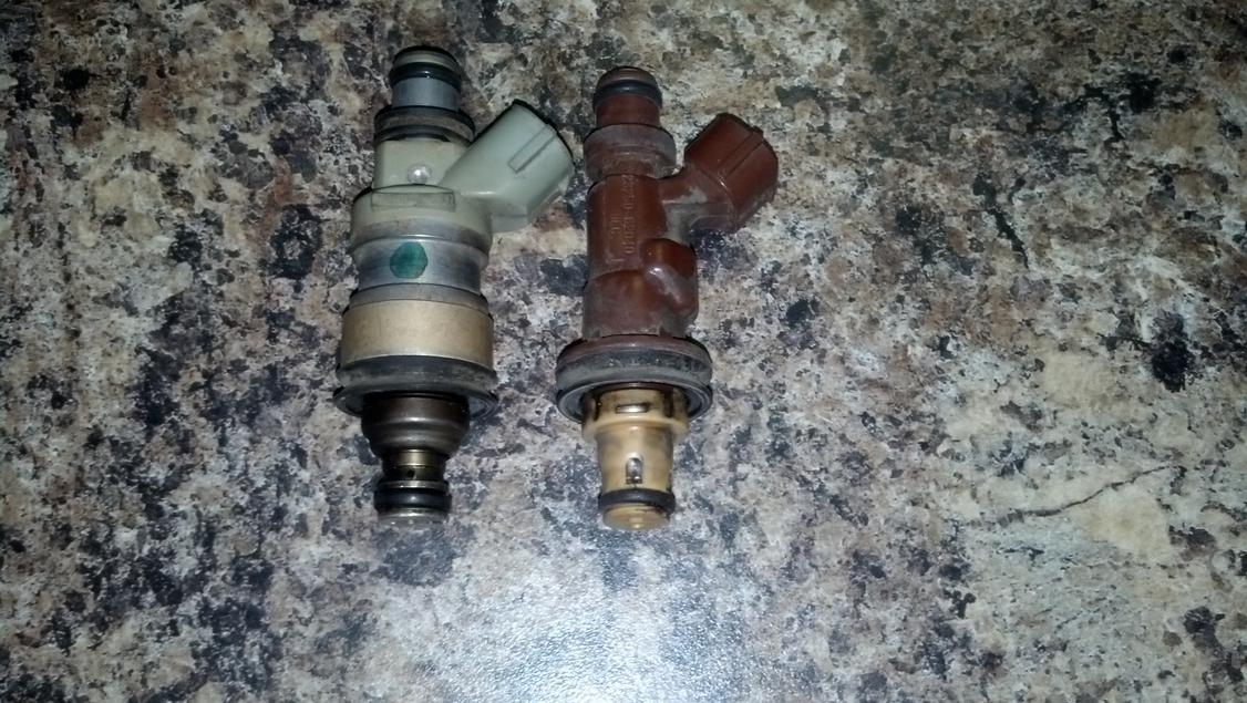

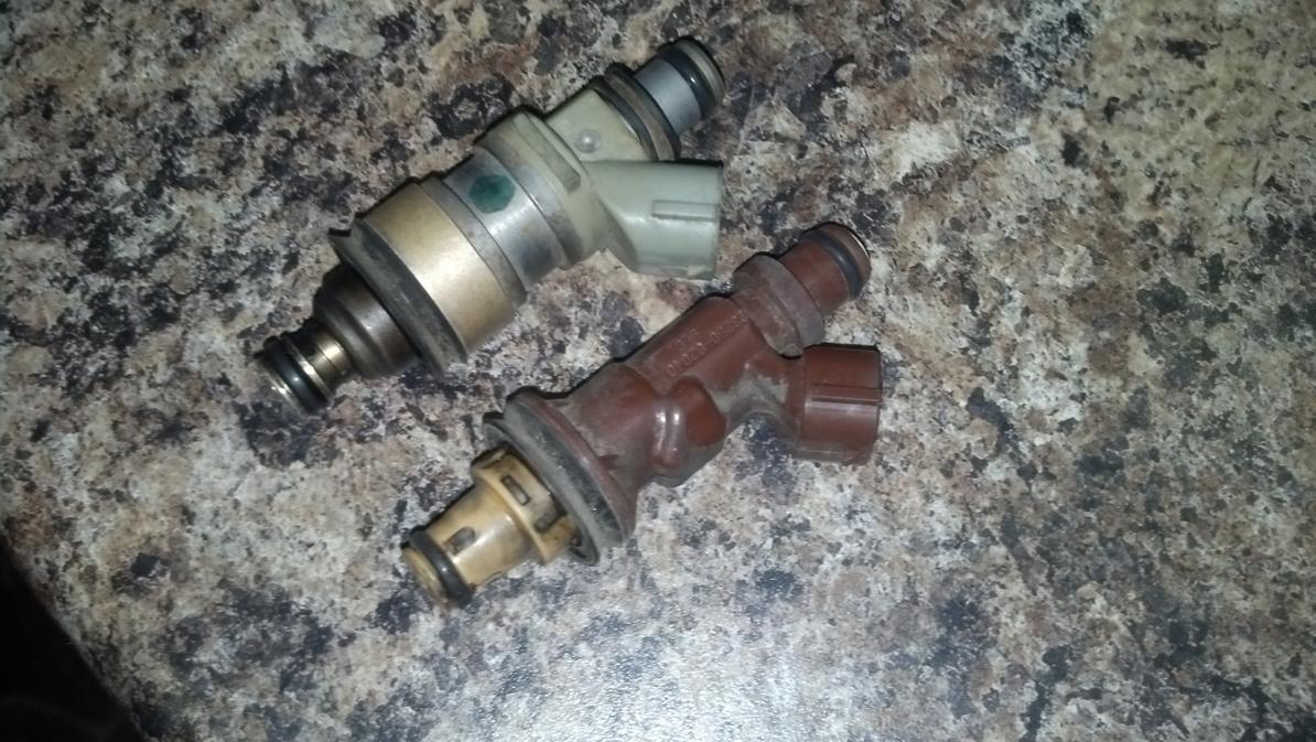

Will the injectors out of a T100(97) with a 3.4 work in a 99 4Runner with a 3.4.
All the wires match up, the length on the injector is the same also. The only real difference I see is the the gaskets which I have new ones for that issue. Take a look and educate me.
I'm just thinking will the ECU remap with more flue flowing? Will there be any major difference? I'm thinking it is still a 3.4 at the end of the day.
Lets hear it. I'm in the middle of doing this so hope I'm not going to regret it!

My best guess: a 5VZFE is a 5VZFE is a 5VZFE. I doubt there is any difference in the injectors. I doubt you will see gains though either. The engine is one of those things I pretty much leave alone in my wheeler. Someday I might have a supercharger for the snow runs. While I think it would be awesome and tons of fun, it's not high up on the list.
There are a few people who might know ..... [MENTION=10169]TheDurk[/MENTION] for example.

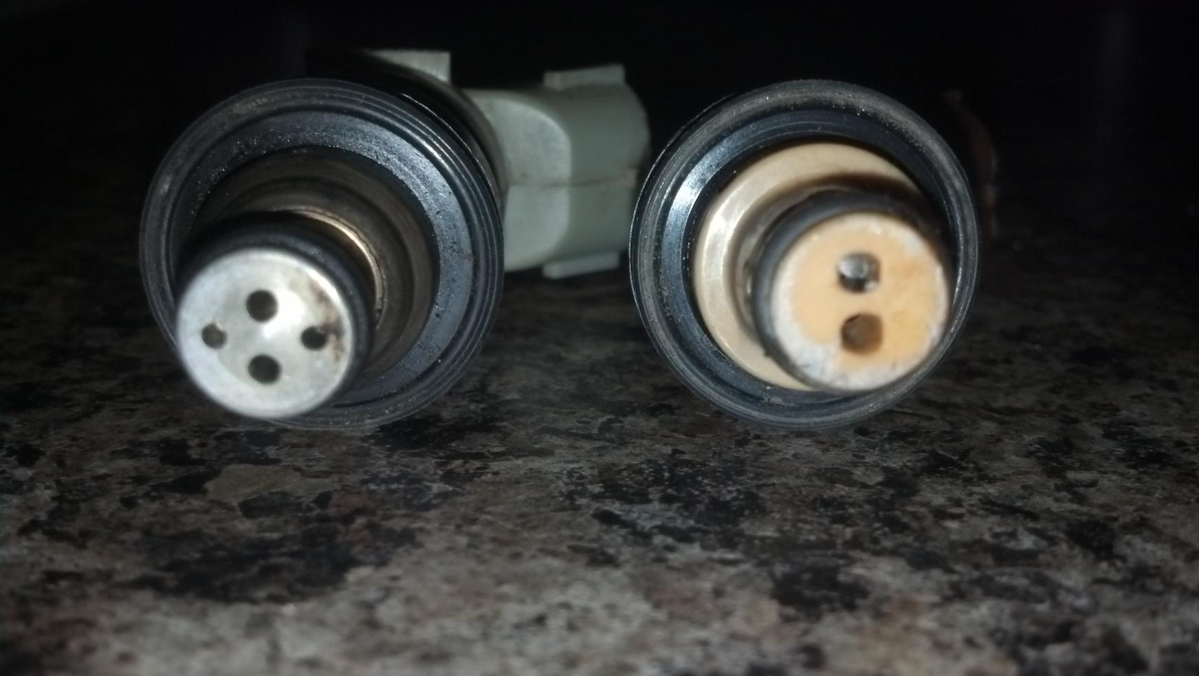

To me ... those two parts don't look the same at all. They look similar, the same way that spark plugs can look similar but there are visible differences. For example one has 2 holes at the end and the other has 4.

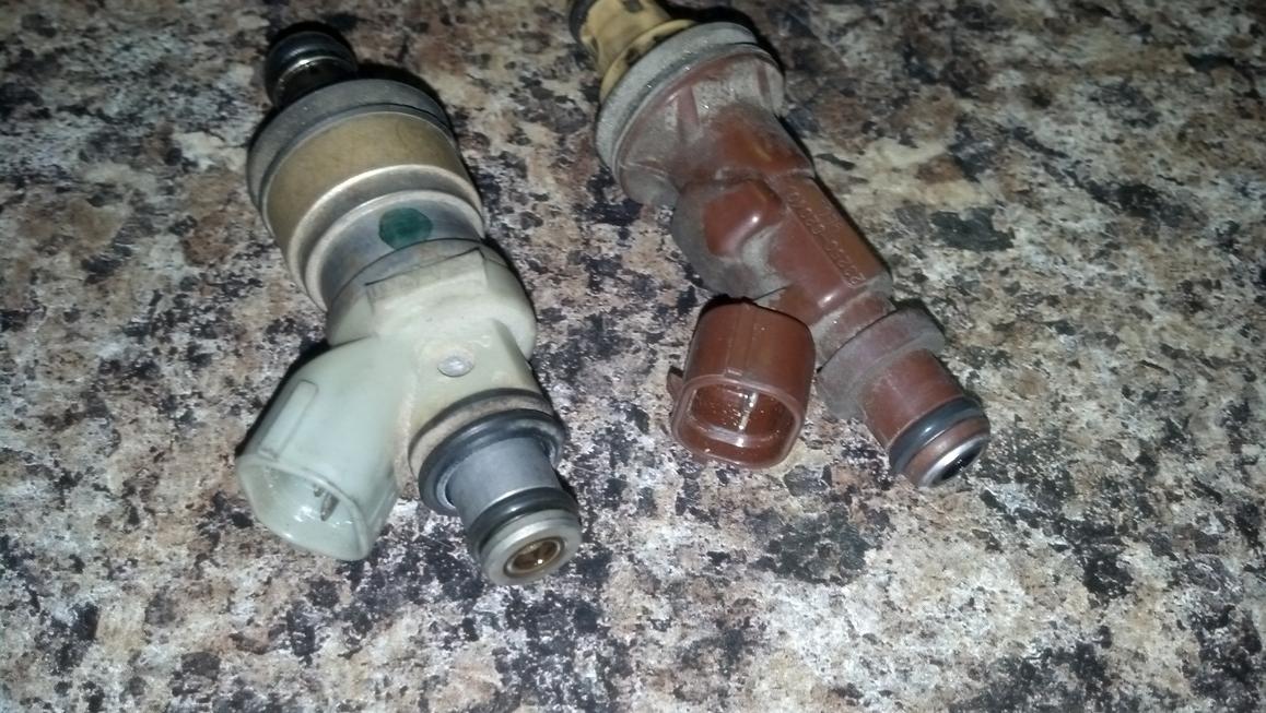

From my experience, they will NOT.
The connectors are different.
You need 99-00 injectors.
I say this, because when I didn't my 4WD conversion, my harness was ripped apart. I got a harness from a 98 limited. The harness didn't connect to the injectors.
Now, this is a Runner, not a T100. So don't quote me.
There's also different specs for the injectors. Best bet is to just go with the '99 limited injectors.
i checked the harness and they connect and fit. now the plastic tip is just that, i broke one and looked at the other. they are the same other than one has two holes and the other sprays a little different. I'll keep you posted on this all. Either way I'm driving it in the morning to work so it will run one way or another.

Rockauto has the same part numbers for fuel injectors for a '96 4Runner and a '95 T100.
After looking at them really close the only real difference I could see was Toyota went to an all plastic injector at some point ( I broke one of the tips off in the injector post because they were corroded so bad, fing plastic). The ones I put in were still medal. All the important things were all in the same place. I know because I got out a set of calipers and took measurement off both of them,lol. The only thing that threw that off was the gaskets thickness.
From the Rock Auto site, it looks like Toyota changed the injector style in 99 on the 3.4 (both 4Runner and T100 show the larger style for pre-99). If they flow differently the ECM would learn the values for normal driving, but it might be rich or lean at WOT. My guess is that Toyota switched suppliers in 99 or some new regulation went into effect that they couldn't meet with the older model.
