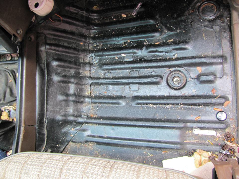

I used spray on bed liner and did mine myself. My 4runner was a mess when I got it. Moldy carpets and rear seat. Now they are all gone!!
I left that matting on the floor and a year and a half later it is still perfectly fine. Spray at home bed liner requires prep work and the sanding is Critical to good adheasion!! If you don't sand the surface very well, the stuff WILL flake off, but I took the time and beer to do it right with green scrubby pads and I have had great success with it! I have a softopper that stays open in all seasons but winter, so it gets used and abused as much as possible.
Others may not advise using it, but for less than $100 total, I am very happy.
