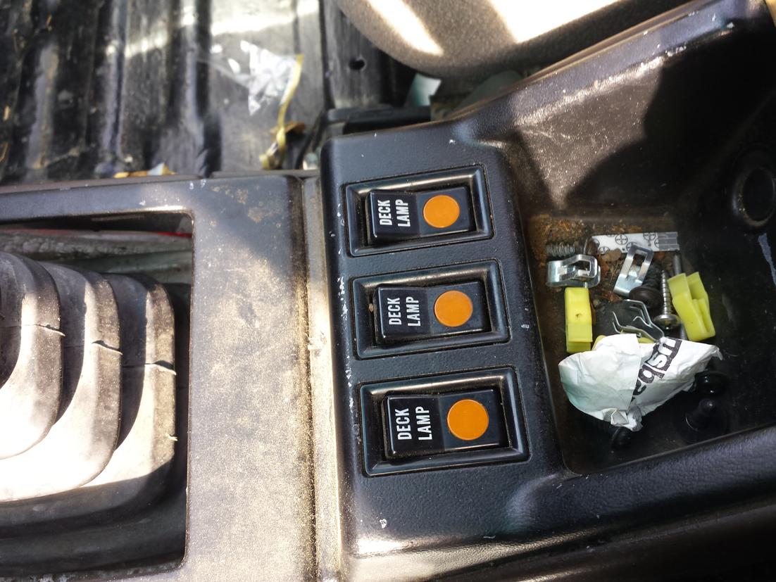

does anybody know what size switches these are? trying to buy a dpdt rocker window switch because all the wiring to the rear window was stripped out. also would like to know the best way to wire and if you could post a link to the switch pls ty
Those are standard size Toyota Switches.
Window Lock is plain old single-pole single-throw.
Window Up/Down is Momentary single-pole, double-throw with center-off.
The wiper switch, I believe is a little more complex. Might need to find one from junkyard or buy replacement from online stores (try Toyota Parts Zone and Rock Auto)
