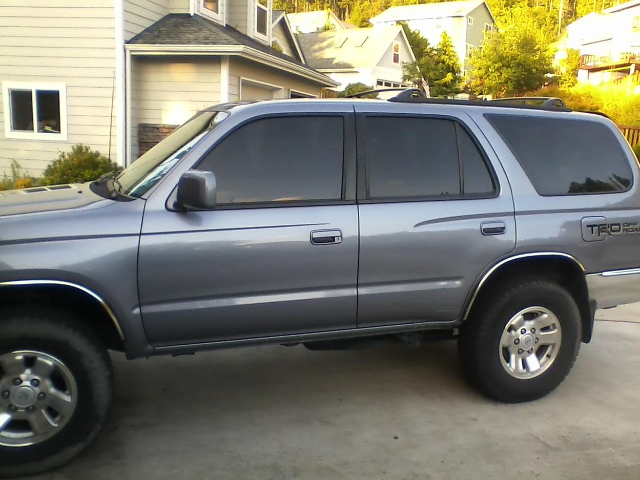

so i'm new to the forum and i got a 98 4runner that's going to need tires in a month or so and i figured i would just lift her and put some decent rubber on her while i'm at it and do it right but i'm not sure if i want to do the tundra wheels and just spray them gunmetal like everybody else. do you think it would look good with the color i got?
another problem i got is i cant decide if i want to go with 285/65/17 bfgoodrich all terrains or some km2's. i do a fair amount of driving and i was leaning towards the all terrains but the km2's just look soooo damn good!
if the picture loads this is how she sits currently.
any pics or opinions would be much appreciated thanks!

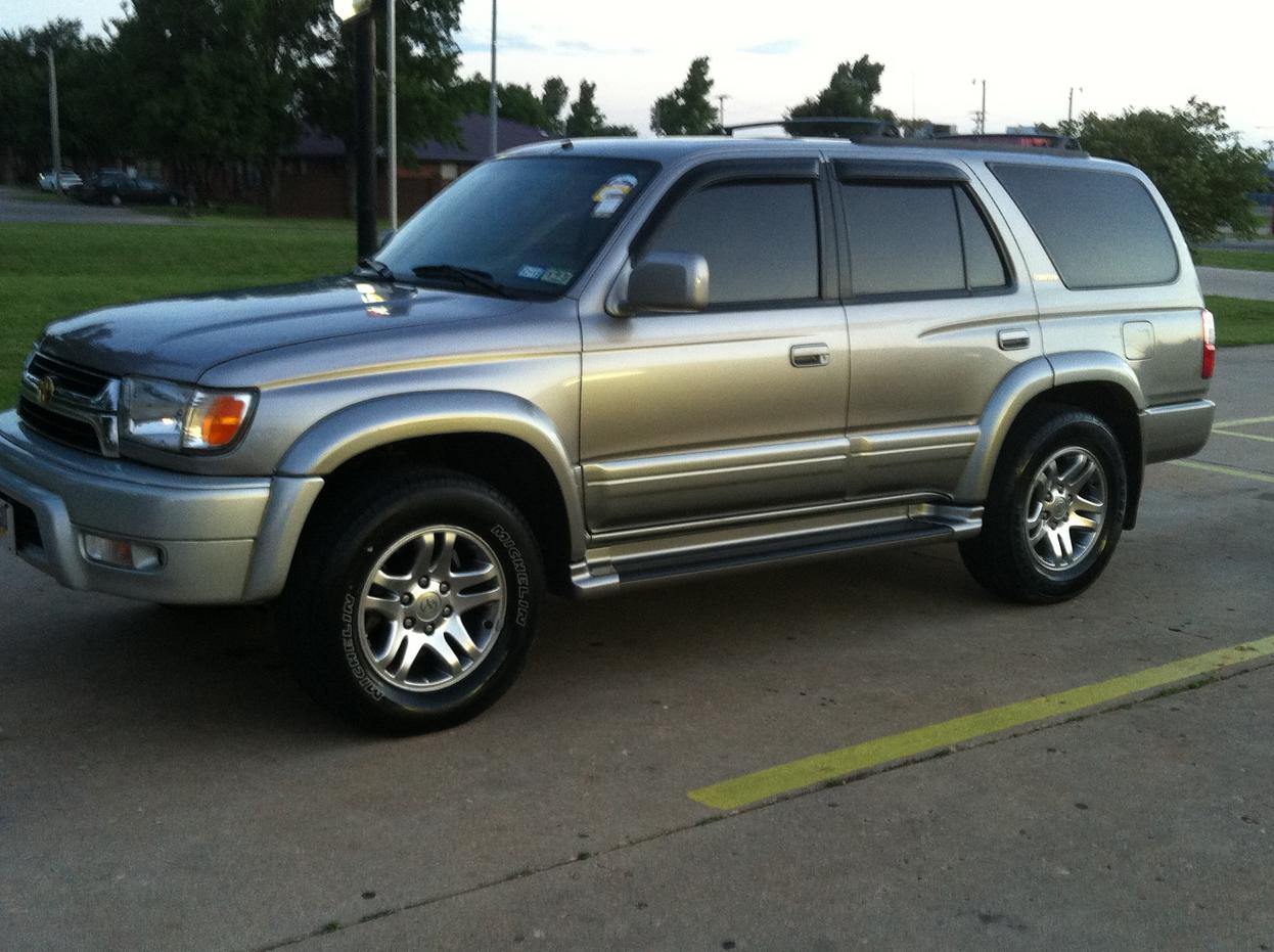

Not quite the same color, but just to give you an idea. I think I paid $225 for my rims with a set of tires that I got another 25k out of. I even got $125 for my stockers! It looks even better now since I added the 265/70/17 BF Goodrich AT's!

those wheels look real good on that rig, i gotta find some soon. I've been checking craigslist daily but nothin! ive also been looking into getting some procomps or something with the same style as the 8069's

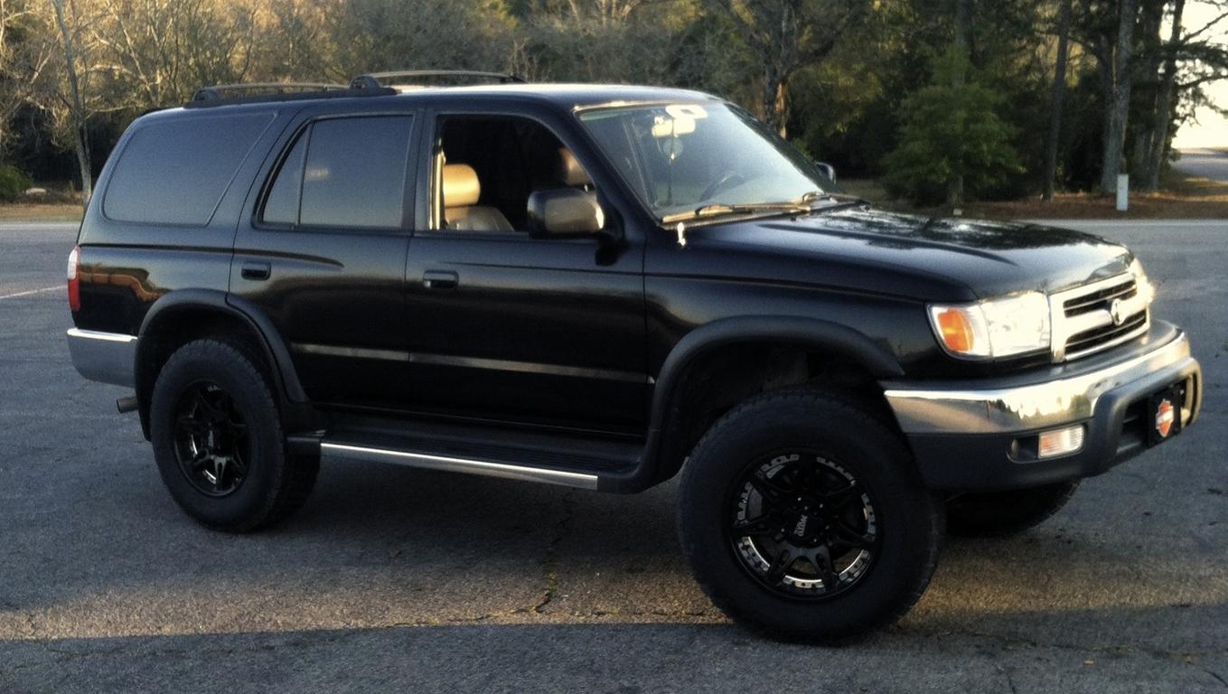

mine is a 2000 and i have a 2.5 daystar spacer lift on front and back with 265/70/18 nitto terra grapplers, and 18' moto metal 961's

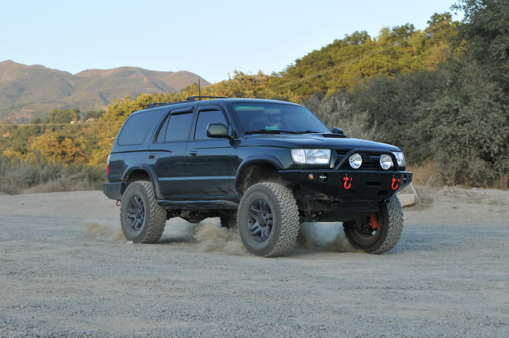

The Toytec 3" lift is the best. I went with 891s in the back for hauling my dirtbike and because I figure the stiffer springs may extend their life.. For wheels and tires I can tell you the KM2's are going to be louder and wear quicker than the AT KO's.. I put the FJ 6spoke wheels on mine also because they look beefy as hell and left enough room to comfortably put the 231mm Tundra rotors behind them.. Picked up the FJ rims for 300 on craigslist, sold my stock ones for 250.. the tires ran about 1200 for 285/70r17 new.. BTW always buy new tires, I work in a tireshop and used tires are almost always messed up oone way or another. Also make sure you get the 1" diff Drop and an alignment as soon as everything is installed. Hope my .02 helps.
