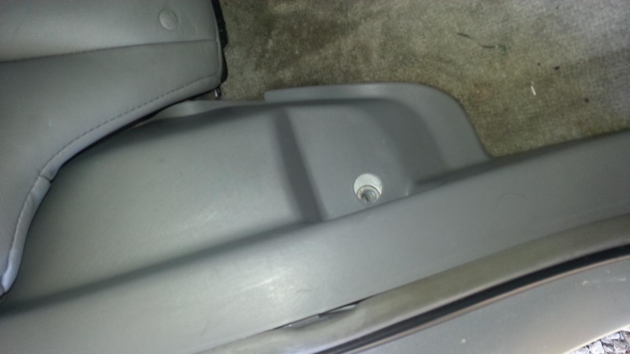

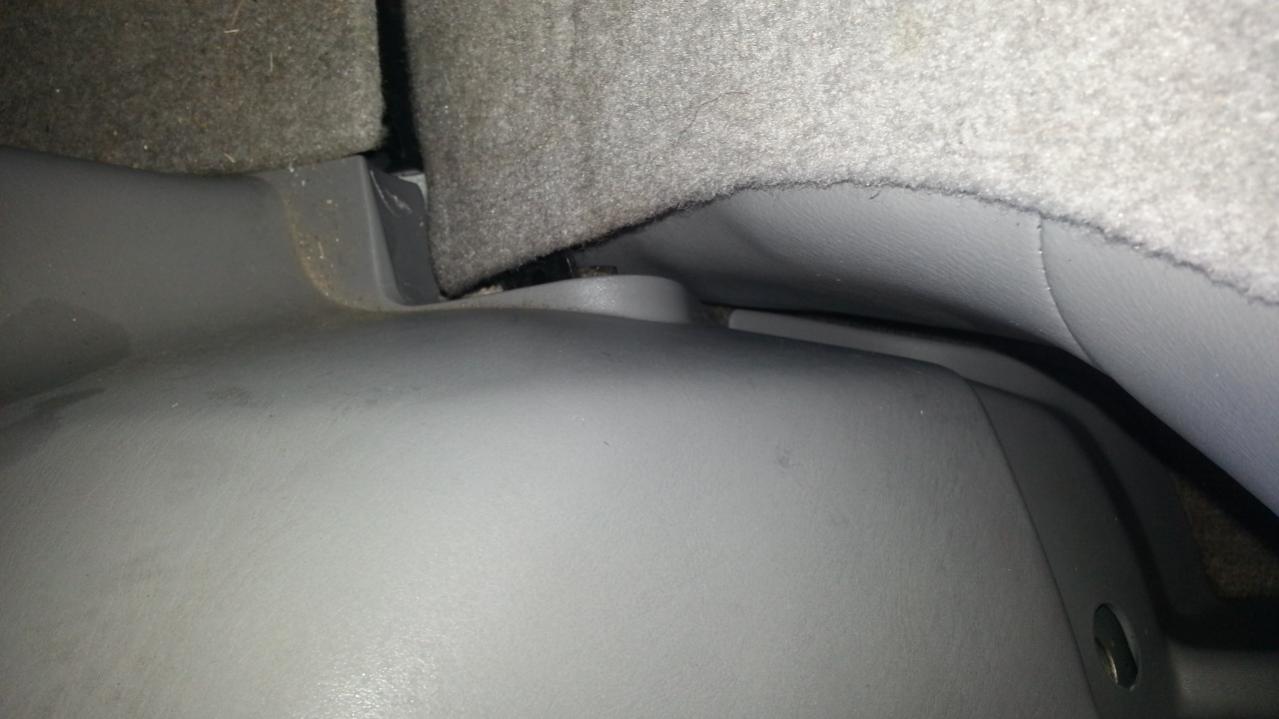

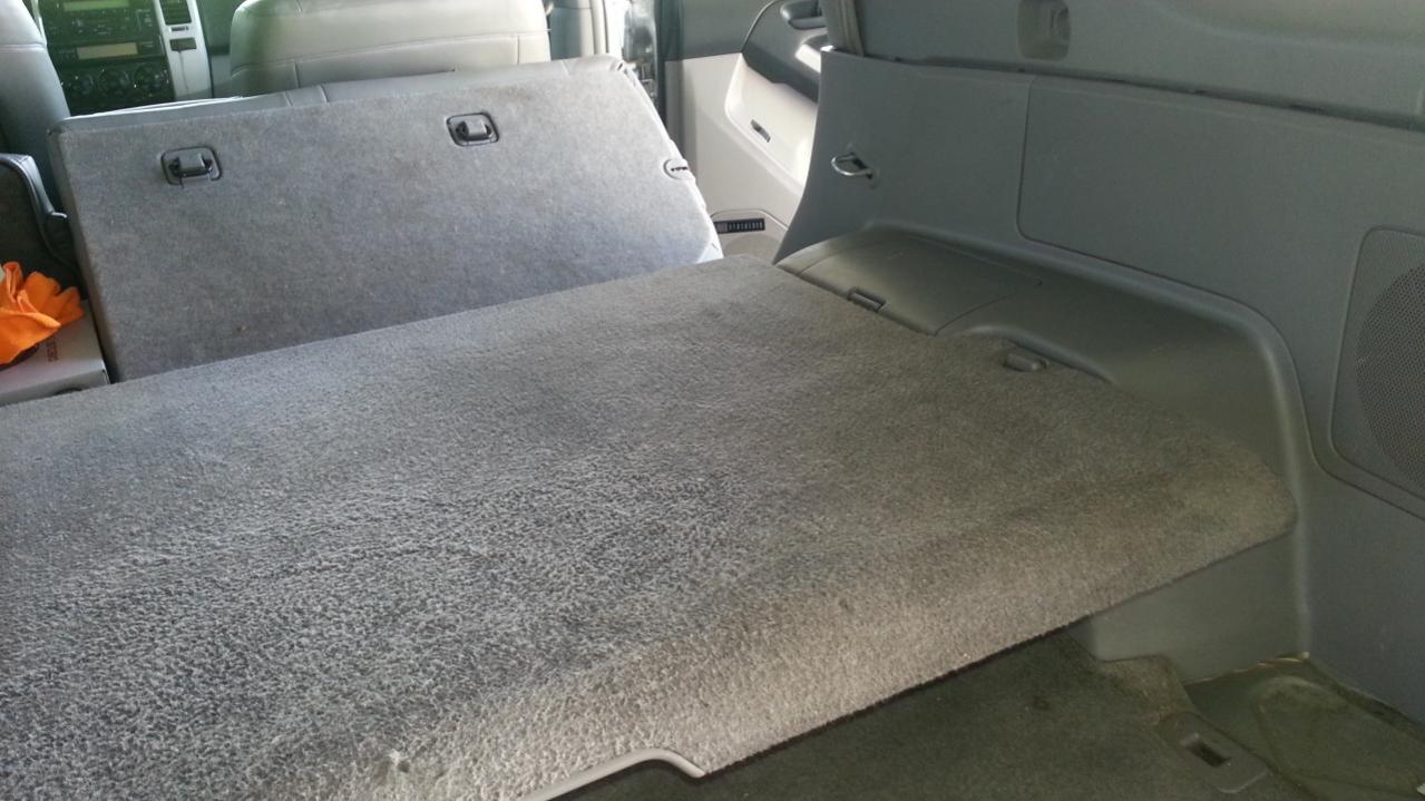

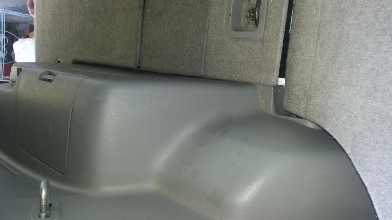

Ok i have a 2005 Toyota 4Runner Limited and am replacing the jbl sub. I followed a write up on here and removed all screws but cant get the side door panel up and away what am i needing to do that wasnt in write up based on the pictures i am enclosing. anyone that could shed some light so i can finally install my new sub would be greatly appreciated.
In the pics i have the double decker cargo shelf on and tried sliding it down. Was i. Supposed to remove it all together. I feel like the seat is also stopping that end of panel from coming out

When I did my sub, my seats and shelf were already out, so the job seemed easier than the write-ups had made it out to be. So yes, maybe remove them? Neither are difficult to remove, but they do add to the project.
go to remove the 2 bolts that hold the double deck tray.
follow the guide for the rear cargo removal for stereo installs.
I literally did this yesterday. Fold the cargo deck all the way flat, remove the long piece closest to the back seat first, it's 2 10mm bolts held inside the plastic pieces with the rings.
Then with the cargo tray flat, there are 2 more 10mm bolts holding this part to the frame.
Hope this helps!

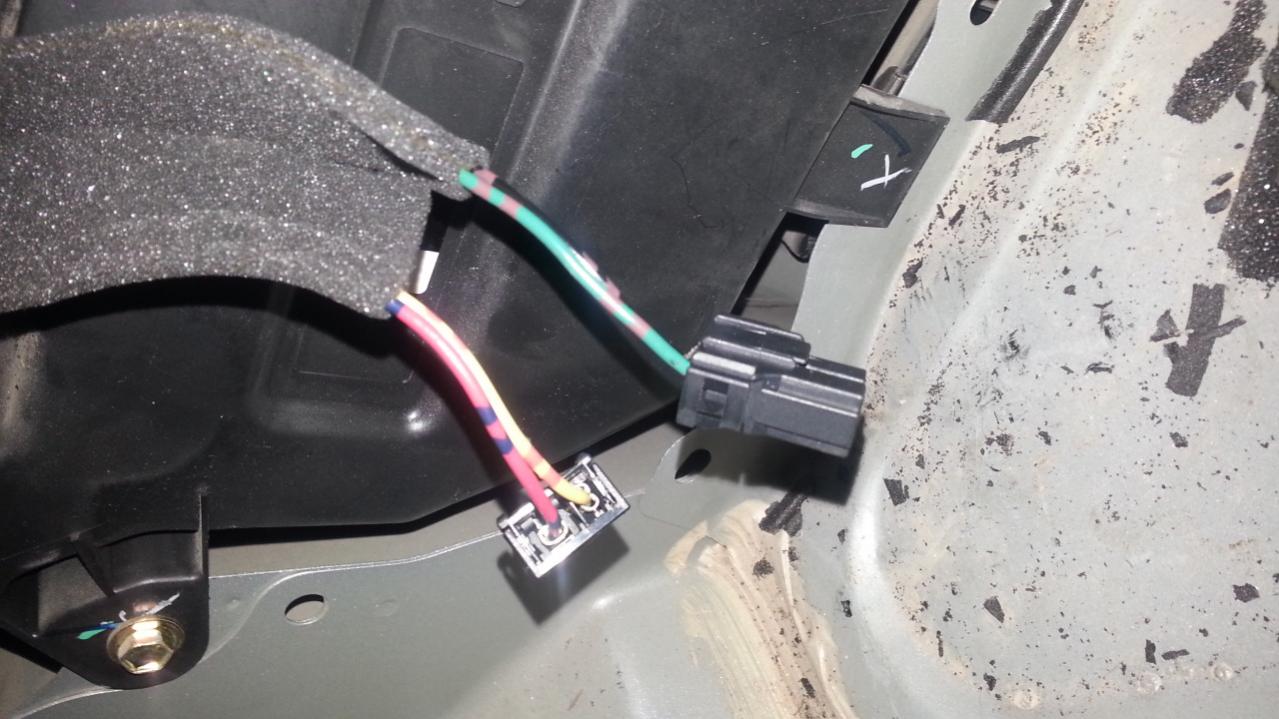

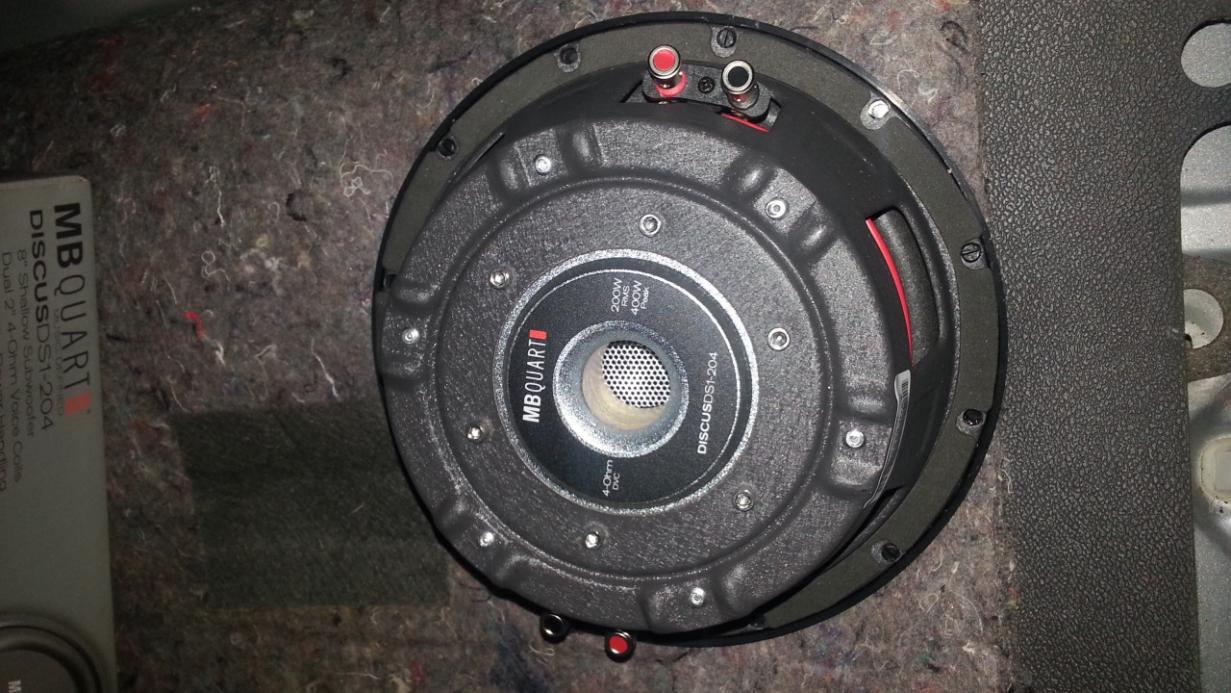

This is a pic of the wires that went to old subwoofer which i have now cut the black clips off and ready to be installed on this new sub with this kind of connect on each side. Please advise as to which wires go in which connect slots please and thank u all so much

your speaker
Red wire to red connector........Yellow wire to black connector
Black wire to Red connector.......Green wire to Black connector

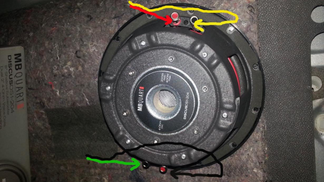

On the speaker, the spring loaded button with a red top denotes positive, the black button denotes negative. Do NOT think match colors. The sub woofer actually has 2 speakers, red and yellow go on one side......black and green go on the other side.
Just remember you will have a reduced output as the speaker you chose was 4 ohm.
