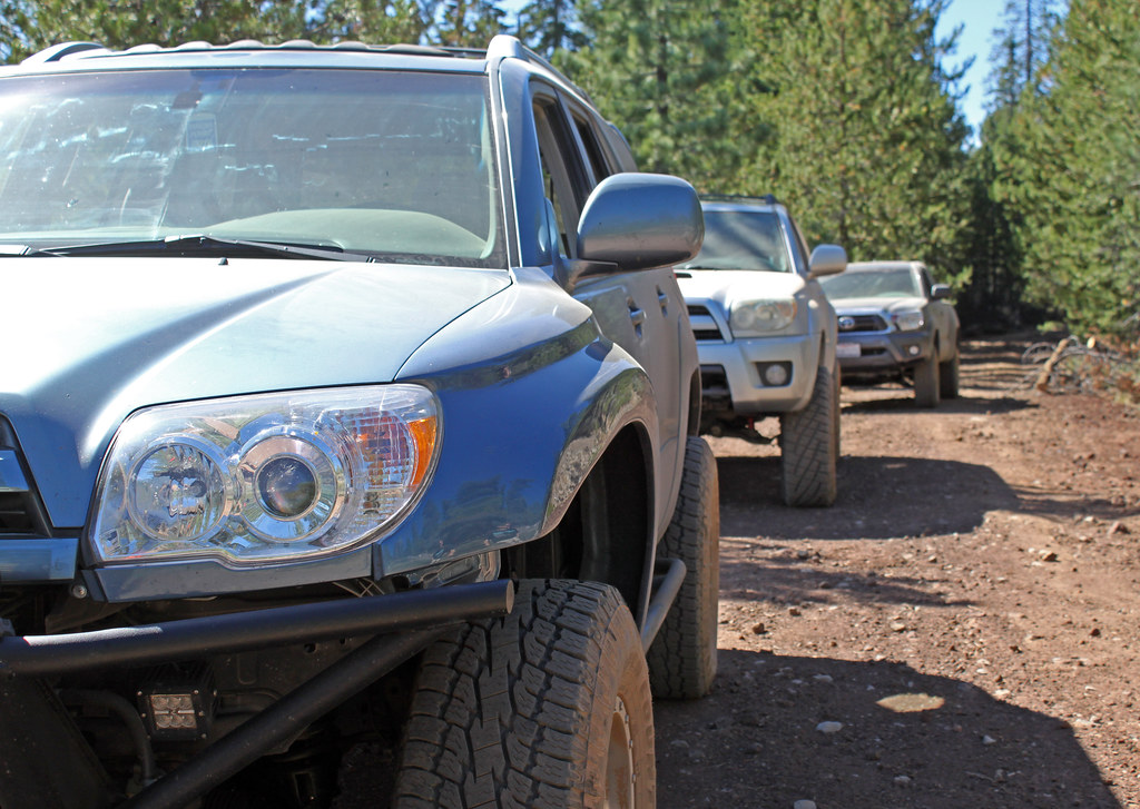

I mounted mine in existing holes on the radiator skirt. I would assume you want to mount in the stock location?
I bought the bulb connection and wired the pods to that, so i could plug and play and use the original wiring as well as the OEM fog switch. Works great and has been a worthwhile mod.
I did the same as LTDSC...I bought the connections at a local Harley Davidson dealership for about $16 and wired in using the existing fog-light harness. I'm rocking an aftermarket bumper so it was easy to mount...I'm assuming you will need to bend some metal to make your mounts work in the existing fog-light slots...or do what Billynath1988 did and notch the lower valance grill and insert there...?
