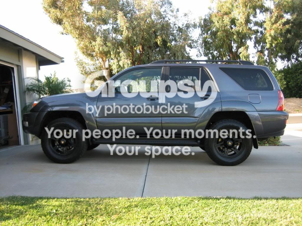

Just to give you an idea of the look, here is the Bilstein 5100 set at 1.75 inch lift front, stock rear. It only gave me about 1.25 inches of actual lift. It looks good with stock diameter tires. I started with the same rake measurements you did. I now have a 1.25 inch difference front to back.
IMG_0194.jpg~original

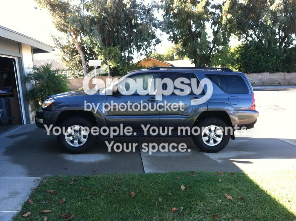

Here is it with 1 inch taller tires
IMG_2183.jpg~original
Yeah, that looks good to me. I think i will go with the toytec. I never got an answer from Daystar if their lift was 1" or 2". But the pics of the budget lift components look thicker, so I was thinking the poly bushing is 1" creating a 2" lift, and that would be too much.

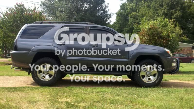

I have a 1" block on mine and it's actually about 2" lift (nothing in back) and the running boards are within 1/8" up front and still just a hare lower in the front than the rear at the fenders

That makes me wonder if the running boards are adjustable. Mine definitely only have 1" difference stock.
You also have to remember that if you're sitting within 1/2" of level on the running boards, are you really going to see that? You're usually looking from an angle from above and really won't see any difference unless it's pretty big.
Another thing to consider is that when you lift the front, the running boards won't raise up quite as much as you lift. If you lift the front 1.5", the front part of the running board may only raise 1". Those aren't even close numbers, but gives you an idea.
