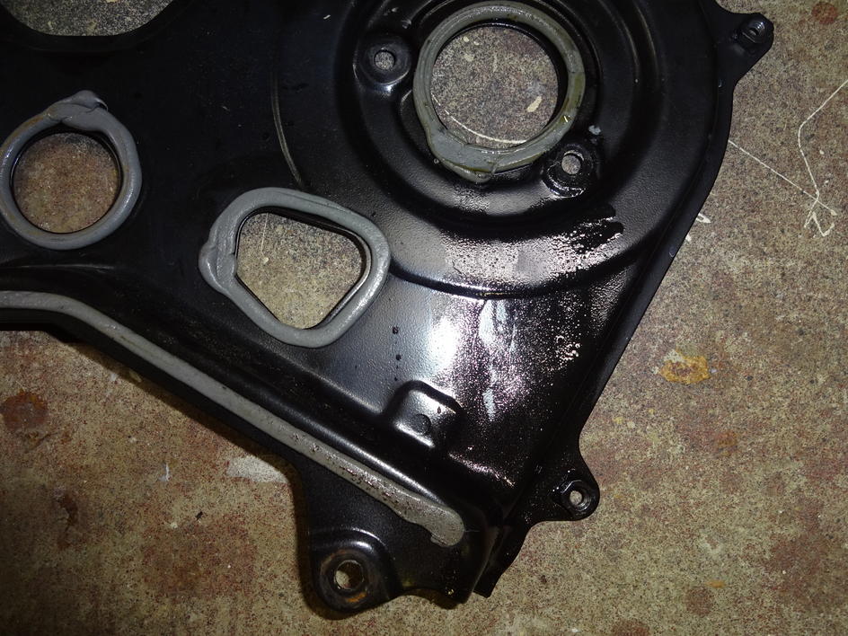

Back of the upper rear timing belt cover. Proof positive of where the leak was.
If only I had been able to see that while it was installed, I could have saved 7+ pages of forum threads. :becky: And kept my blood pressure normal. And not pulled so many of my thinning hairs out. And not thumped my head against a brick wall (but I am still doing that, pissed at myself for not being meticulous enough). I screwed up. This isn't the first timing belt job I have re-done. Or the second. But this very well may be the last timing belt job I ever do. My wife's uncle offered to pay me $300 in labor to do his Honda Pilot timing belt. I said I was sorry, but I am burned out on timing belts, and don't want to screw up someone else's.

Update (hopefully my final one on this leak):
With over 40 miles on it since replacing the passenger side camshaft seal, the leak appears to be gone. Everything is as dry as a bone. In the back of my mind, I think I knew that was the problem all along, but I kept hanging onto hope that it was some other simple thing that was easily repaired.
During the initial timing belt replacement, that seal had gotten "rolled", and since it was on the bottom of the shaft, I didn't notice it. Lesson (a very painful one) learned to check everything 2 or 3 times, very thoroughly, before putting things back together.

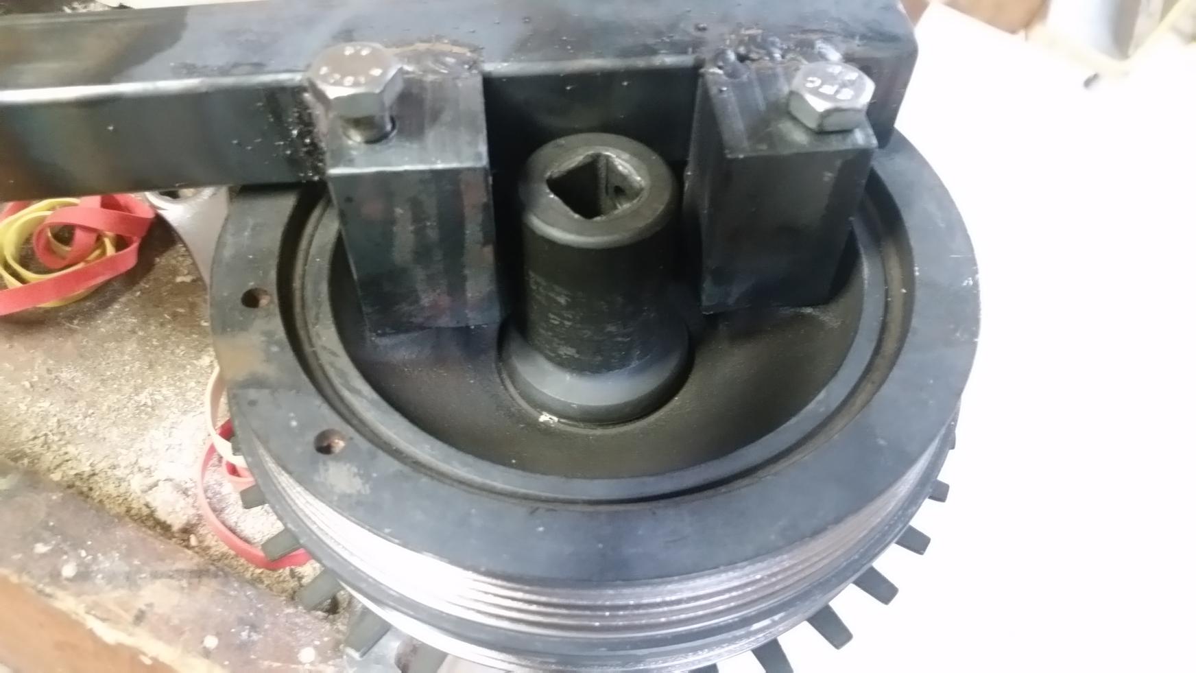

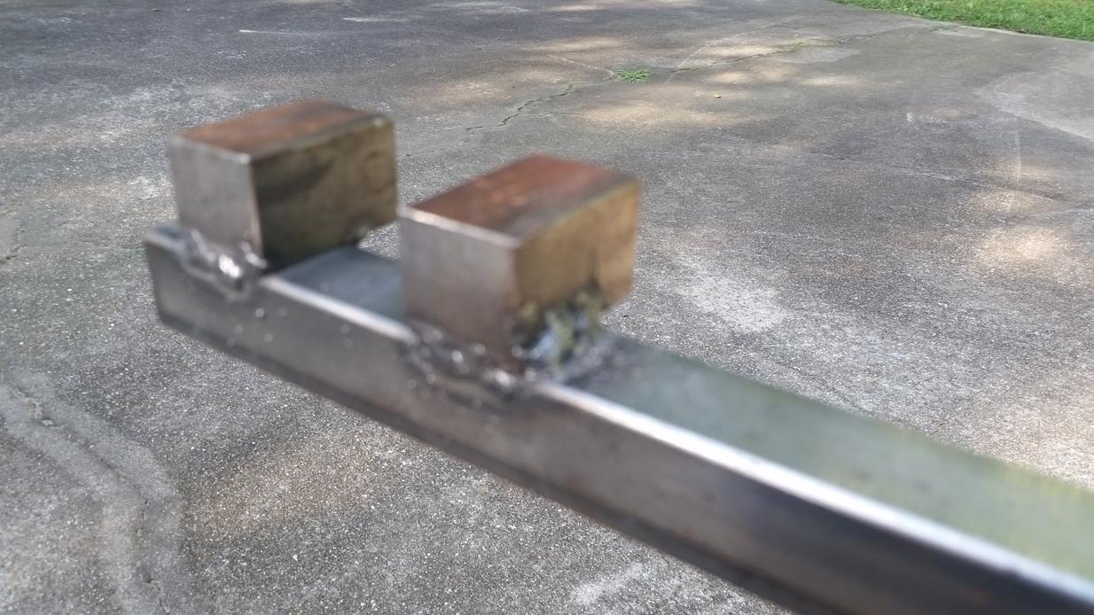

I had made a crankshaft pulley holding tool for my daughter's Protege5 when I did her timing belt a couple of months ago. Luck was on my side, and that tool happened to fit my T4R crank pulley perfectly, so I was able to re-use it. That made torquing the crank bolt possible. I was also able to use it to hold the camshaft pulleys while I torqued them (by wedging my welded blocks into the cam pulley spokes). I think I will keep this tool as long as I own vehicles, as I imagine it will work on many types. I had some steel bar stock and 1" square tubing in my shop. For reference, the bolt holes are 75mm apart, and I used 3/8-16 Grade 8 bolts (not as likely to bend). They happen to fit nicely inside the holes in the pulley, and since they don't actually thread in, they just act as pins. Here are some pictures of it, and that is a Protege5 crank pulley.

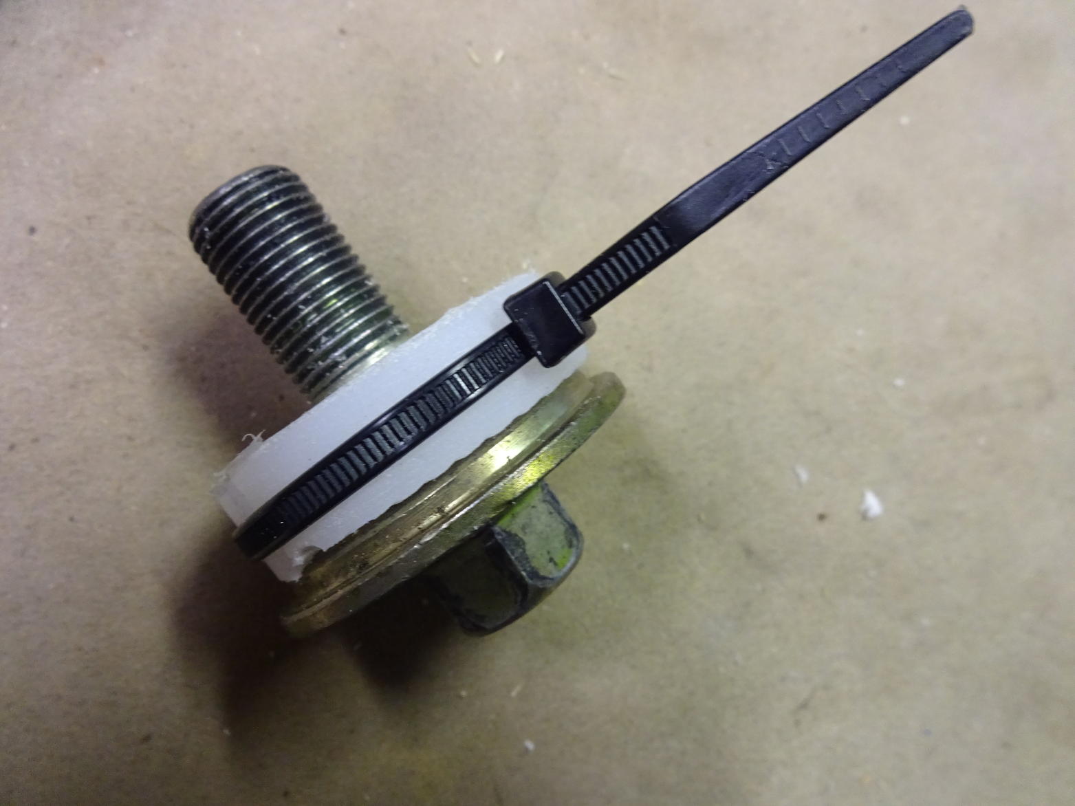

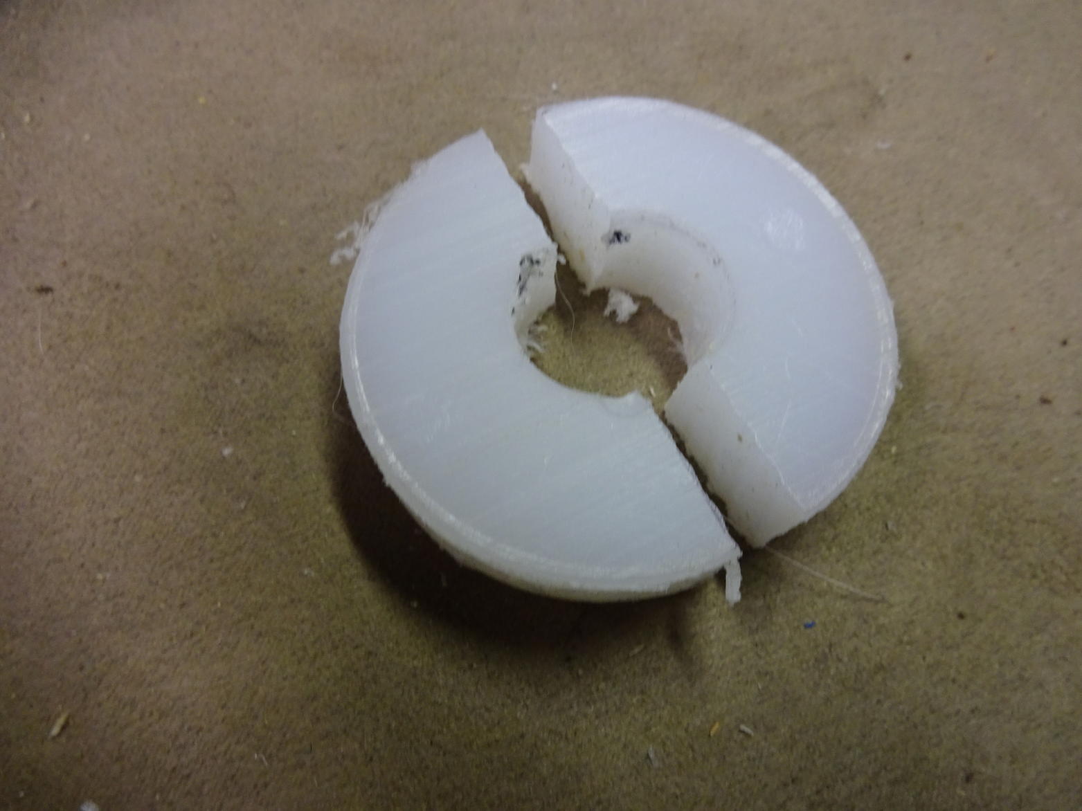

Another little tool I fashioned made the job easier too. Ever remove the crank pulley, then re-install the bolt so you can rotate the crank and time the engine, then when you need to remove the bolt, the crank rotates backward and you lose everything? You can get around this by using a strap wrench. Or you can make one of these and the job becomes simple, easy and precise. I had some Delrin in my shop. I made it into a thick, split washer. If the crankshaft bolt is stuck in the shaft by friction, just cut the zip tie and pop the washer out with a screwdriver, and the crank never rotates. A metal hose clamp could be used instead of a zip tie. I chamfered the inside of the hole where the fillet is on the crankshaft bolt.
