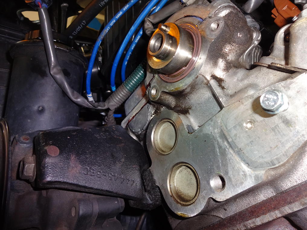

How are you installing the seals? I install them and use a correct diameter piece of pipe or PCV pipe to drive them in until they bottom out.
They go in deeper than flush.
If I don't have something the correct size I tap it in evenly with a punch and small hammer.
I install them the same way, making sure they are even with the surface (not cocked), and at the same depth as the ones I removed, which was in this case, flush with the surface next to it. Maybe I should drive them in until they bottom out. But I don't like experimenting, when this much work is involved. I try to stay to the knowns.
I would just remove the cam cap. Way easier and you don't have to pull out anything or hammer anything in.
Yep. Then I wouldn't nick the shaft, like I did on the driver side. I filled the nick with JBWeld, and sanded it down smooth and flush with the shaft. Funny how it's likely the opposite side leaking now.

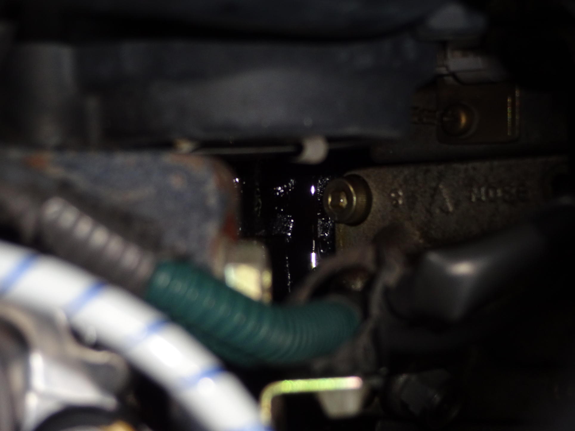

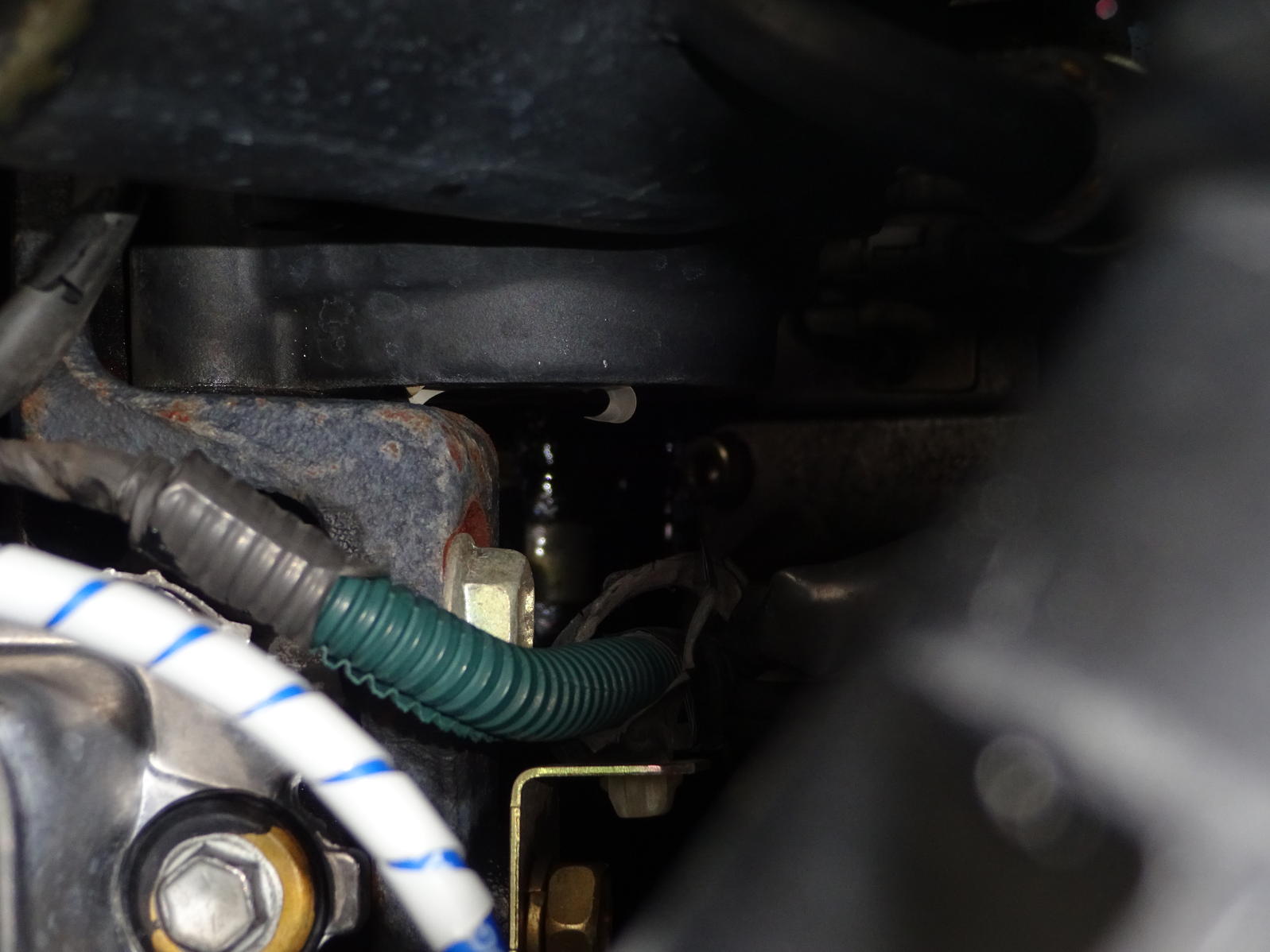

I am posting more pictures of the leak. This is fresh oil. Outside in the sunlight, with a flashlight on it, I could actually see a small drip right in the center of the pictures below. That just so happens to be right below the passenger side camshaft seal. I will remove everything on the front of the engine after it cools, and replace at least that seal. I will look very closely at the other two shaft seals, and replace them too, if there is any sign of leakage. If there isn't any sign of leakage, I am definitely not screwing with them.
In a situation like this, we often can only go with our best guess, as few things are definite, and things are very, very often not what they appear to be. It takes a lot of studying to see enough clues to find the root cause.

Maybe take a closer look at the front semi circular or half moon plug.
Congrats! At least be happy that you found one of the two problems, with this one probably being more serious. Like I said vacuum problems can lead to nightmares.
Yep. While doing the rear seals and plugs, it didn't occur to me to do the front ones, until I had already installed one valve cover. I did the remaining half moon, on the passenger side. I will do the other one when I take all of this apart again.

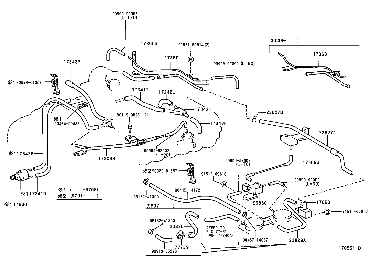

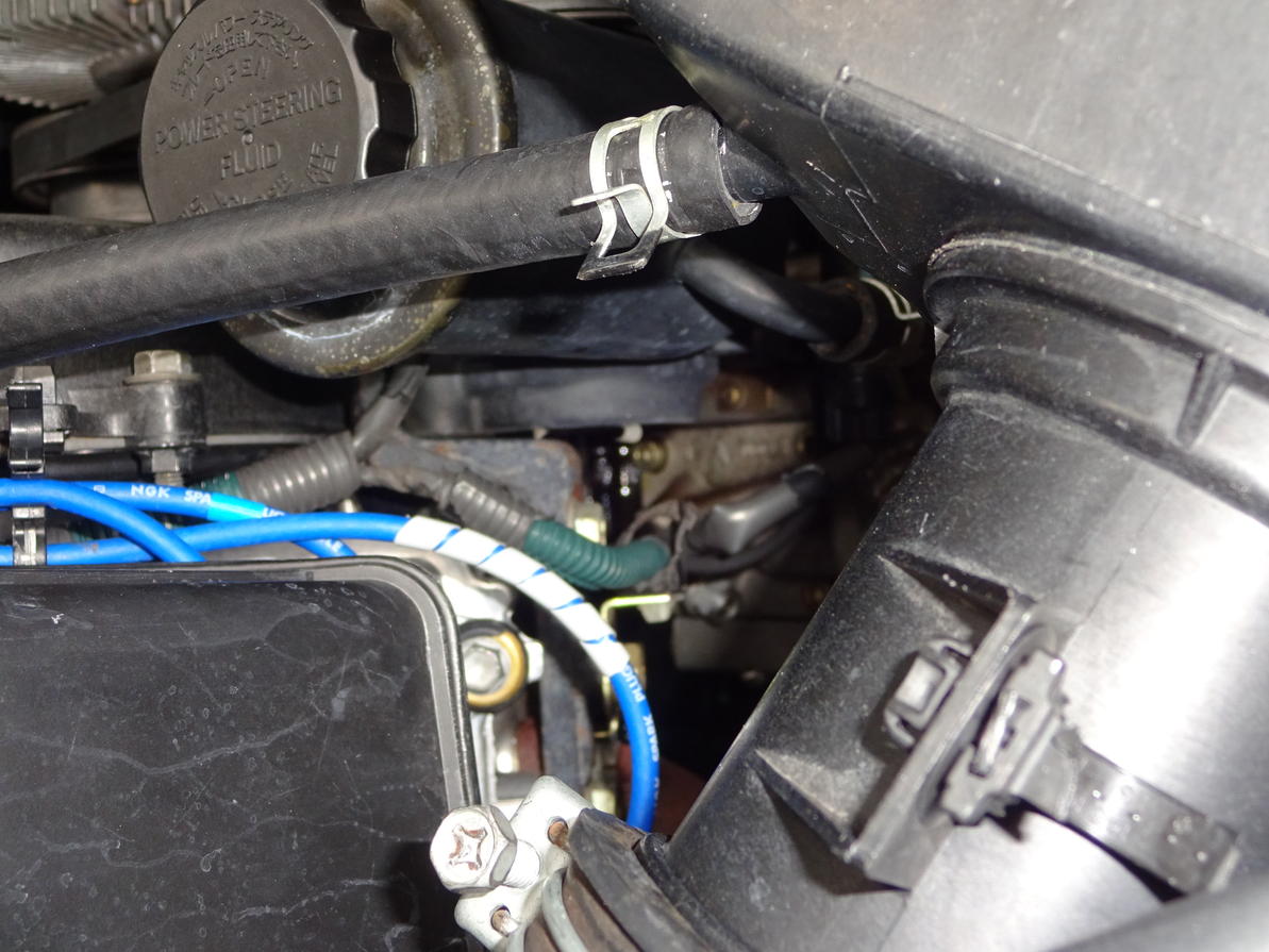

The hose to the fuel pressure regulator is not a vacuum hose like it is on other vehicles. Follow it. It should go to air filter housing.
I followed it its entire 3" length. If that is the case, then my 3" long hose that has been there for at least 10 years should have been a couple of feet longer. The hose I was talking about goes from a fitting on the back of the intake manifold to a valve immediately behind and below it. See my picture in post #77.
That 3" hose goes to a piece of metal tubing that goes between the two upper manifold sections and comes out and a hose goes from there to the air filter housing
Here's a breakdown
Now I see what you were saying - thanks. When I found it, I was on a step stool, leaned over as far as I could, with the hood latch trying to rupture my stomach. I wasn't able to study where it went at the time, and it appeared to run right into the manifold.

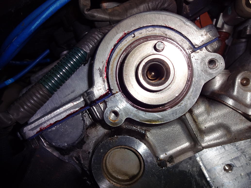

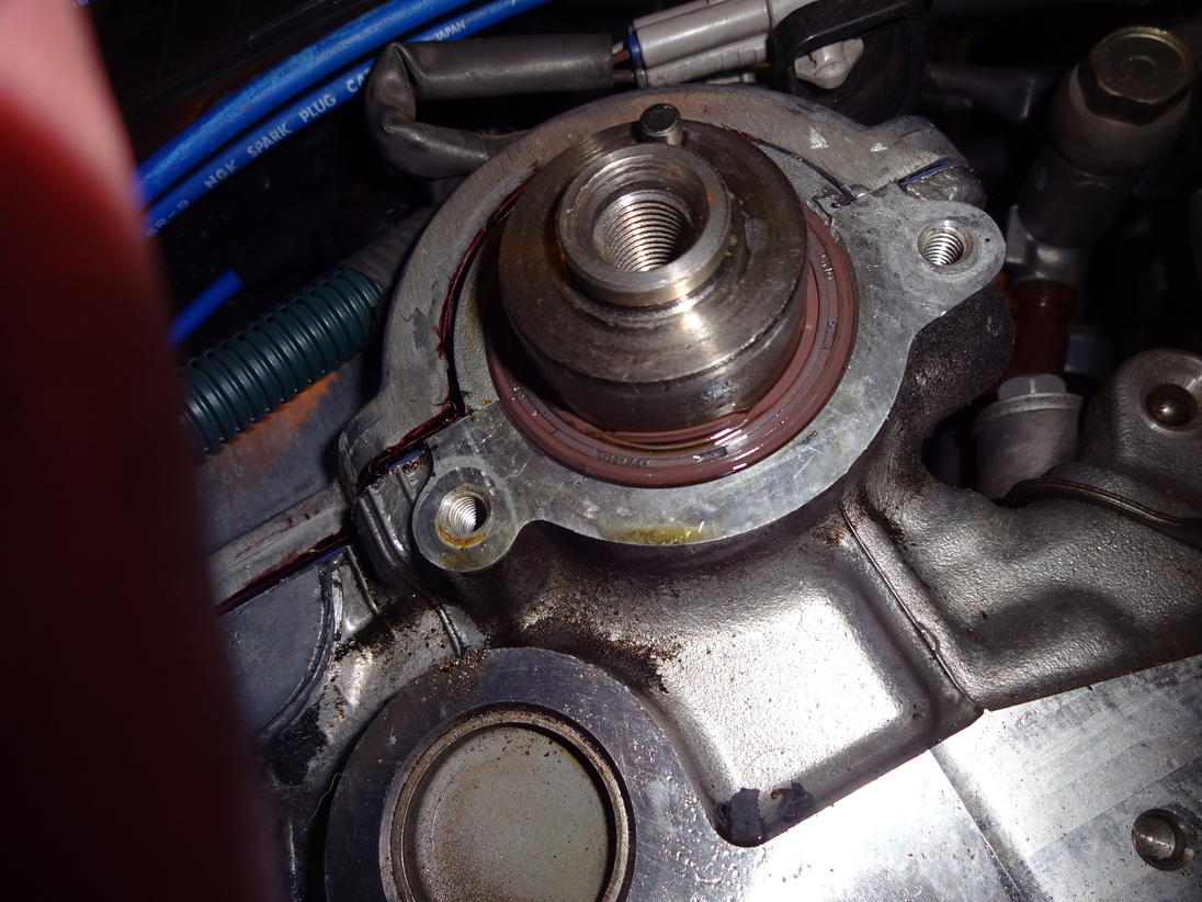

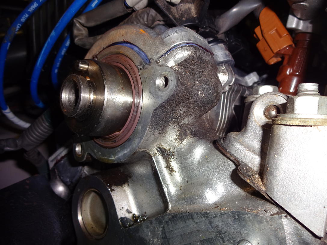

Leak repair update.
Almost 7 hours after I started taking it back apart again, I found the leak, without a doubt. Looking at the pictures, it looks like the shaft seal was "rolled", despite me lubing the insides of the seals before I installed them, and despite me being careful overall, and driving them in with a piece of PVC pipe. I am going to replace it, and study it closely for being "rolled", before I put everything back together.
Now I am torn between getting new seals from NAPA (Fel-pro seals), or the Toyota dealer. I am aware that normally OEM is best, despite the fact that Toyota does not make seals - they just "brand" them. But they chose the vendor that they believe makes the best seal. However, another member here posted that a new OEM crank seal leaked, and a NAPA one worked correctly.
Here are some pictures. Any other thoughts or advice? I am going to rest some and think on things before I buy seals and put it all back together. When I am finally done, it will be done correctly. No ifs, ands or butts. I am NOT going to do this horrendous job for the third time.
Also, the most difficult part of this entire job is removing that &*&&$^#&#^#^ a/c compressor bracket, so I could remove the timing belt tensioner. Yes, I am aware that the tensioner can be removed with a 1/4" drive extension and a universal joint. I did try that, but was unable to get a socket on the rear tensioner bolt, because I couldn't see a path to it. I tried real hard, but didn't succeed. It took me well over an hour just to remove that *($&#*&*&#*&#*&# compressor bracket.
