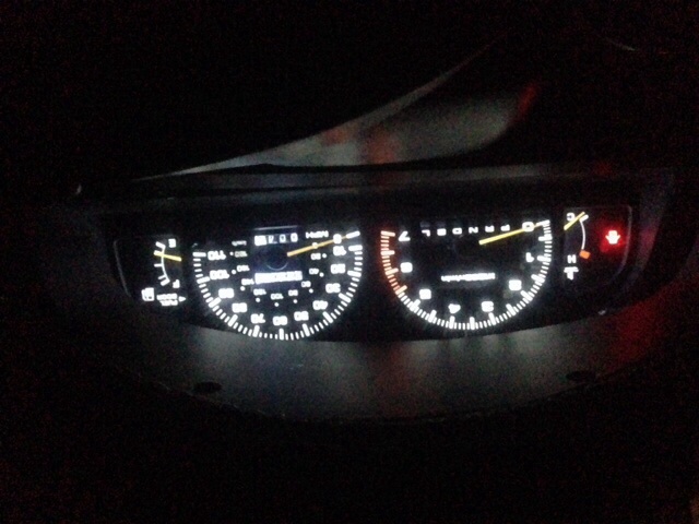

I will post a picture of the LEDs once it gets dark.
Thanks errrybody
Led hotness
