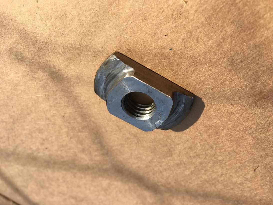

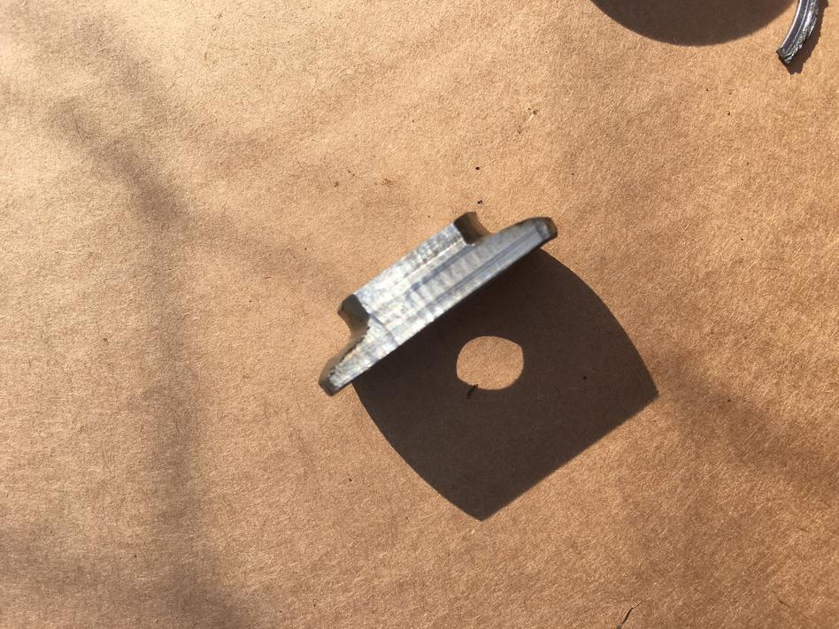

I had the same issue. ECGS told me to remove material from the T-nut end of the tool to make it fit. Let me get on my phone and I'll post some pics in a few minutes.
Here are pics of how I modified that shitty "tool" ECGS sells. Even after doing all this I had to "just tap it in" hard enough that it broke part of the bearing race off (you can see it in the second picture), but that bastard came out, finally. Getting the bushing back in is a whole different exercise in profanity...

That is exactly what I had to do and also broke the bearing as well. It took 2 hours to pound the new one in and it is a tight fit for the axle.
Thanks for the help.
edit: i recommend replacing this bearing if you are tackling the lower control arm bushings otherwise it will be a swear-festival of very sore wrists.
