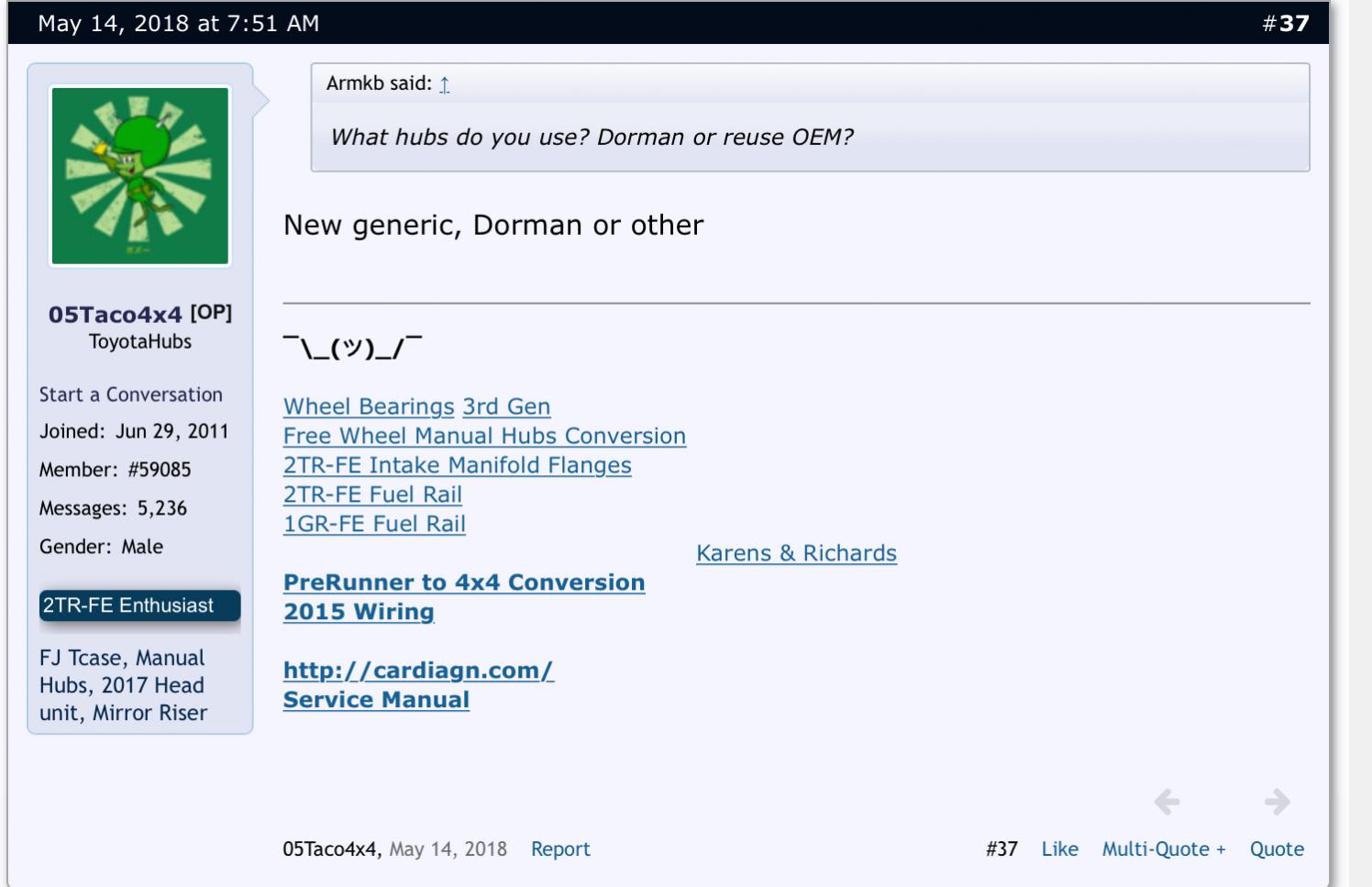

If youwant the good stuff, go over to TacomaWorld.com and message [MENTION=208167]05Taco4x4[/MENTION]. He sells top quality pre-assembled bearng / hub sets. Like most things, you get exactly what you pay for.

Correct. My bad. Fortunately, the hub isn't nearly as important as the bearing. When I had my Tacoma bearings replaced, I went with 100% OEM Toyota parts including all the seals. The new owner can look forward to another 100,000 trouble free miles as far as the front bearings go.
05Taco4x4 has shipped a lot of hubs in 2021. Many have posted positive remarks on the fast shipping. Every customer appears to be very satisfied when I looked over the last 11 pages of posts. 05Taco4x4 says he uses NSK bearings which are packed with more grease than KOYO. Occasionally, someone receives a tight hub that slides on about 2+ inches and stops. 05Taco4x4 recommends using the old axle nut to overcome the tight fit, remove that nut and install the new nut he supplies. Perhaps a few Dorman hubs are tight fitting, but OK if fully seated. Evidently, 05Taco4x4 offers a very good product and service.
