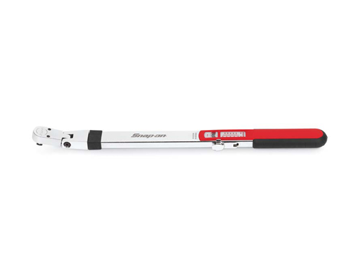

Snap-On doesn't make their own torque wrenches... but they do OEM a few options... Precision Instruments and CDI along with a couple others make their torque wrenches... Identical tool, different nameplate...
Personally I think the PI / Precision Instruments wrenches are top notch.
Really not that bad price wise either if you shop around.
1/4" Precision Instruments 30-200 inch/lb PREM1R200HX
3/8" Precision Instruments 20-100 Ft./Lbs PREC2FR100F
1/2" Precision Instruments 40 - 250 Ft./Lbs REC3FR250F
The 3/8 and 1/2" are both split beam flex head design, really awesome tools, and they dont need to be turned down like a traditional wrench, you can keep these set at whatever you want indefinitely. For things like tires it becomes very convenient. Very accurate quality tools. Made in America. Search around on the net for good prices... I got some decent deals on mine. All come with factory calibration certificates too.
Here is the Snap-On branded version of the PI
https://store.snapon.com/US-Reading...-20-100-ft-lb-Flex-Torque-Wrench-P651007.aspx
