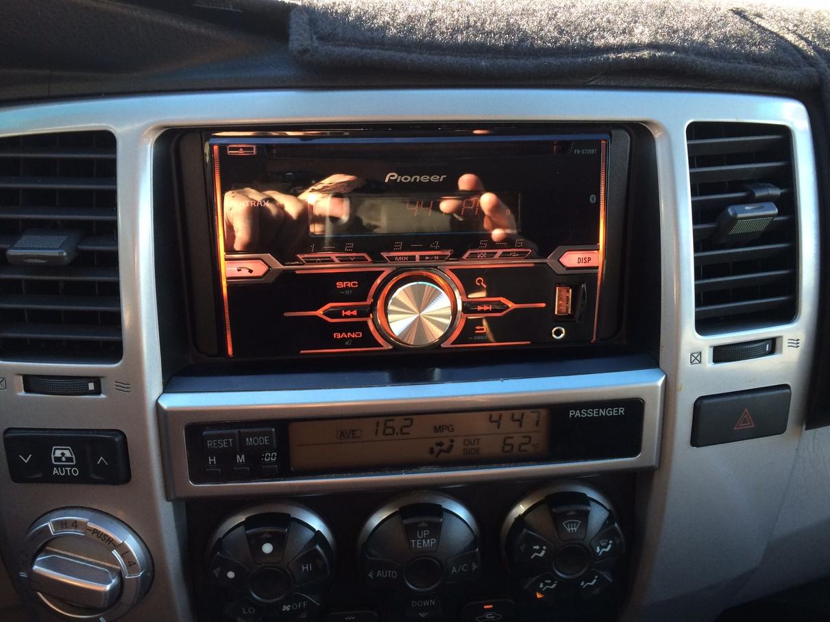

This is a popular one here. I like it. It was real easy to install, and runs about $150.
I second this unit as I have it myself and love it!
I'd also like to note this unit comes with a mic for phone integration which I mounted behind my rear-view mirror.
As for crutchfield they are great at listing all the (Metra) parts you will need. In turn I ordered everything off amazon (prime) for significantly less.
Regardless of what head unit you choose you WILL have to do the wiring harness yourself, which is not bad at all.
In case you are interested here was my parts lists...
Bluetooth HU - Amazon.com : Pioneer FHX-720BT 2-DIN CD Receiver with Mixtrax, Bluetooth® for Hands-Free Calling and Audio Streaming, Siri Eyes Free, USB Playback, Pandora, Android Music Support : Electronics
Wiring Harness - Amazon.com: Metra 70-1761 Radio Wiring Harness For Toyota 87-Up Power 4 Speaker: Car Electronics
Antenna Adapter - http://www.amazon.com/gp/product/B0002BEQN4?psc=1&redirect=true&ref_=oh_aui_detailpage_o05_s00
Antenna Cable - Amazon.com: Metra 40-UV43 Male to Female Motorola Antenna Cable: Car Electronics
Dash Kit - Amazon.com: Metra 95-8202 Toyota DDIN Multi Dash Kit: Car Electronics
