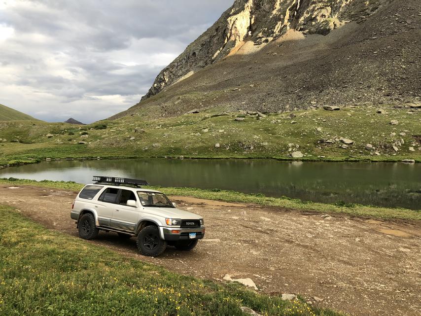

Well I did the LBJs and tierods last week. Came to Colorado today and went offroad for a good 3-4hrs. Learned a good amount, but most of all that I NEED the brake upgrade (need to research Tundra etc). In addition, while I didn’t do anything crazy or stupid I did have in mind a lot the front axles.. I’m wondering how likely is it to break an axle doing mild/medium trails and of that how likely is the break due to age vs just an accident? In short, I’m trying to decide whether to simply buy backup axles or replace them and use old ones as backup?
Thanks again for all the help. This is definitely a great car and a great hobby.
