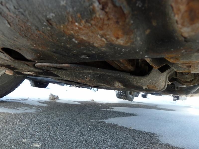

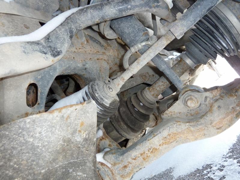

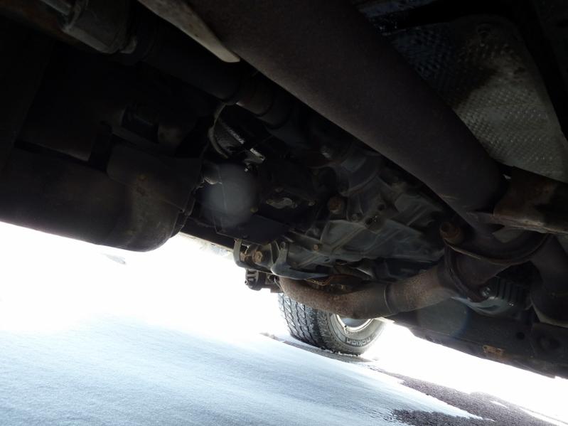

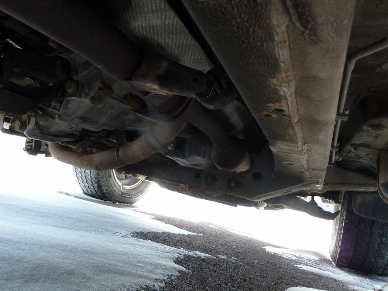

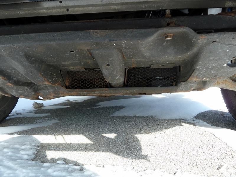

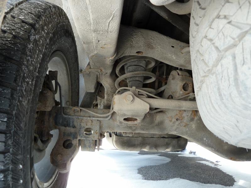

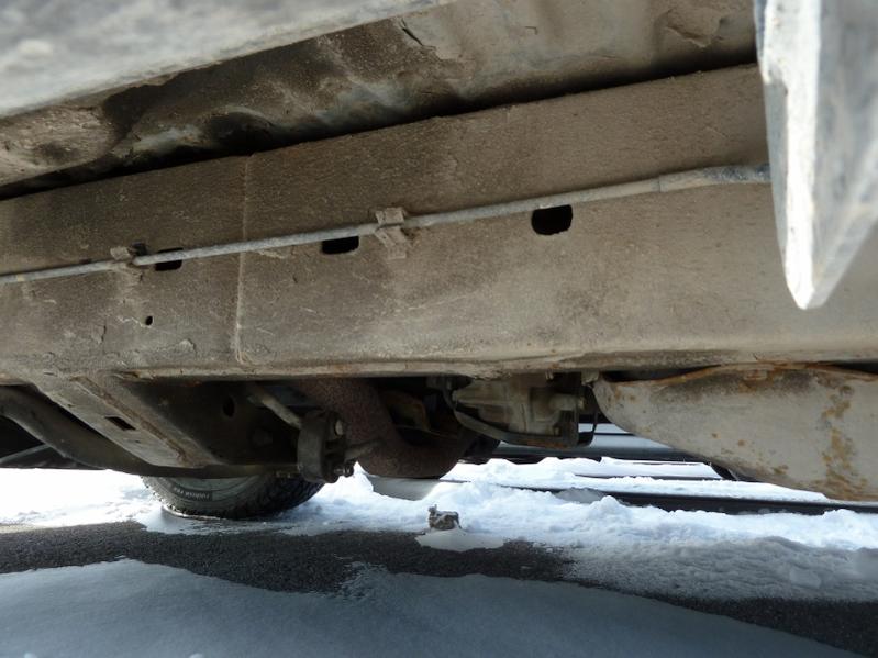

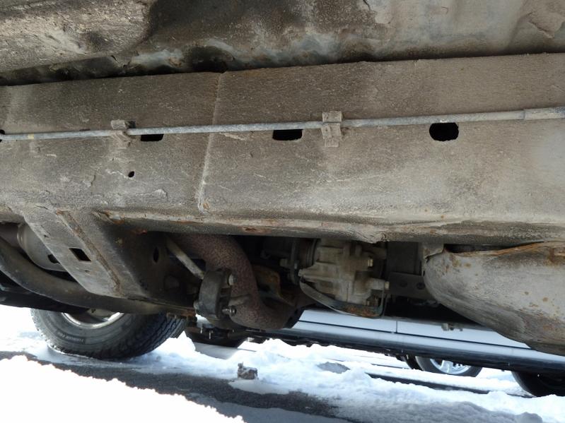

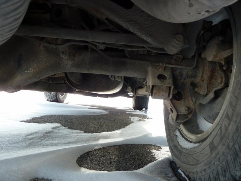

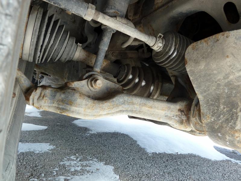

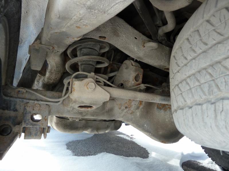

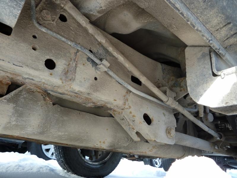

I took another look at the 2006 sport edition today. The body is in great shape and attached are pictures of the underside. What do you guys think by looking at the underside? Also the first 20K miles the car was in Kansas and then the last 40K it was in Vermont where it was serviced every 5K miles by the looks of the car fax report.
By looking at the pictures what do you guys think of the shape and how this rig was driven? Unfortunately I have to go through a dealer that will take my car in trade. They have other 4runners with V6 that are in great shape with low mileage but I have not convince myself to get the v6 unless it is a 5th gen (don't have money for 5th gen right now).

I wish I would have taken more time to inspect the undercarraige of the '03 I just bought last month. Granted, I took a quick peek for drips & leaks while running, during my test drives.... but I must have just been using my "stupid" eyes that day, because I didn't even think to consider or notice the rust. Like I showed in another thread recently, my tow hooks are rusting completely off in the front, and the radiator support portion of the frame looks really bad.
Now, I'm considering selling this and looking for something else, maybe even a Sequoia... I've been looking at an '03 Sequoia that's about 150 miles from me (online) but from what I've been reading lately, the Gen-1 Sequoia's had a Frame-Rust epidemic (like the Tundra's which were recalled due to frame rot), and until I can inspect or at least see pictures of the frame on that Sequoia, I can't justify making the drive for the purchase.
WITH ALL THAT SAID (and back to topic)... do an intensive inspection for rust, and like was mentioned, check the suspension, and the power steering too. My '03 has a "Ghost" in the PS that is causing me some issues. If it's the 4.7L, you must know that the 90,xxx maintenance schedule recommends the Timing Belt & Spark Plugs be replaced.... that will not be a cheap visit.
Finally, $22k seems to be overpriced anyhow.
There is some surface rust underneath as shown in the pictures. The first thing I would do is bring to a shop to undercoat the bottom.
I'm just looking for some help to figure out if my first assumption of this 4runner in true or maybe the underneath is not that bad when compared to other 4runners.
It was -2F yesterday so I did not spend to much time crawling underneath vehicles comparing. I looked under a 2007 4runner V6 with 100K miles and it looked approximately the same condition minus the dents on the front skid plate. Maybe this sunday coming up it will be a little warmer and I can compare it a little better.
Thanks !
My 4R has some surface rust on the undercarriage due to the salty roads here in NY. However, mine has never been abused and you can see how there are no dents whatsoever. A little bit of rust isn't bad, especially if you're in VT; you're going to get it rusty from the salt anyways. What is more important is that everything is mechanically sound. Everything on mine works and feels almost like it's brand new, so I'm fine with the inevitable rust. But you shouldn't go for that one in my opinion. If it looks like that just from quick inspections, you shouldn't take the chance that there could be more wrong with it, especially with a financial situation like yours. There is always going to be a car out there that is better and cheaper, it just depends on which one is right for you. Don't force it if it doesn't feel right.
This is NOT a good idea. Rust proofing will NOT get rid of rust that's already formed.
You must first get rid of the rust...then then have it rust proofed.
From the pics the only rust I'd be concerned about is the rust on the bottom of the floor pans. The rust on the frame is just surface rust..and will take YEARS AND YEARS to have any adverse effect. The floor pan is much thinner metal and the rust MIGHT eat it's way through in a few years.
To save yourself some time and money...Get under there with a wire brush and remove any rust with the brush....Then spray or paint on a product that converts the rust to an inert paintable surface. Believe it or not those products do a decent job of killing and stopping rust. After this has dried then spray on a Truck-Bed liner. More durable then rubberized undercoating and will help prevent any more rust forming.
