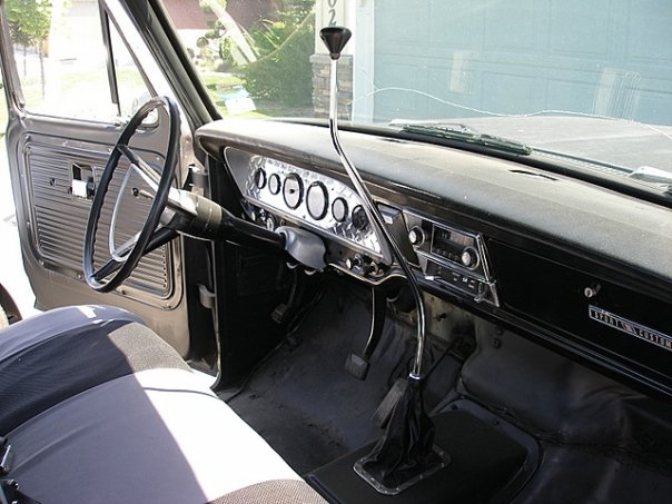

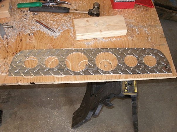

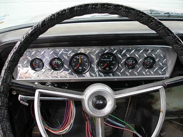

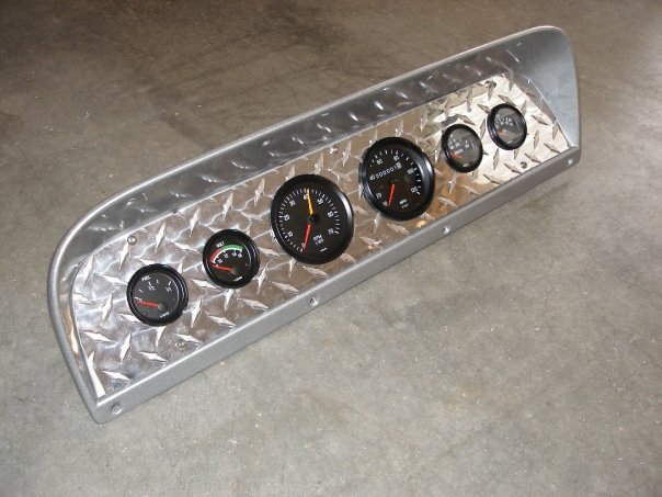

I can't take credit for this one. This was done by a buddy of mine. Super easy and looks clean. Not a Runner, it is in a 69' Ford pickup. It came out super clean. I think the diamond plate would suit the tough look of your rig. You could just cut a piece that would fit over the stock black piece.
