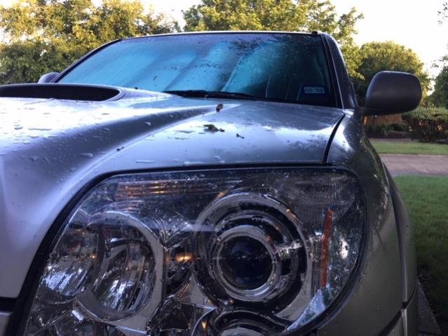

I picked up a set of Eagle Eyes off amazon and the quality is quite decent. I immediately tore them apart, painted the chrome shrouds with a gray metalcast, deleted the squirrel finder, filed the cutoff a bit, added Morimoto optically clear lenses and a 35w Morimoto HID kit. I'm happy with it.
picture of the headlights plese, a picture says a 1000 words:dancin:
Very minimal aesthetic changes, very simple. The shrouds come chrome, but these headlights had the best reviews and I knew I was tearing them apart anyway, so I wasn't worried about the chrome. I have to paint the chrome grill to match as well. :)

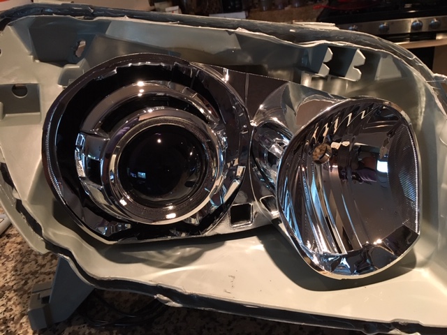

I just finished my retrofit project. It took me a while and I messed up on the 1st housings so I bought a 2nd set and this one turned out better. The Morimoto projectors I bought on sale for $300 from the retrofit source. TYC headlight sets were $100 and I have an extra set of lenses now and can replace the lenses when the lenses get frosted to the point where headlight restoration doesn't work.
