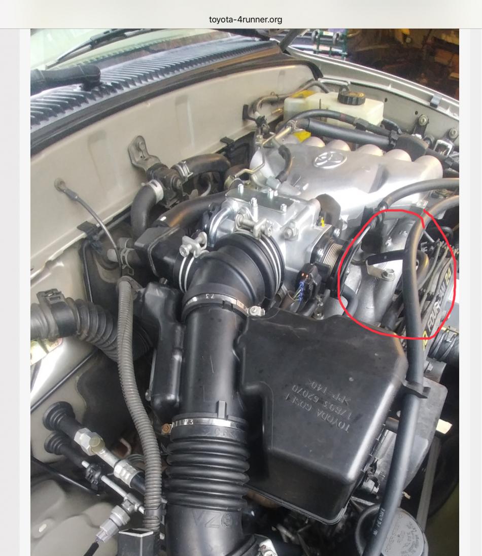

Much appreciated if you can provide the part number for the small hose circled in red. I believe it originates at the lower plenum and connects to the smaller airbox.
Preformed and each end has a different diameter so generic supplied line no good here.

Totally a late reply here.
That hose?
I used a generic hose: 9/32" - 7MM is printed on it.
I can't find the part on the parts diagram...which usually means it isn't going to be a molded hose. I usually take old hose off, cut them in the middle and get the exact size. I always have to bug the NAPA guys because they have SAE sizes and not metric. But I am pretty sure the diameter of the hose is exactly right at 7MM. Now were the ends molded? Maybe? I figured they just deformed to the ports.
That hose?
The end on the resonator is a larger size than the rest of the tube. The part number is 1734362110 HOSE, NO. 3(FOR IDLE-UP).

I landed up having the parts guys at Conicelli Toyota give a hand with figuring out the part number on that hose.........all good!
