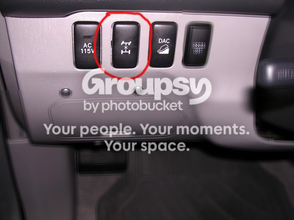

Awesome, thanks. another dumb question, how do I lock the differential?
I don't know the text book answer but I know it must be in 4wd first. Once mine is in 4H or 4L I put it back in neutral and hit the center diff button and it locks. After I put it in neutral and hit it again and it unlocks. I'm not sure putting it in neutral is necessary but I never asked and it's never hurt. Someone will jump in and help clarify
Lock.jpg~original
That's the button, has to be in 4hi or 4lo, don't try to engage it when turning or the wheels are spinning. I usually stop or roll at less than 5mph before hitting the button.
