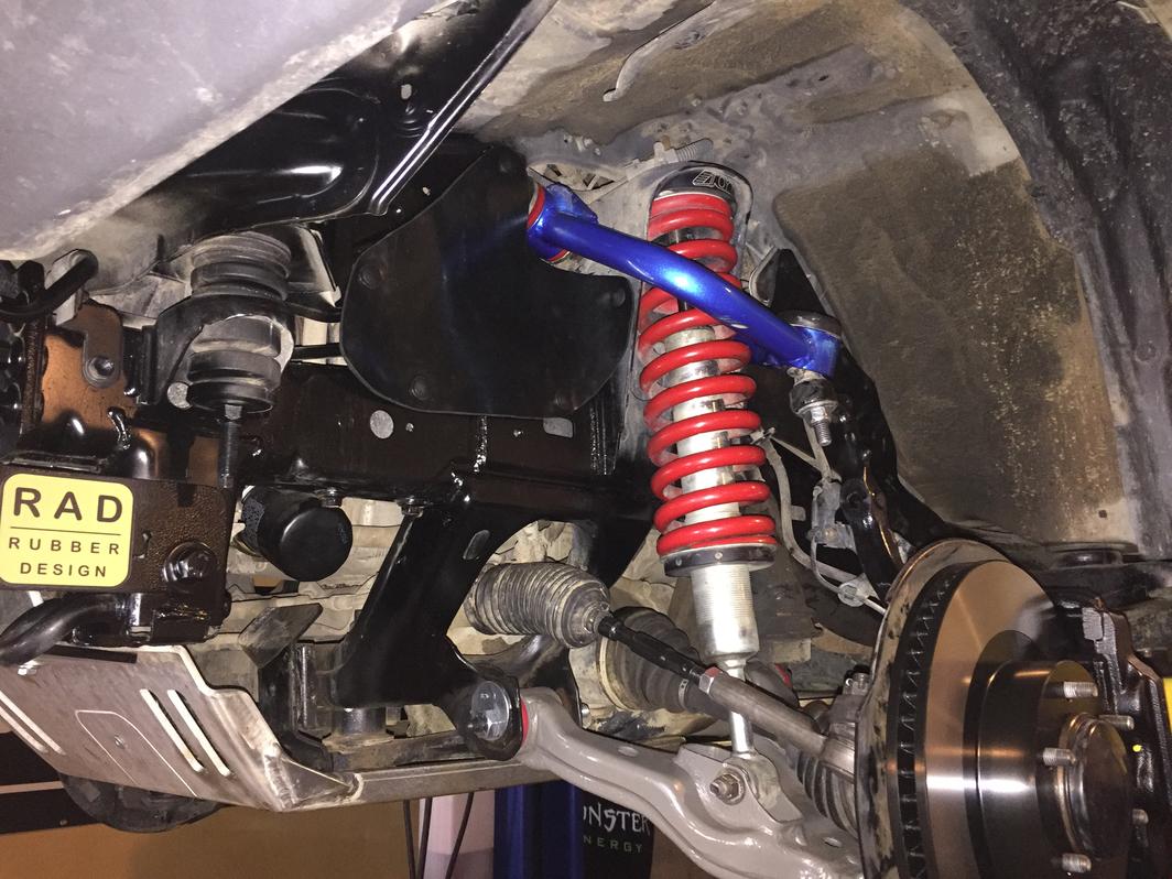

So..... I decided to do some maintenance on the GX and at the same time do some upgrades.
I had a wheel bearing with a TINY amount of movement on the pass side, I noticed it when I had it on the lift rotating tires. Then I noticed my upper control arm bushing was torn. So I did what any reasonable person would do...
I ordered new bushings for the tube upper arms, E-coated rotors, Wagner calipers, energy lower bushings, timken wheel bearings, moog greaseable cam bolts and inner/ outer tie rods. I figured if I'm doing bearings, I might as well do everything. I topped it off with some RAD fender liners.

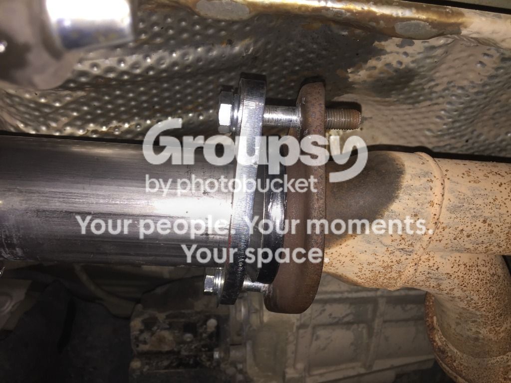

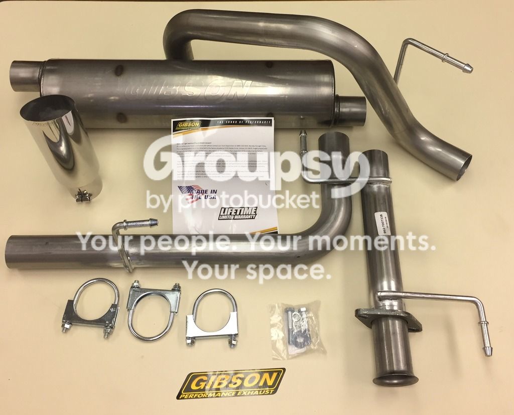

So...It looks as if I still have a thing or two left on this GX, I ordered a Gibson SS Exhaust from [MENTION=9]Jason B[/MENTION]. I unpacked everything today and will install tomorrow. It looks pretty straight forward aside from one thing. The 2 bolt flange; not sure if it need a gasket/donut or not. There is not one in the kit, so I assume no.
Stay Tuned for an AAR

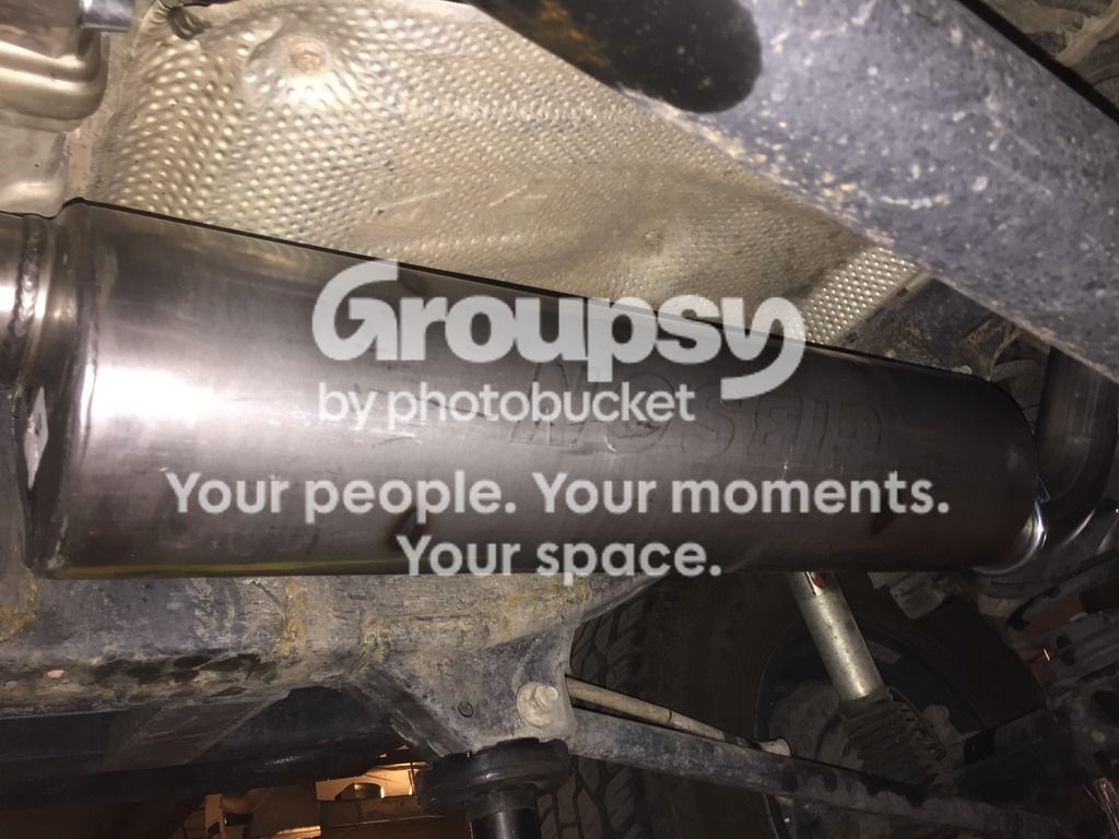

Last Night I installed the new Gibson Exhaust on this GX. I have some simple photos and one grip (against Gibson not [MENTION=9]Jason B[/MENTION] )

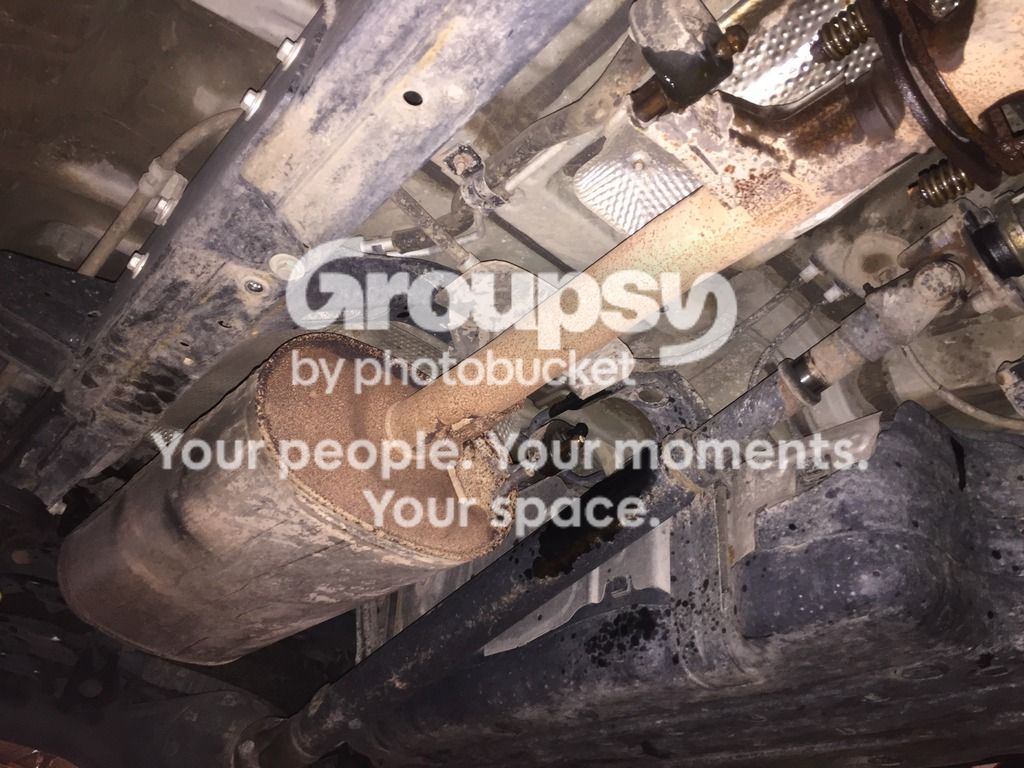

First a Before Photo.

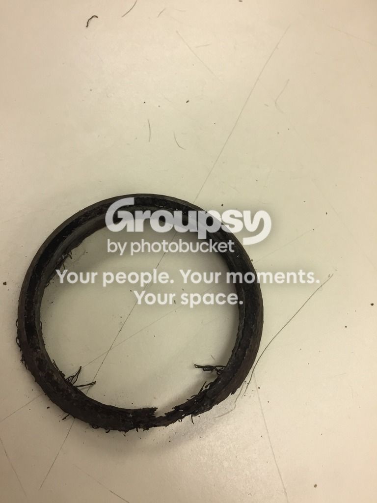

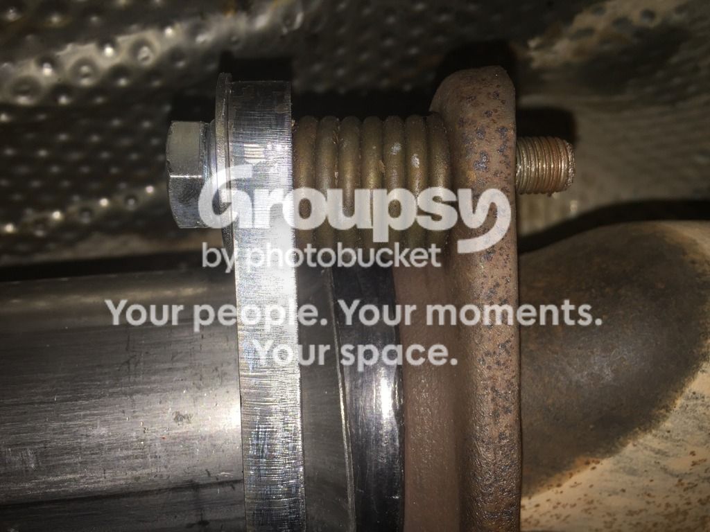

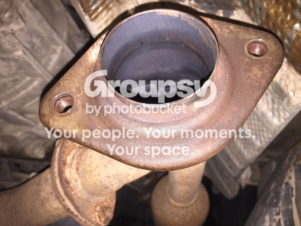

Next, My gripe: The new exhaust did not come with the needed exhaust donut. Before install I suspected it may be needed, but after taking the old exhaust off, I knew it HAD to be replaced. I ended up going (in order) to Advanced, O'Reilly, Auto Zone and then NAPA....LUCKY for me NAPA had the correct donut (PART NUMBER 31639). Gibson should either put it under the tools needed section in the instruction or include one. It's only a $10 piece but it brings the otherwise install to a screeching haul.
Old Gasket
After you get your new gasket, be sure to clean the old mounting surface very well with a wire brush. this joint is prone to leak on this model.

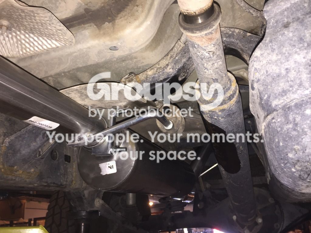

You CANNOT reuse the springs from your OE exhaust, the clamp will not tighten down enough.
BE SURE to use a little anti-seize on the two bolts here to help future you out.

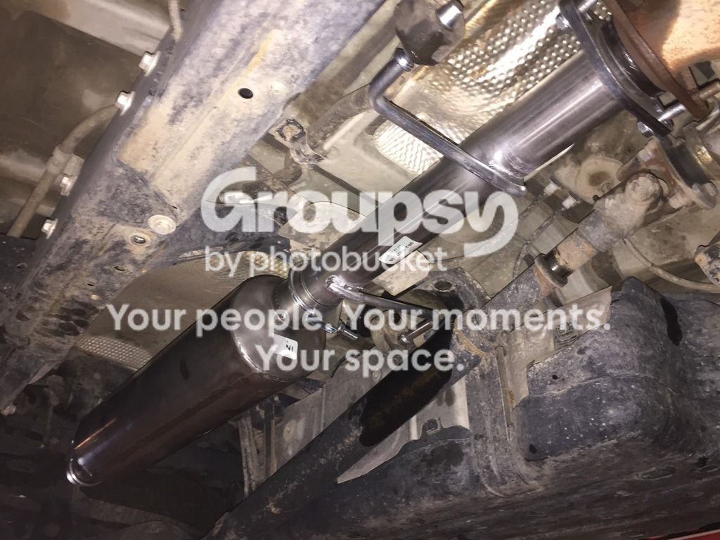

Install is super simple and straight forward. For some reason, if you place the inlet and outlet so it fits (like the picture in the instructions) the "Gibson" logo is upside down and the seem faces the ground. IMHO, the logo should be whats visible, but it changes nothing. The install is super easy and took about 40 minutes (because I had to take the main flange back off to remove the springs)

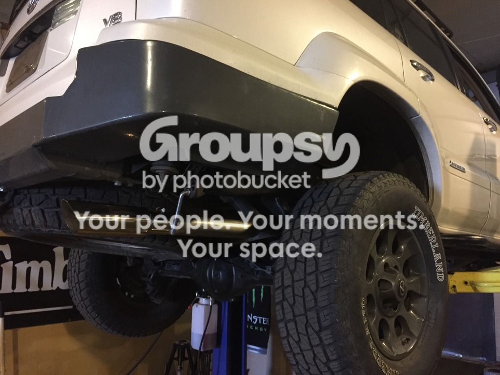

The final product sounds just a slight deeper than stock with zero drone (so far, but I only have a couple hours driving on it)
Final thoughts:
This exhaust is built nice with quality welded and bent stainless steel (right here in the USA). The price was unbeatable and it showed up much faster than stated. It gave the V8 a little more rumble at idle and start up with zero drone on the highway. When I go all "show me the money" on the skinny pedal, it sounds like a V8 should when it's about to explode. Aside from the fumble with the exhaust gasket, I would not hesitate to recommend this exhaust to anyone.
After
