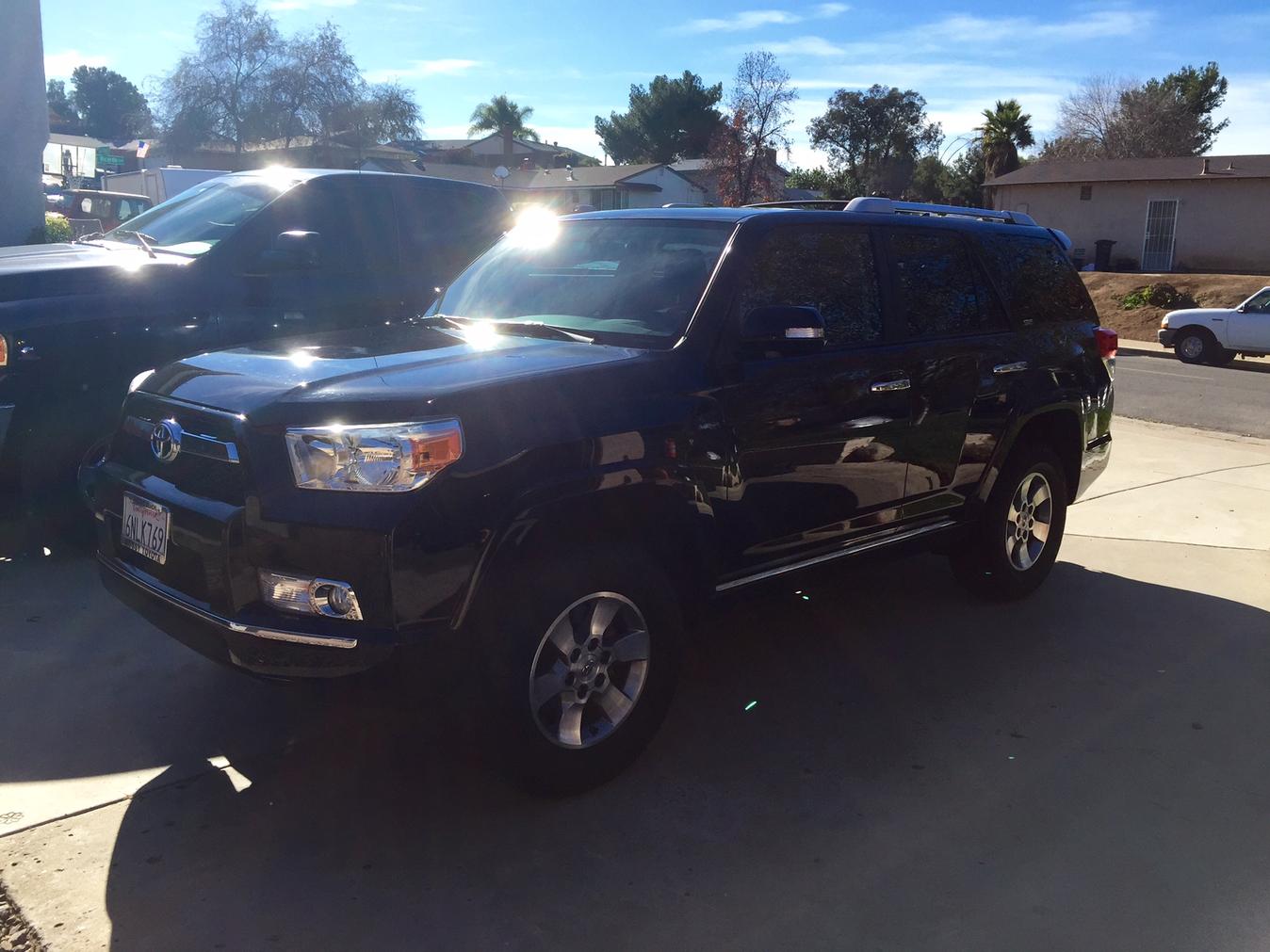

So about 3 weeks ago my wife and I got her a new 4runner. We had a 2002 that had 212,000 miles and it was time to let it go. It was having a lot of minor issues and with our busy schedule it was going to the shop too much.
We purchased a 2010 SR5 with only 34,000 miles on it. It is a certified Toyota used so we have the full warranty on it. After reading on here for a couple weeks I decided to purchase a Toytec 2.5" spacer lift. I had the spacer lift installed with alignment last weekend and I couldn't be more pleased. It now sits level and the ride is perfect. Honestly I could not even tell at all that the ride was stiffer. Now I want some taller tires. Can I go taller with out going wider with stock wheels?
Picture below with the 2.5" Toytec spacer installed. My cummins turbo diesel in the back. Best truck I've ever owned.

nice!
You can put 285/70/17 on the stock wheels. You will probably get some slight rubbing though and need to remove that piece of plastic that covers the body mount. You will also need to move the front plastic liner a bit too.
