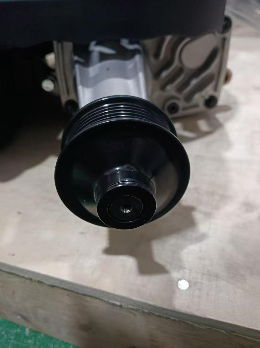

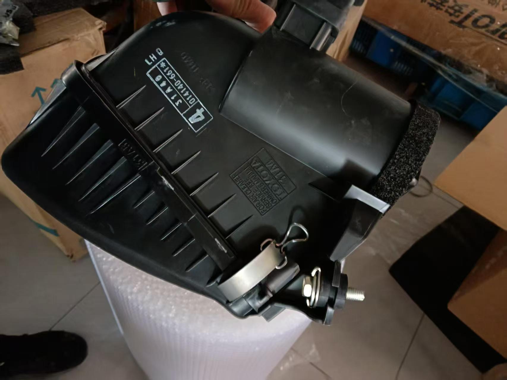

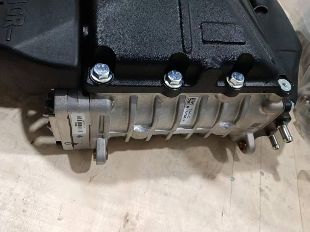

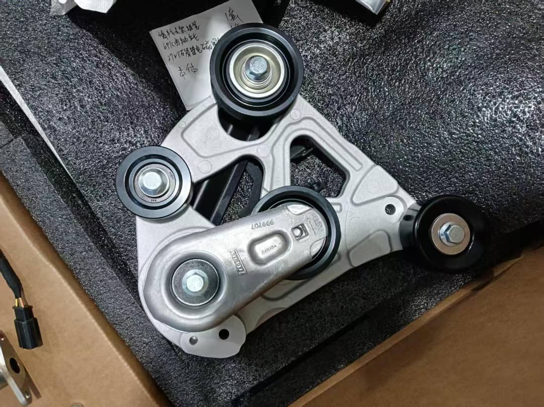

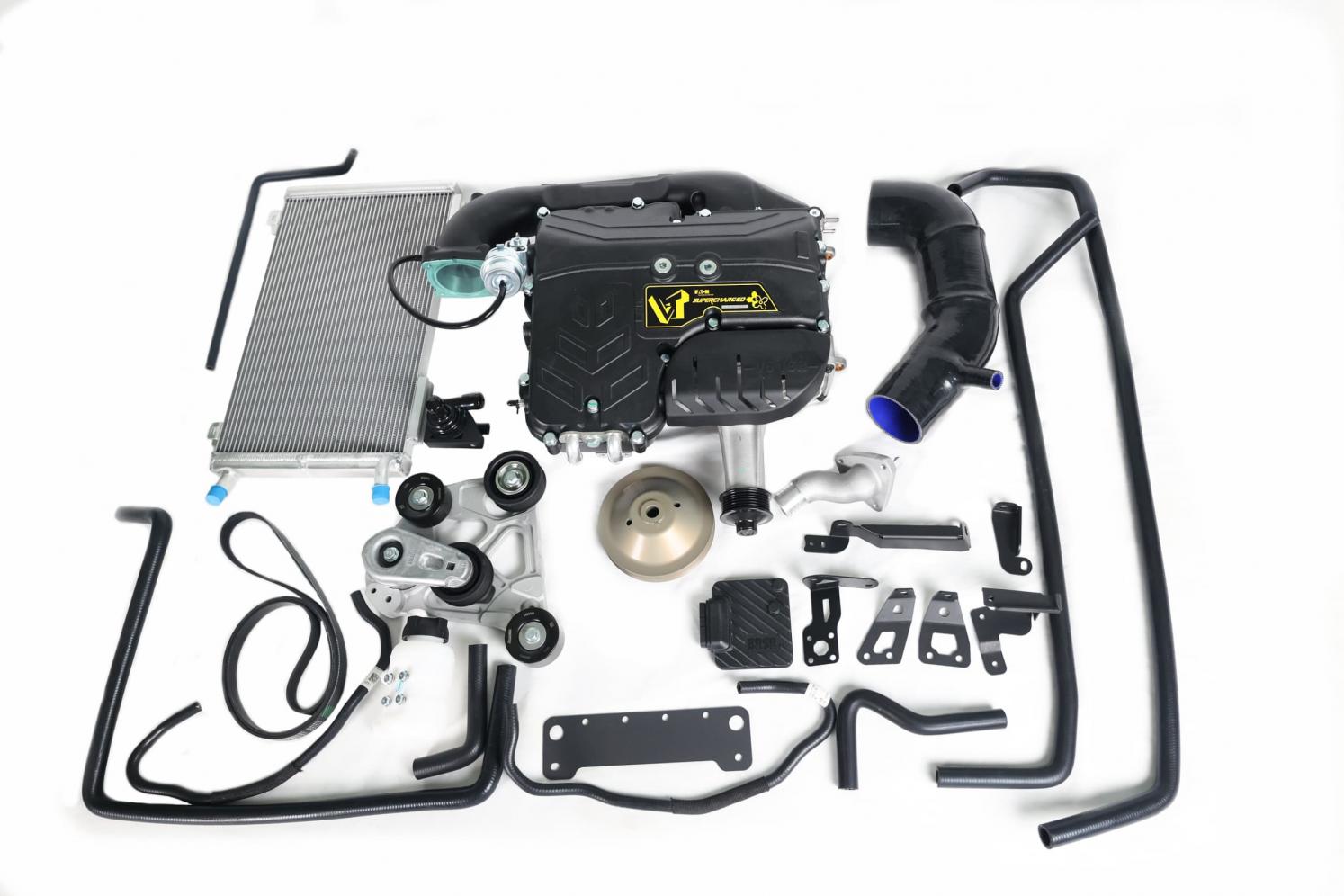

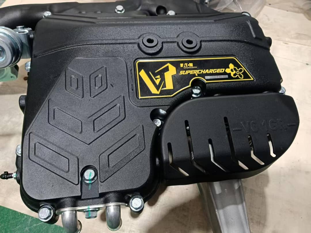

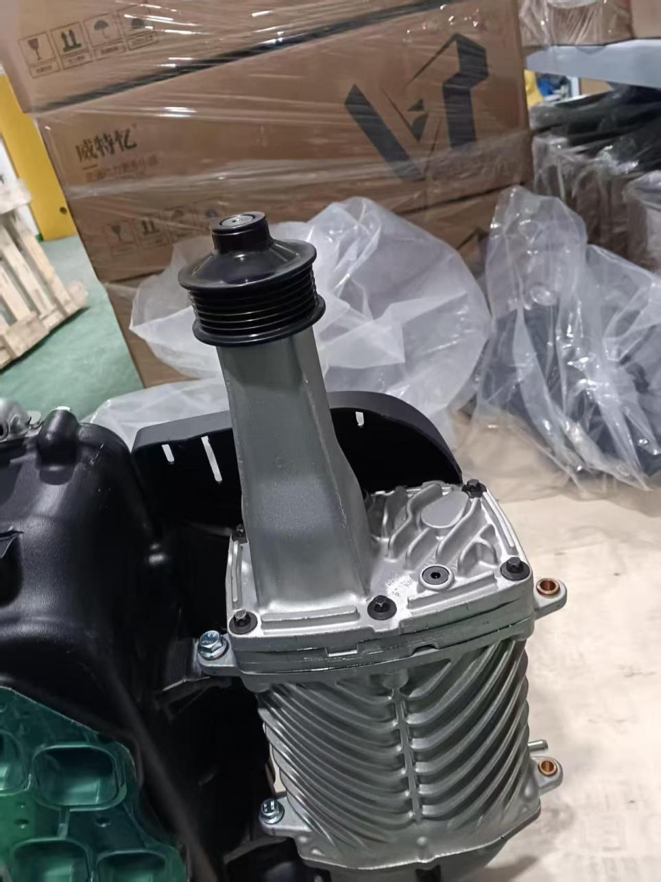

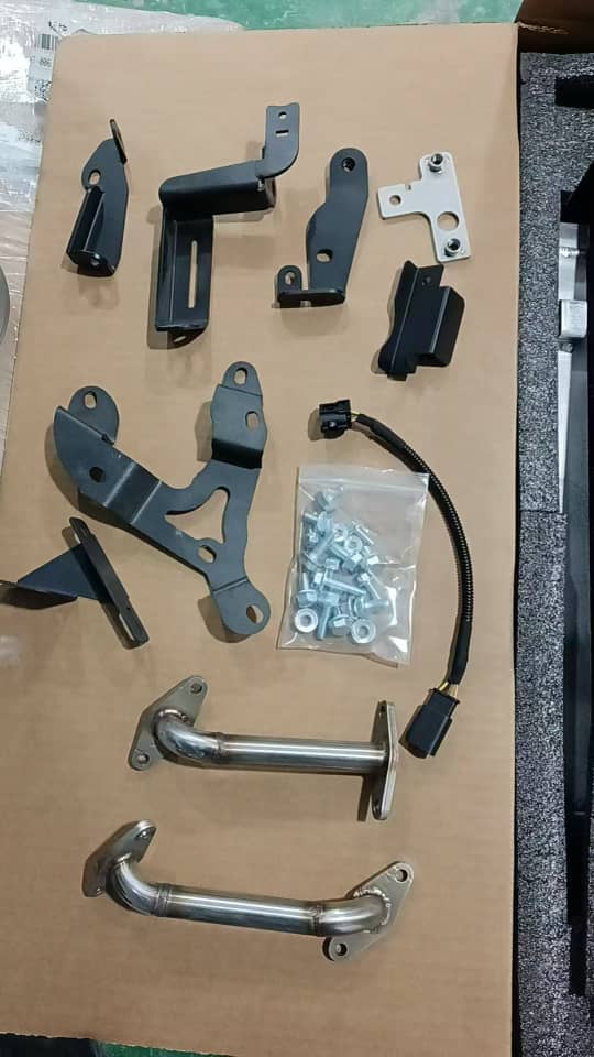

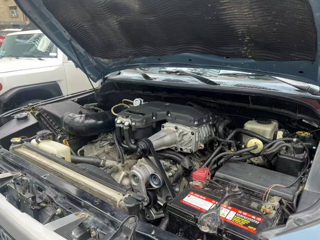

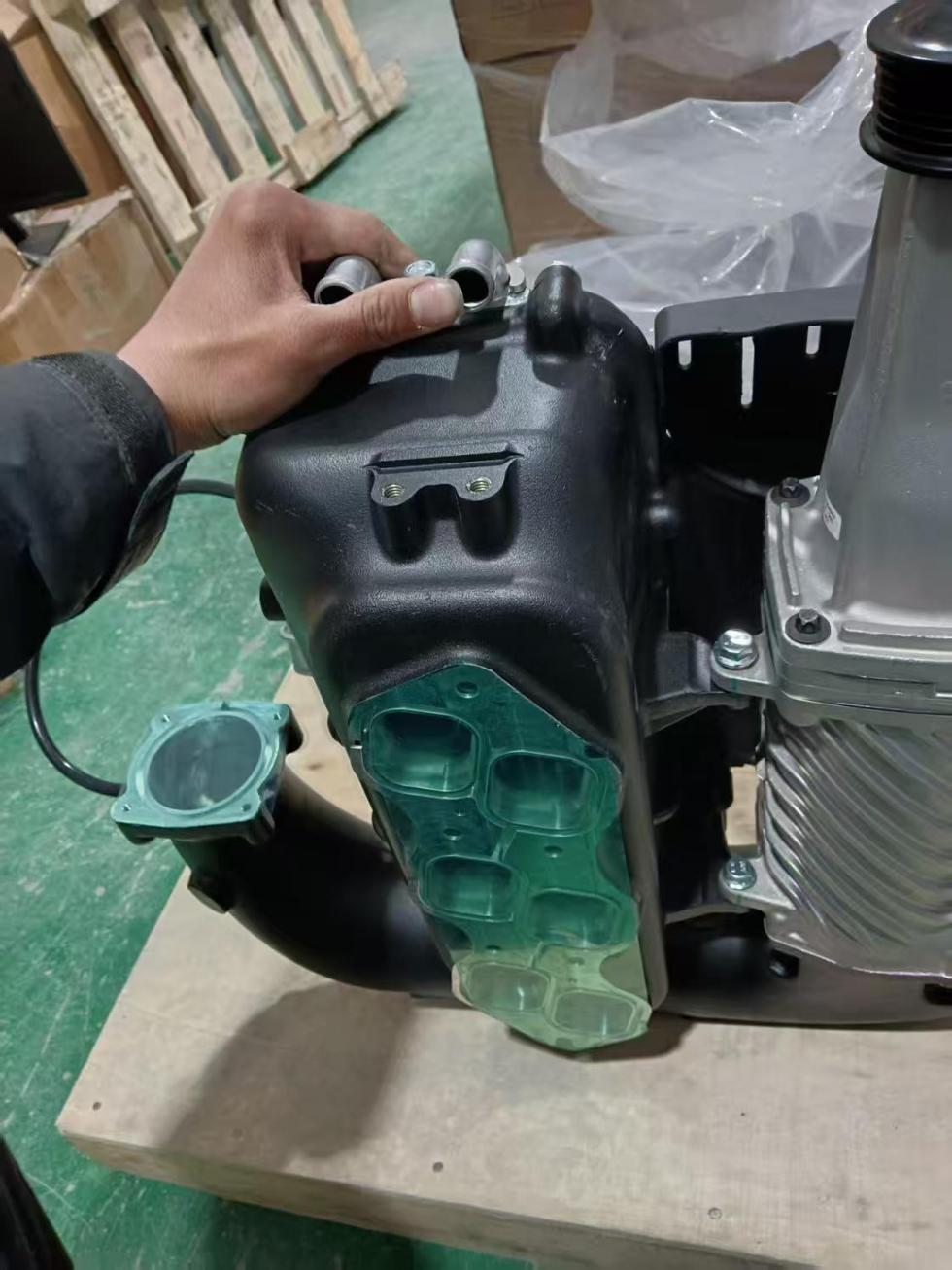

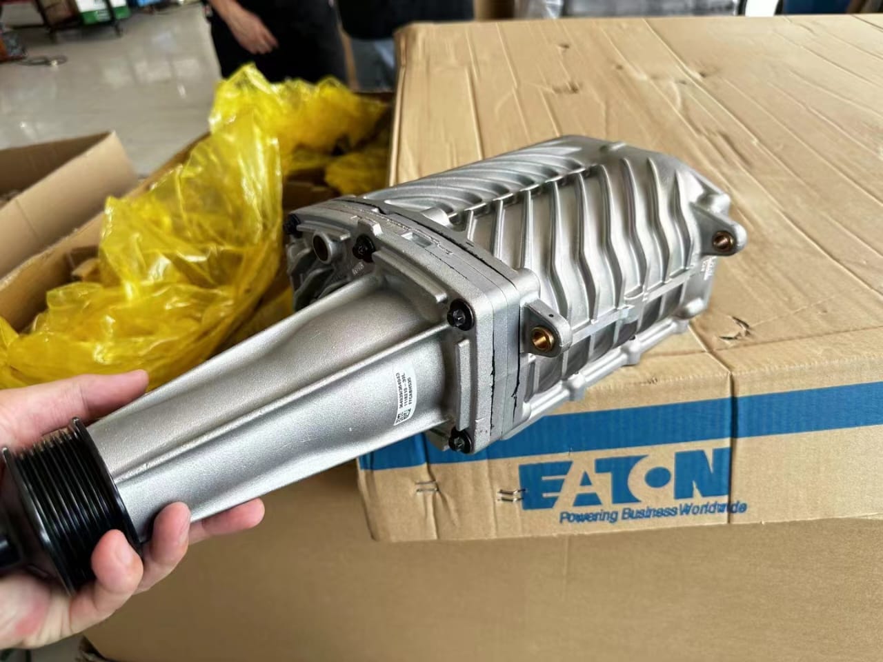

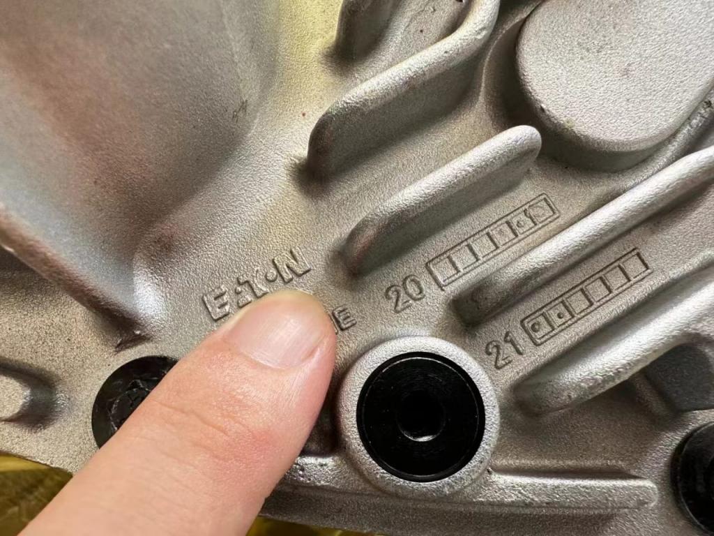

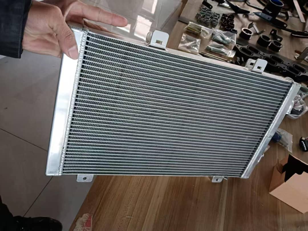

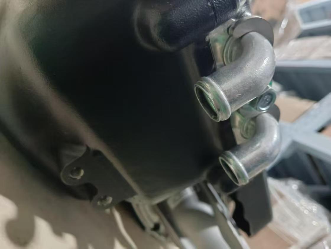

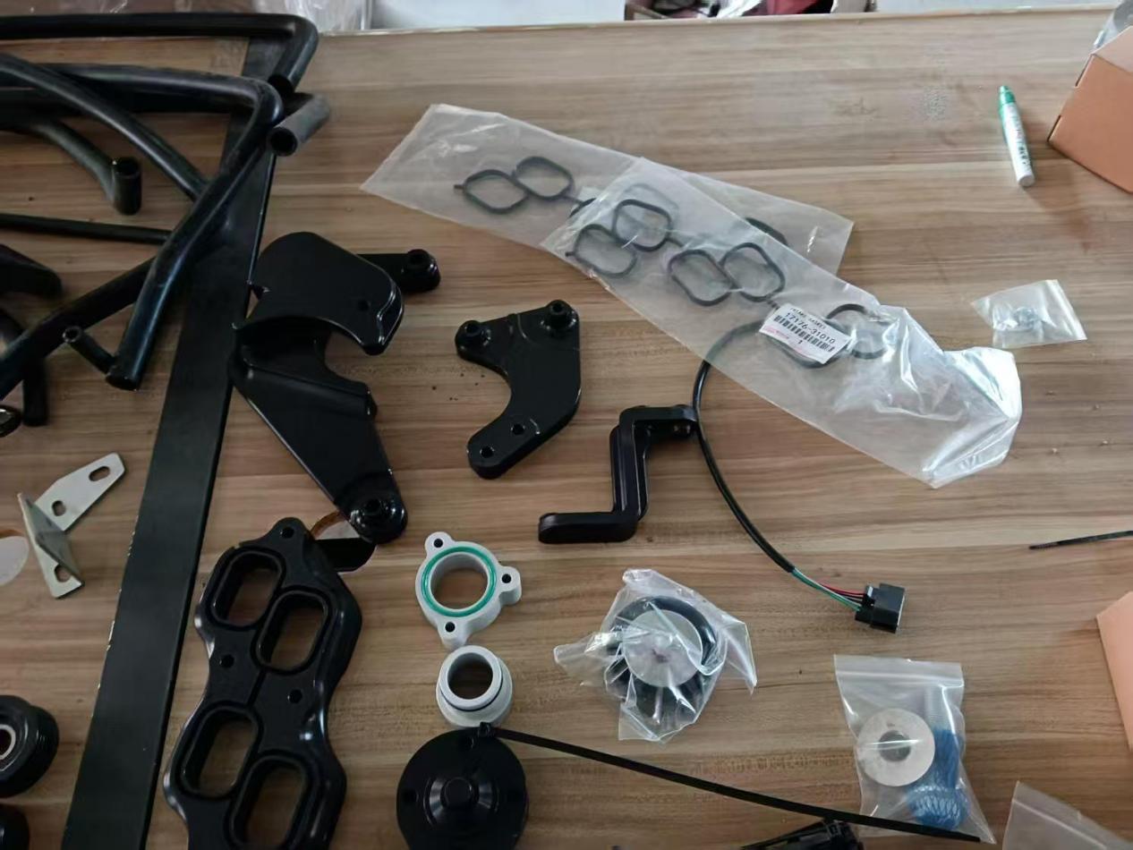

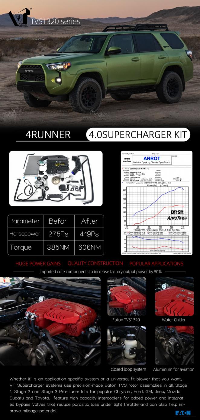

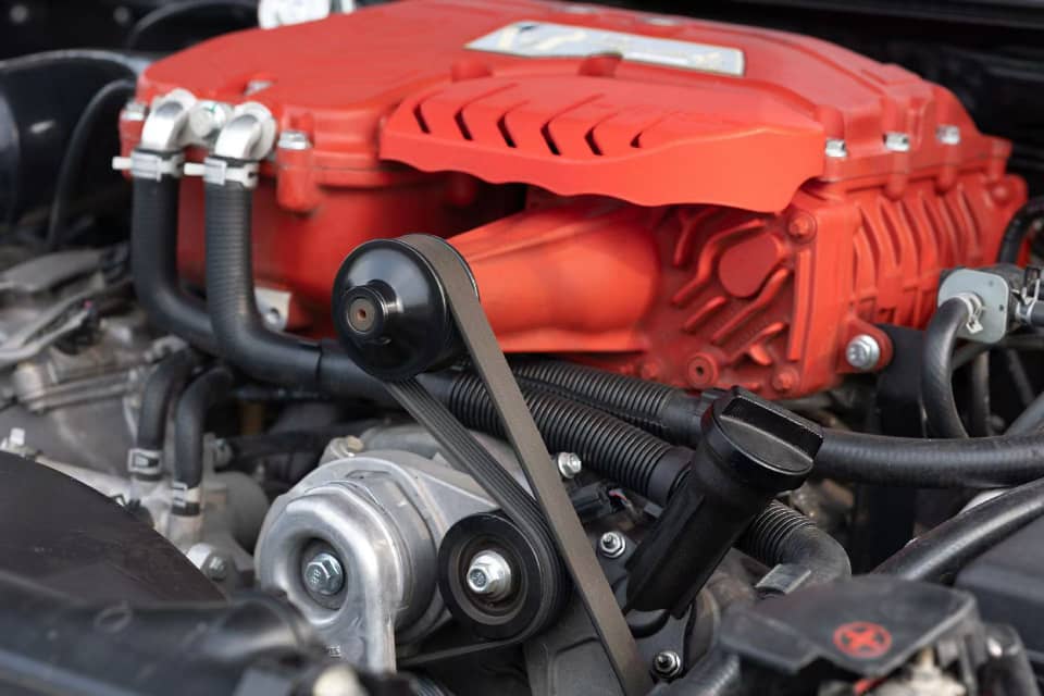

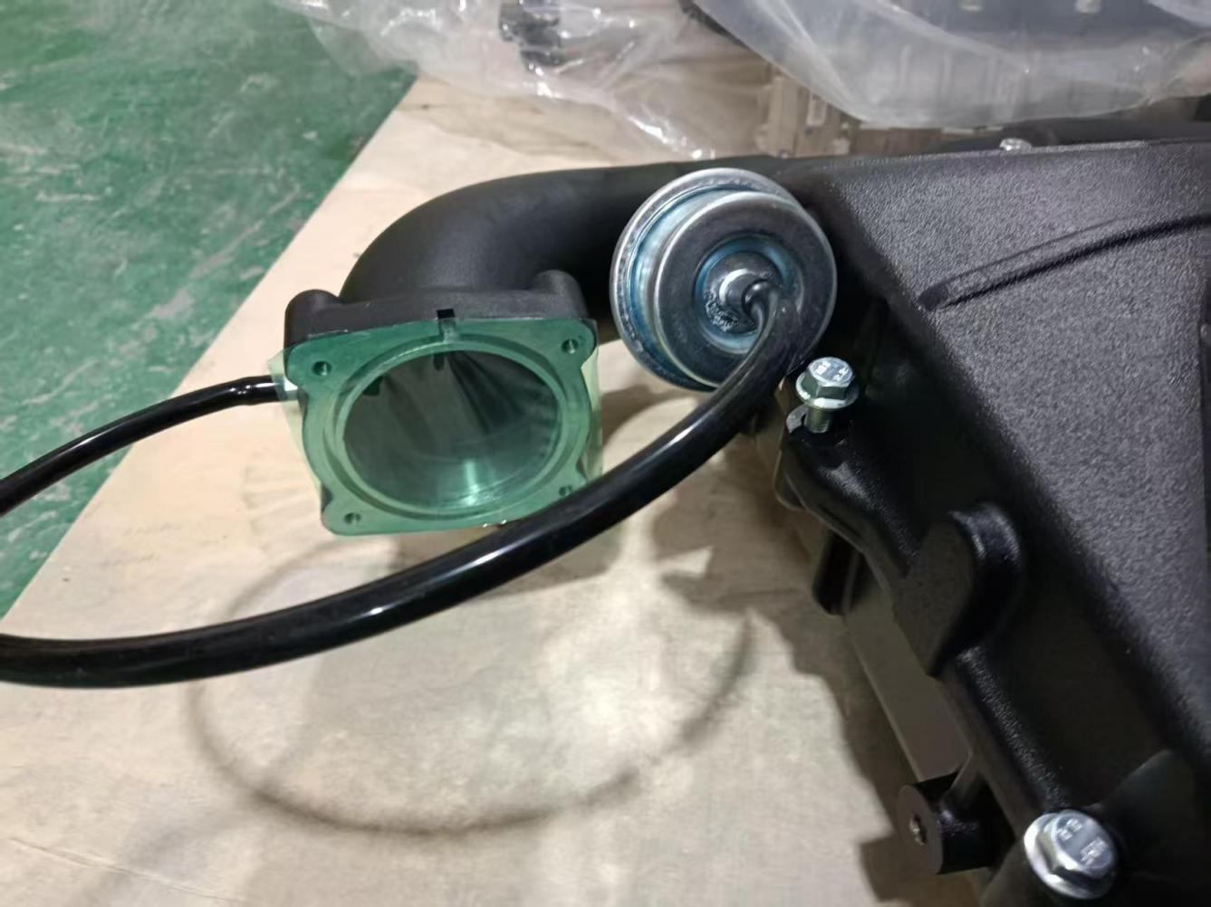

So this supercharger uses EATON TVS1320 body which is made in australia. Only added parts are chinese. Air fedex shipment and 3 year warranty total $5050. I guess they are big in Europe and on Mazda technology. They also have authorized reseller certification from Eaton. They are claiming 140Hp more than magnuson which also uses same Eaton tvs1320 body. I will attach more of their spec here later.
Since it is my hard earned money, I needed to be careful as well. I asked the seller more detailed information to make sure its not scam or some cheap stuff. This is what they sent me, let me know what you think based on what you see. More research is needed obviously, since 1GR-FE is very common engine, they tested this on many vehicles like Prado and LC etc. In many countries LC200 uses 1GR engine as cheaper variant. Like I said, Magnuson uses the exact same https://www.eaton.com/us/en-us/catalog/engine-solutions/tvs-r1320.html
Appearantly this company is authorized distributor of EATON as you can see from their certificate. https://www.eaton.com/us/en-us/locate/tvs-distrubutors.html It also adds only 7PSI. The power gain is insane and technical design is from EATON.

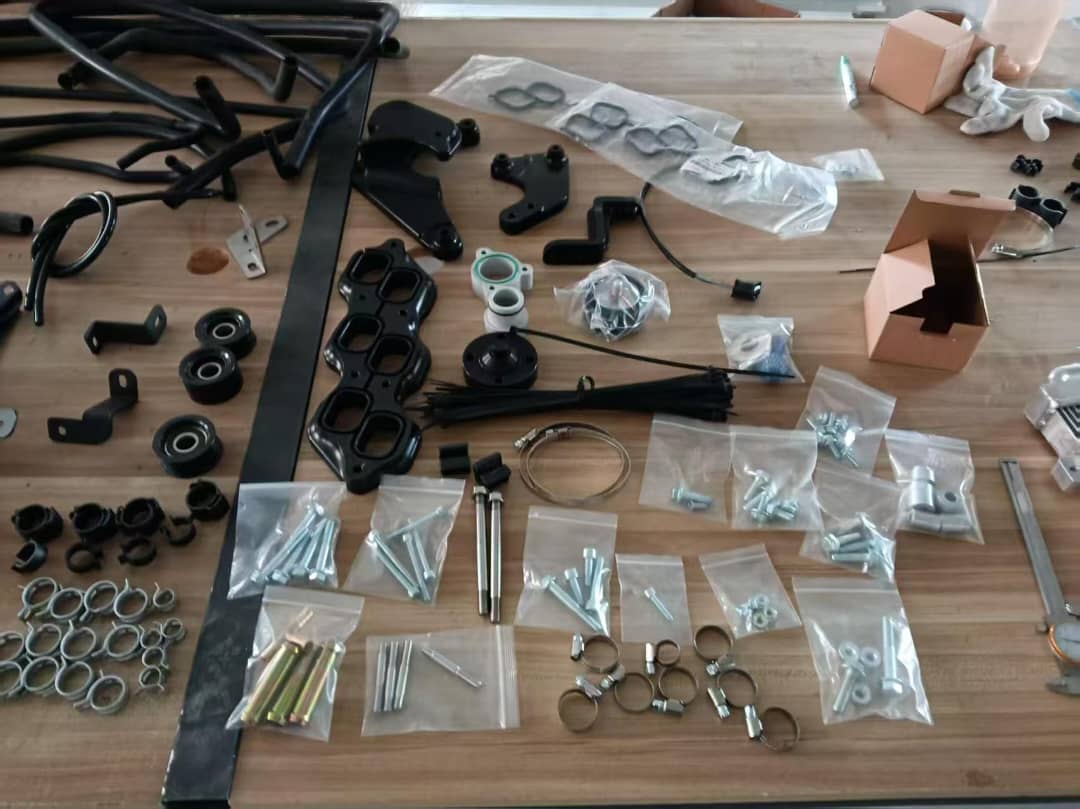

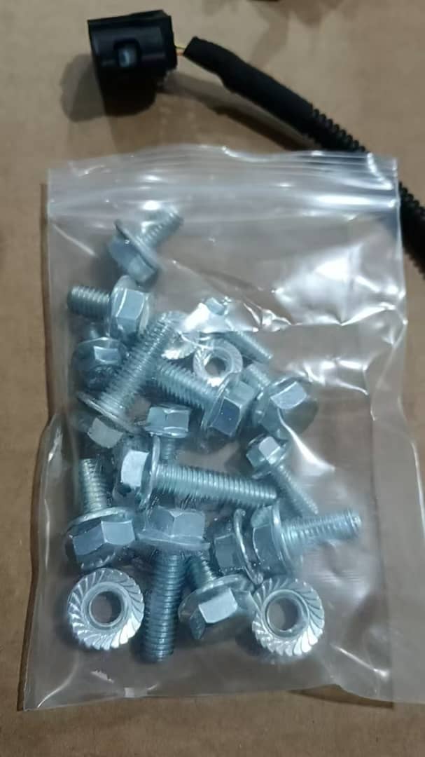

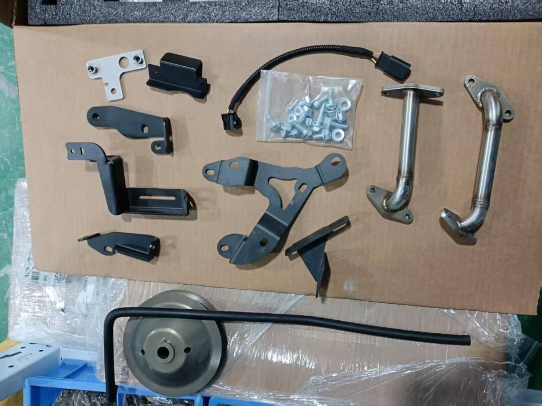

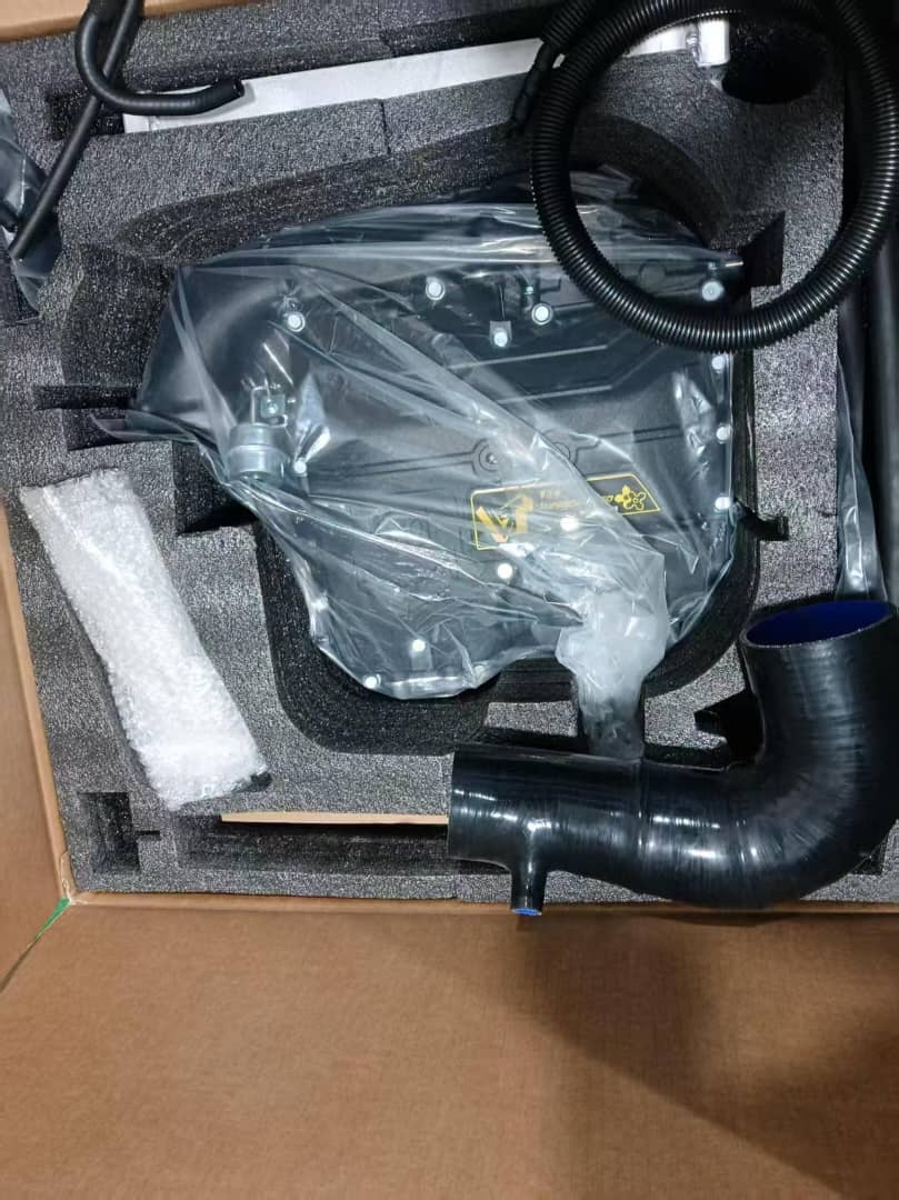

Sorry for the spam, but I wanted to have as many eyes see as possible to give me their opinion, before I waste my hard earned money. $2000 difference is a lot for me. I do not remember if I mentioned 3 year warranty and you can send parts back for free. They said they can ship by air Fedex. Shipping included $5050. I also have the installation video they sent me through WhatsApp, but not sure how to share that video with their pdf installation guide here.

So this supercharger uses EATON TVS1320 body which is made in australia. Only added parts are chinese. Air fedex shipment and 3 year warranty total $5050. I guess they are big in Europe and on Mazda technology. They also have authorized reseller certification from Eaton. They are claiming 140Hp more than magnuson which also uses same Eaton tvs1320 body. I will attach more of their spec here later.[/
I looked it up and Magnuson claims 335 hp, which is 65 hp more than the stock 270. You’re saying this Chinese VT supercharger produces 140 hp more than the Magnuson while using the same body? That’s a total of 205 hp more than stock. I personally can’t wait to see this. I’m sure the final story will be brief.
Before you put a lot of importance on the 3-year warranty, I'd look closely at it. Are all the idlers and other pieces included? What does a warranty replacement involve? Where do parts ship from? Is the labor covered, too? What about engine damage caused by the device? Is the warranty pro-rated, meaning if it grenades at 2 years 11 months, do you get a whole new one completely free? So many questions there.
If $2k is a big difference to you and this is your daily driver then this is a stupid risk to take so you can accelerate a little faster in a … slow truck.
Dumb.
Also, if it is the same TVS1320 and same 6-7 psi then the power claim is total shit.
Dumb.
100% agree with this. you have to pay to play. the blower may be an Eaton, but the bearings on those pulleys and the tensioner and everything else is probably not the highest quality. superchargers are HARD on belts and pulleys. when one of those fails (i say when because they all do, even USA made ones. they just last longer), it will likely be harder to find a replacement pulley and it may even leave you stranded on the side of the road. not to mention, the 1GR-FE wasn't built for boost. people run the magnuson reliably for many miles, but adding 140 bhp on top of that seems like a bad idea and a recipe to install an inspection window in your block. where is the tuning coming from? Magnuson supplies the tune. does this require a custom tune? if so, it's not $2,000 cheaper. can the stock transmission even handle the added torque? if $2,000 is a big difference, then nearly doubling the horsepower of your engine is a bad idea in general.
