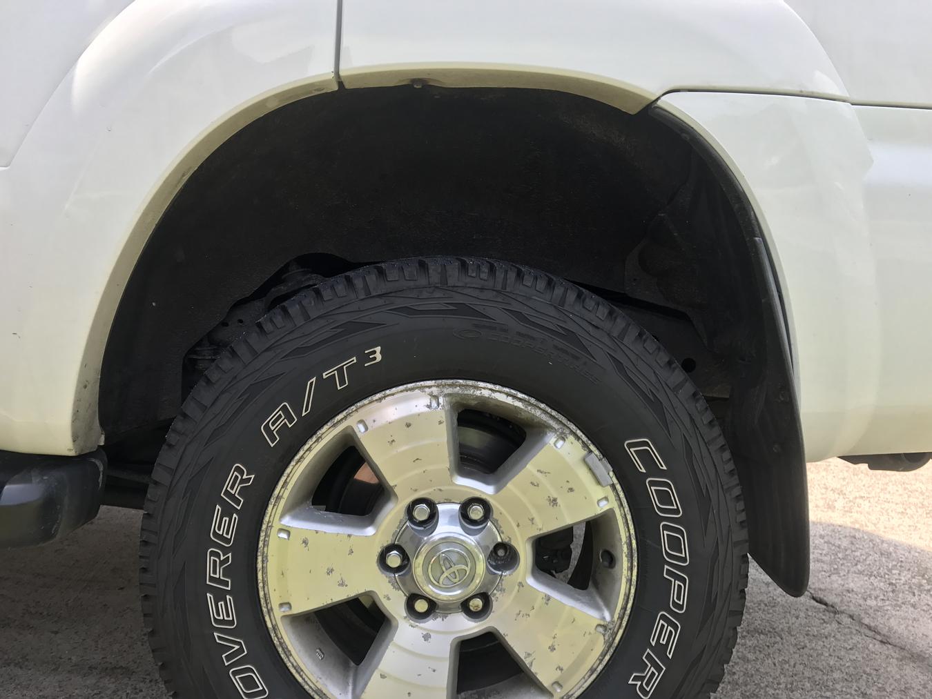

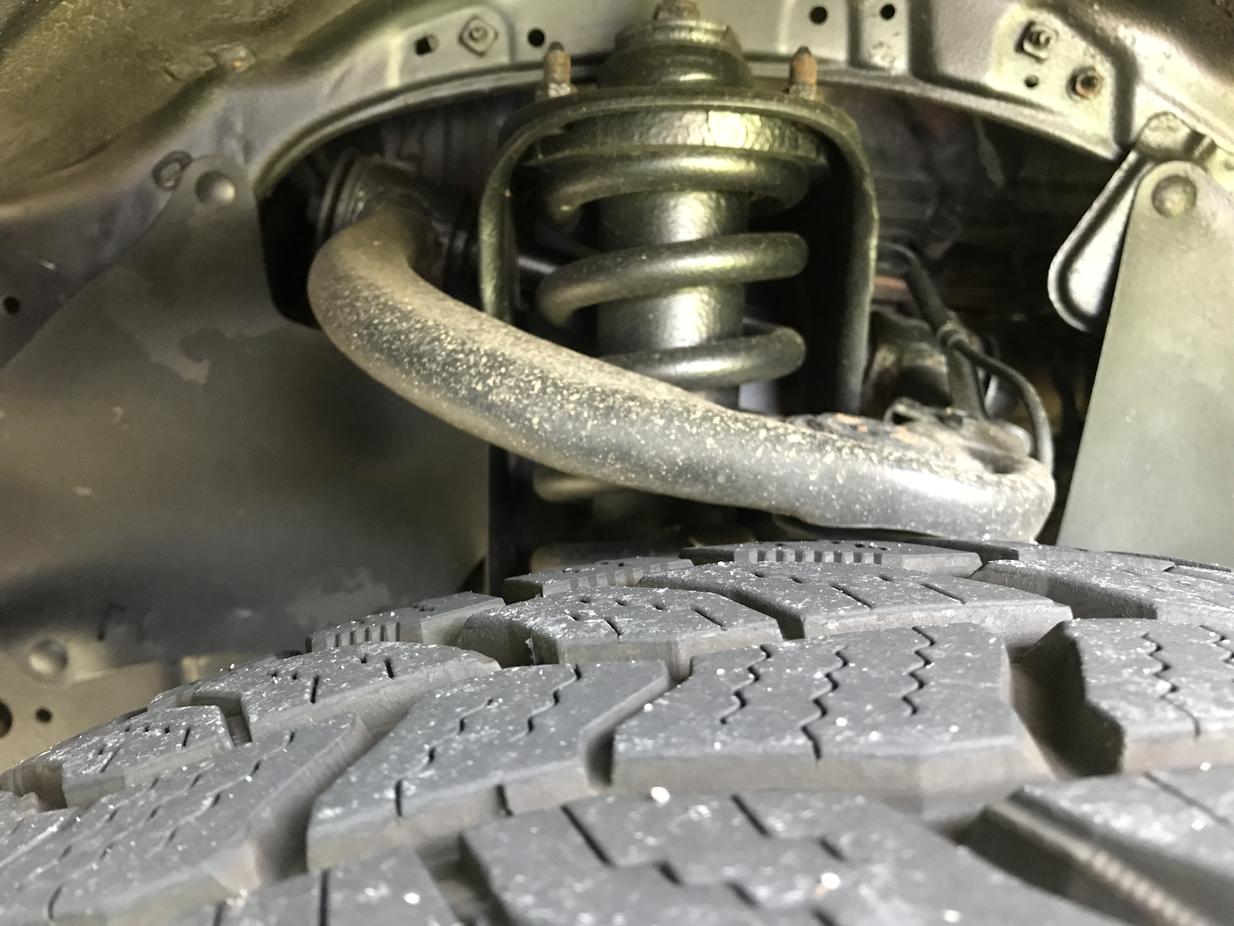

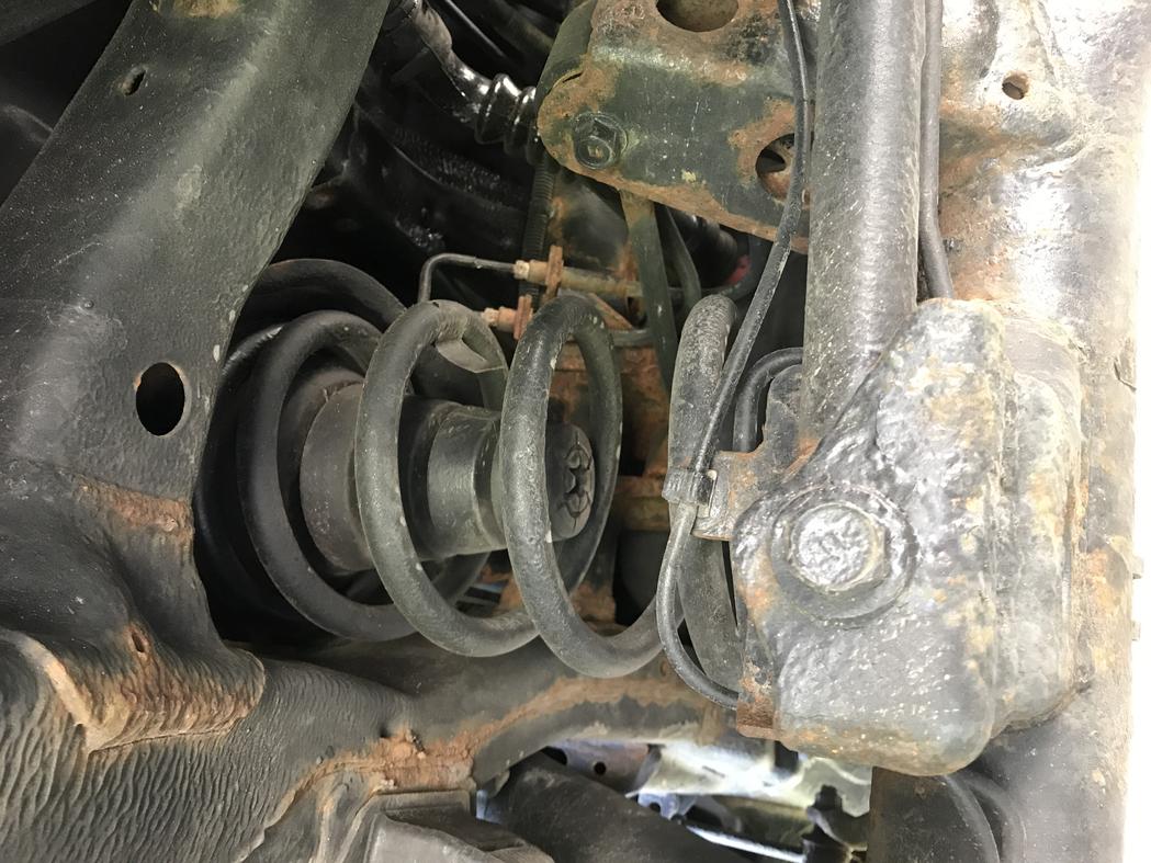

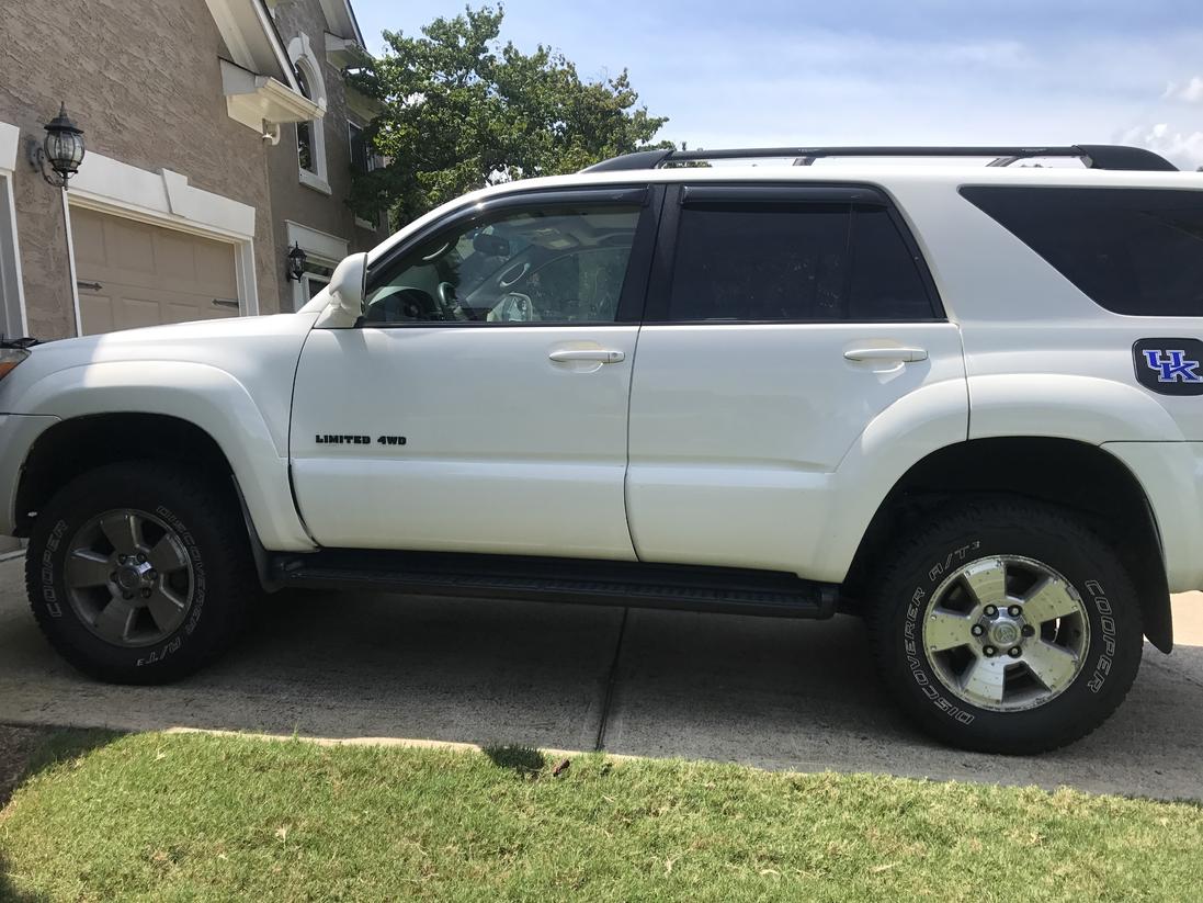

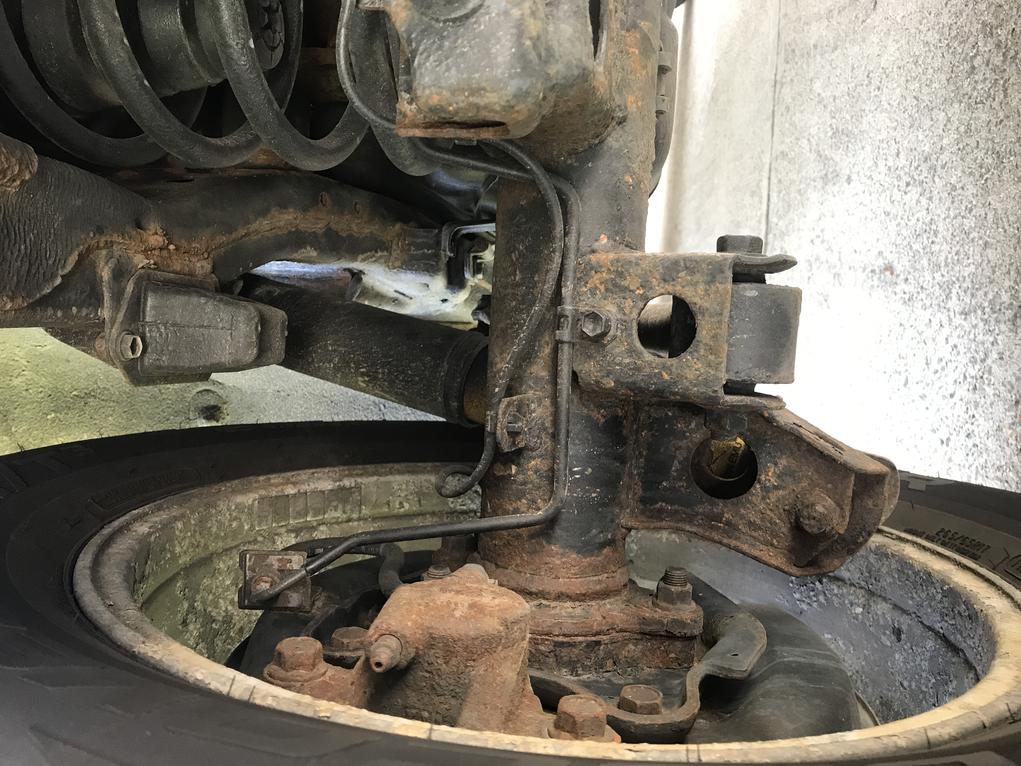

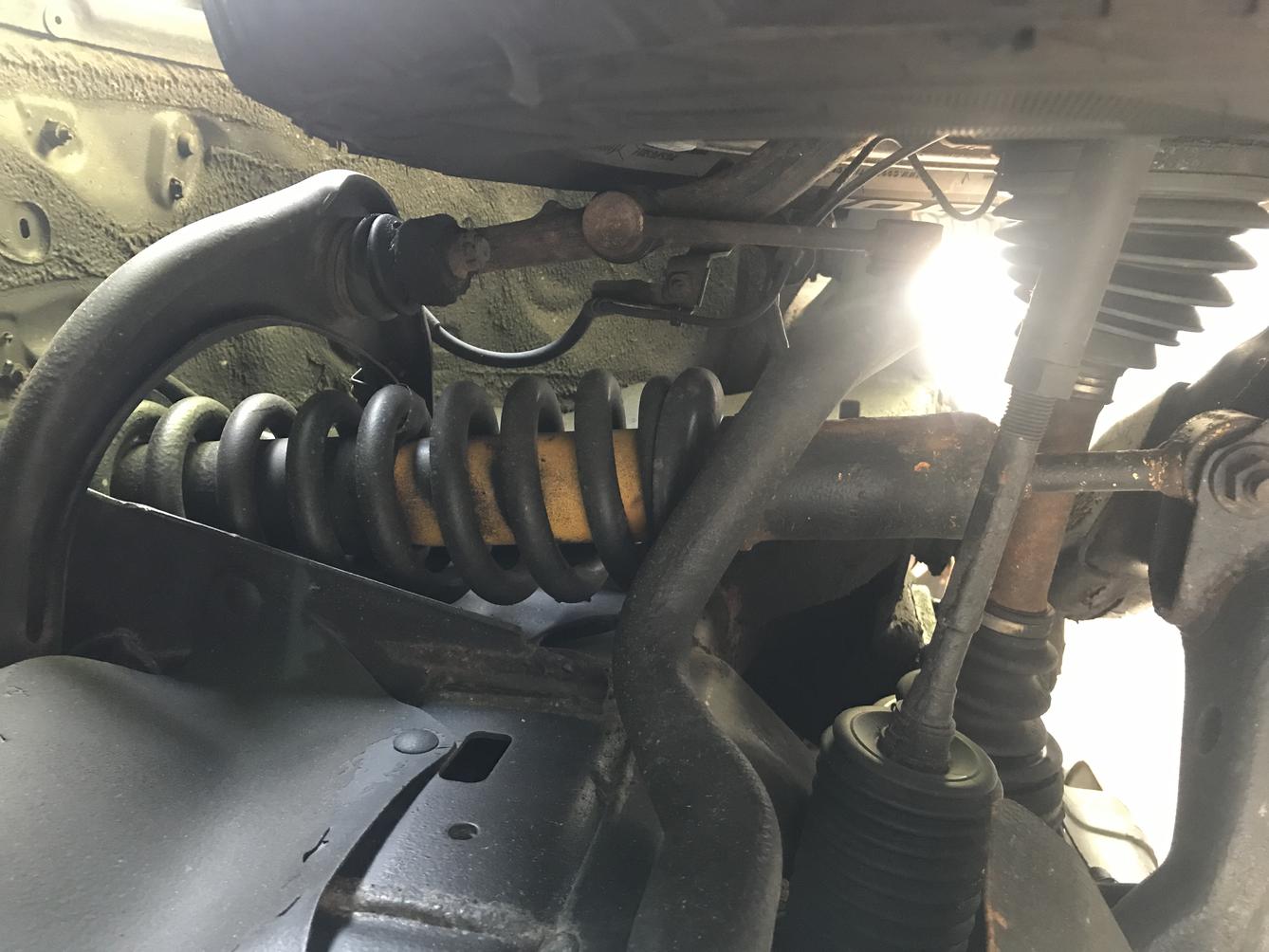

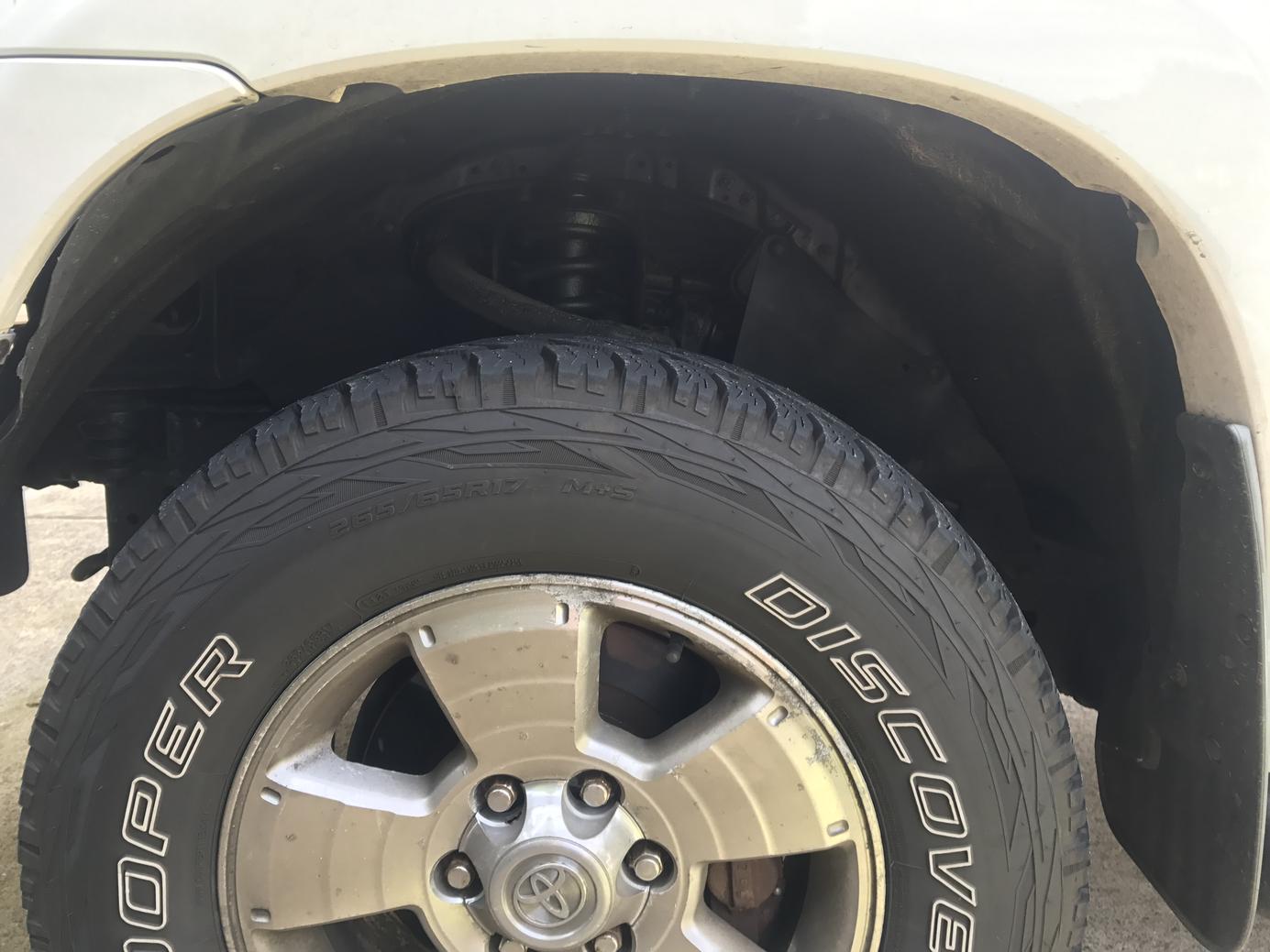

Take a few pictures of your front/rear suspension setup so we can tell you what your working with.
I wasn't sure exactly what pictures would be helpful so I took a few to try and cover it all, let me know if there's more needed! Once again, Thanks in advance!
(Sorry for the photo size! I wasn't sure how to put text in between the pics, so I tried to put them in order of the rear first then to the front. The 3rd, 4th, and 7th pics are also rotated sideways)

Old man emu lift by the looks of it. Looks like a lot of rust too
Yeah every time I crawl under there I get alittle uneasy, however I did have a pre-purchase inspection and they said it's mostly just surface rust.
Any idea on the best way to go about remedying it?

Get you some sand paper and a few beers, maybe less beer and more wire wheel. Then find you some good paint to make it look pretty.

OME,. pull the little paper tags off the springs, there should be a number like 2895 etc. That will help identify the type of spring, if its an medium or HD.
On the rust issue, I use WAXOYL on my frames when I can get it.
