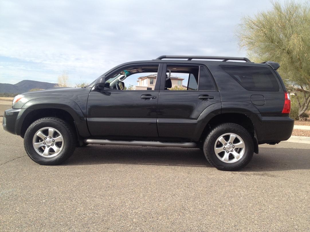

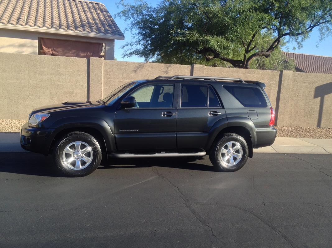

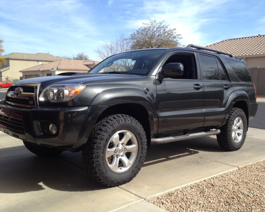

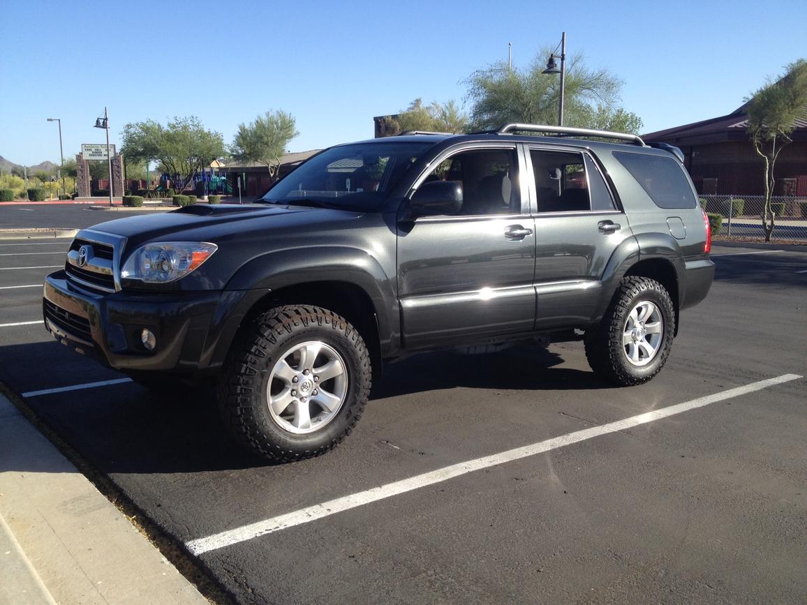

Here are some before and afters of my 2008 sport 4wd. I changes out the rear spings with brand new FJ springs, Bilstiens all around and added Spidertrax wheel spacers as well. This first pic is stock before any work. The second picture is after with stock size tires. The third is after going up a size on the tires, and the fourth is how it sits without the tube steps just a few weeks back. It still sits about 1/2 inch in the rear but when loaded with gear and stuff it sits close to level. Very happy with the performance on the highway, the new tires are smooth with very little road noise. And off road it does really well and the shocks just suck up the bumps. Very happy all around...
