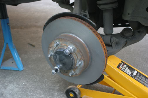

Did you make sure that the brake dust covers were positioned correctly? They can easily be bent one way or the other by accident and grind as you drive. More of a grinding and not a wet finger on a smooth surface, but worth a quick look.
brake dust covers? you mean the shims? as far as the shims I installed them all with a bit of brake grease, but that was pretty much it. Not sure about brake dust covers.... all I have is rotor, caliper, shim, pad...??
The piece that I'm talking about is immediately behind the rotor in this picture, it is thin material and if it is slightly bent towards the rotor, the rotor will grind on it when you drive.
Like I said, this may not be the part that is causing the issue for you, but it is easy to check. You don't need to pull the wheel or anything.
Ahh, OK, yeah the brake dust covers are fine. No grinding sound ... The sound / feeling I get is more of a rubbery / catchy sound, like the pads are a bit grabby, but only happens when I apply the brakes, like backing out of the driveway or something... for the first few stops of the day, then it goes away for the rest of the day. Almost like a tad bit of brake dust lubes 'em up or something I dunno.
