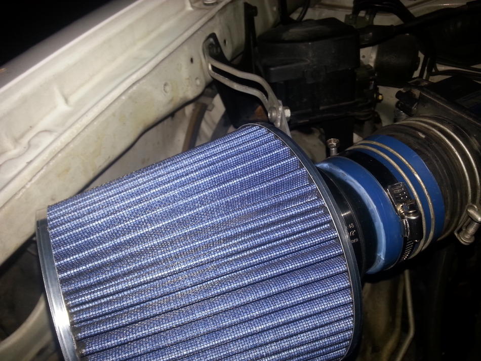

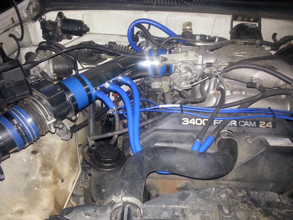

Here is what it is, i see nothing wrong, maybe its just too much of a high flow filter, guess ill just call out of work tomorrow and get another kind of filter.

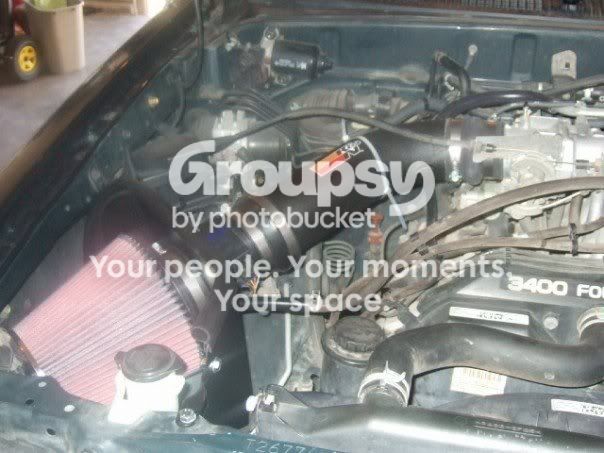

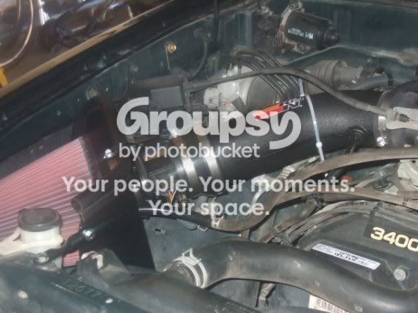

Edit I FOUND OUT UR PROBLEM! LOOK AT MY PICTURES
YOU INSTALLED YOUR MAF BACKWARDS
take the 5 inch pipe out, reverse it 180 deg and it should fire right up!

You are the man, that was the problem exactly, back to running like a champ. Nothing like waking up at 530, opening this page up and going out there to fix my 4runner and have it work 30 mins before work. Thanks a bunch man.
