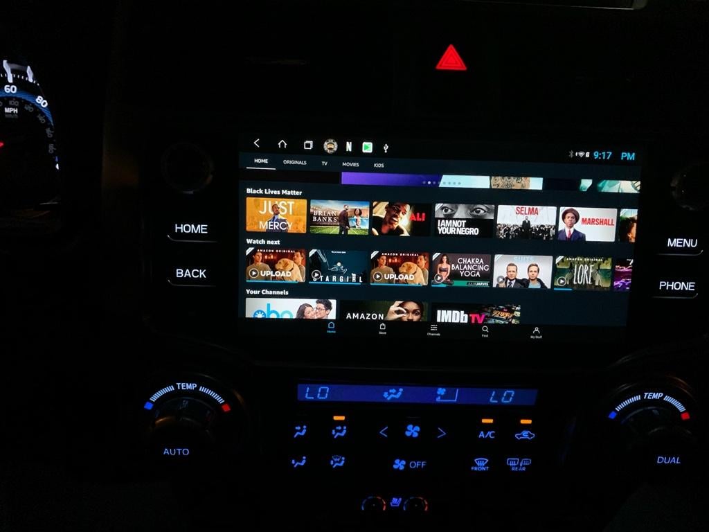

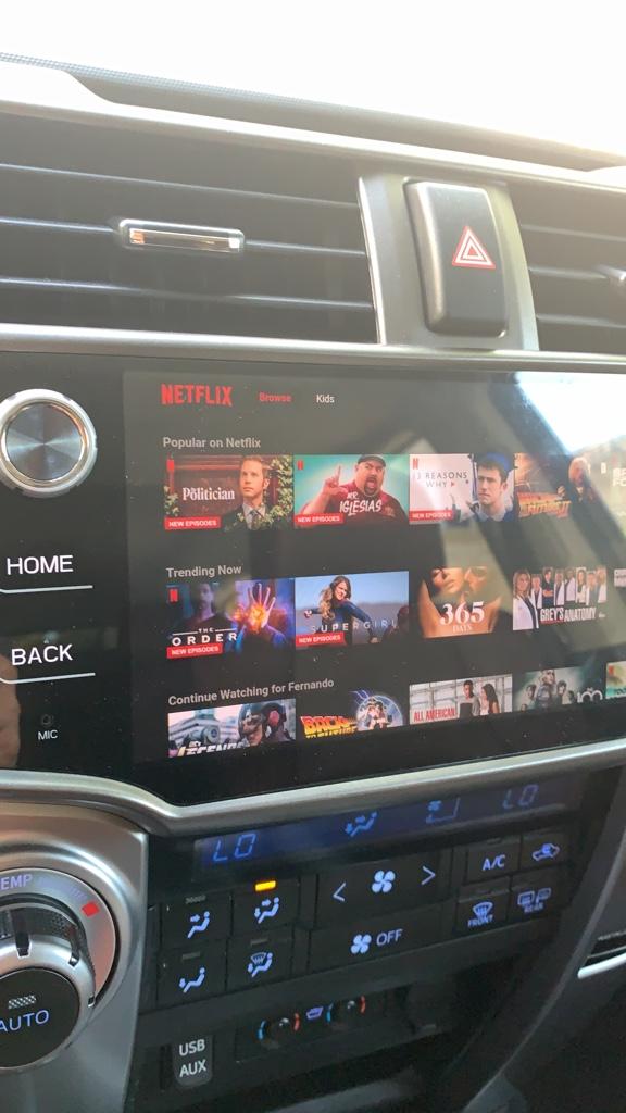

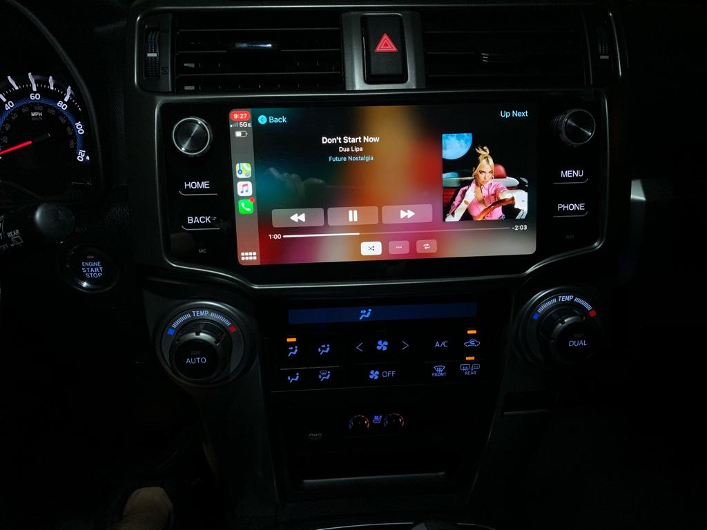

It’s been a few months now and it’s awesome. Keep in mind, I mainly use it for wireless CarPlay. The t9 supports all kinds of android apps, but so far I’ve only used Netflix and Prime Video. Here are a few pictures.

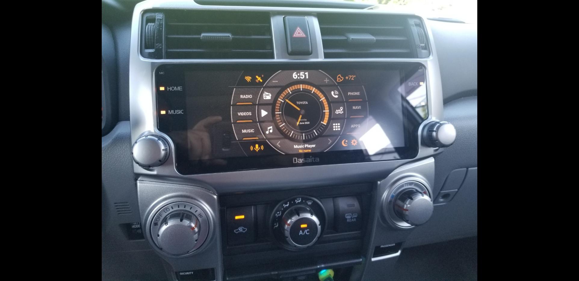

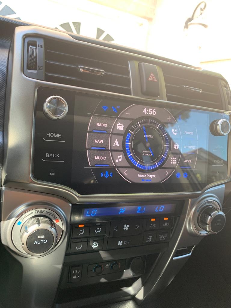

So the new head unit is avaliable, ive had it for about 2 weeks now. And it is deffinetly great. Im pretty happy, small litle issues here and there but overall a great looking and working unit.

Wow. Looks just as nice as the T9. Wasn’t sure what it would look like with the knobs in the lower part of the unit. Any suggestions for install once mine comes in?
