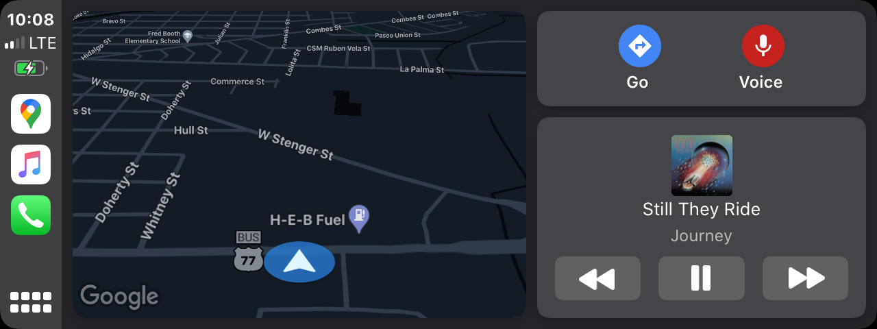

Update: Going on 2 months since install of Dasaita headunit. No issues whatsoever, so far. Image is from CarPlay split screen with Google maps running. One of the current Google updates allows their maps to show up on the split screen, so no longer limited to Apple maps.
In the 2 months I've been running this radio, and its almost on a daily basis as I run "Favors" in my area, a delivery service, this headunit has not let me down so far. I'm constantly using navigation for deliveries. CarPlay has only failed to load once, and that's when I was running to the grocery store. After shopping, and starting the car up, it connected without any issue without me having to mess with anything. I'm very happy with this radio, and no, I have not received any compensation from anyone. Bought the unit with my own money and my video on youtube is just for information for those looking at a different unit than the T9. Hoping the build quality is good and it lasts me a couple of years.

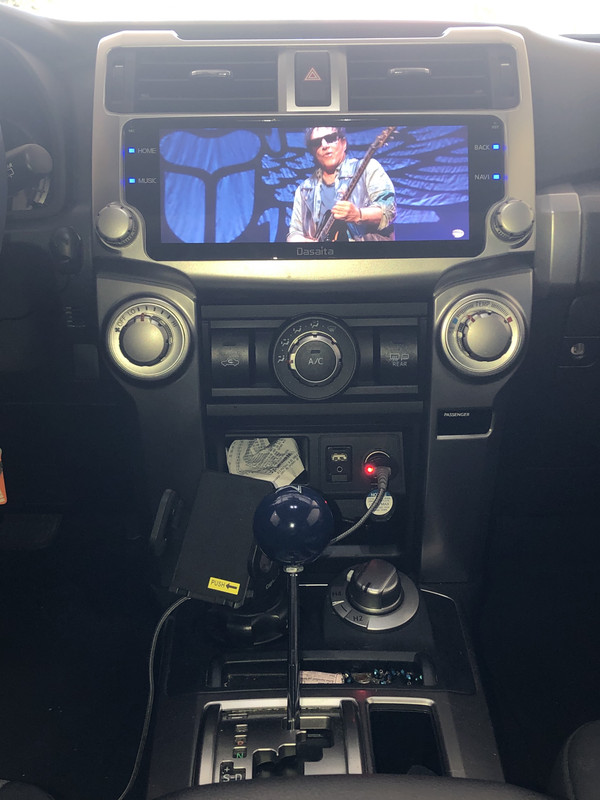

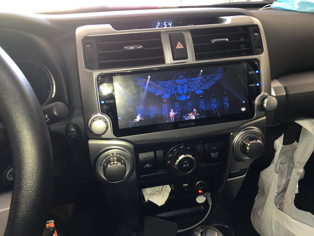

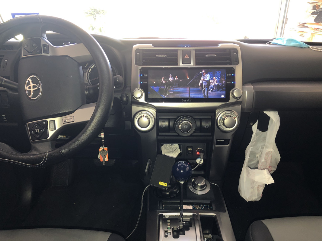

Installed this unit last week and like it so far
Hello there! I bought a '17 SR5 2 weeks ago. Love it a lot so far. One of my first mods was to get rid of the old head unit. I really liked the look of this new Dasaita 10.25" unit because it has the matching knobs and doesn't cover the vents. Also it being less than half the price of the Alpine unit helped a lot too. So I installed this unit last week in my '17 SR5. The install went really well. I have 2 minor things I am working through.
