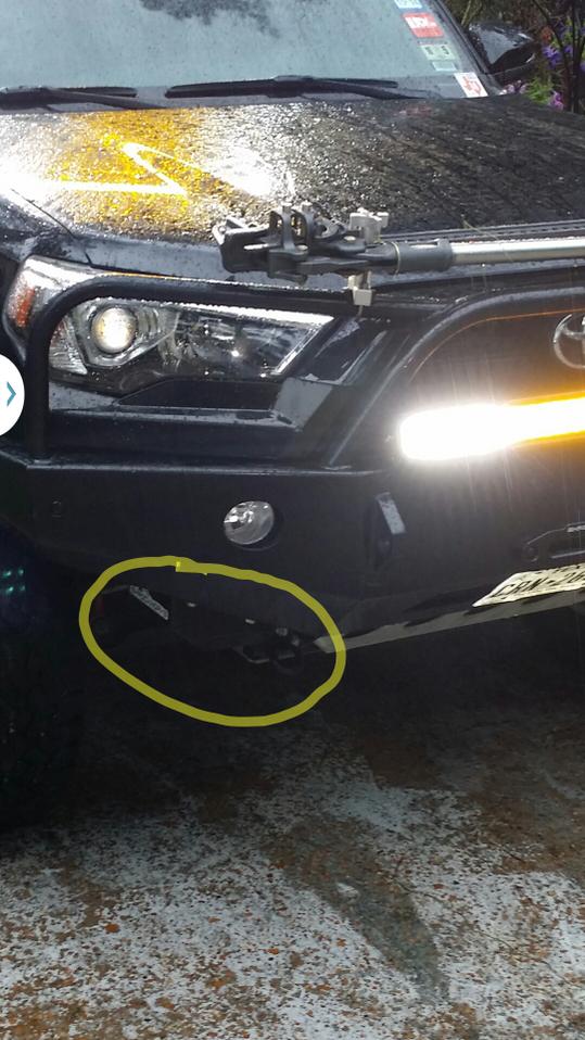

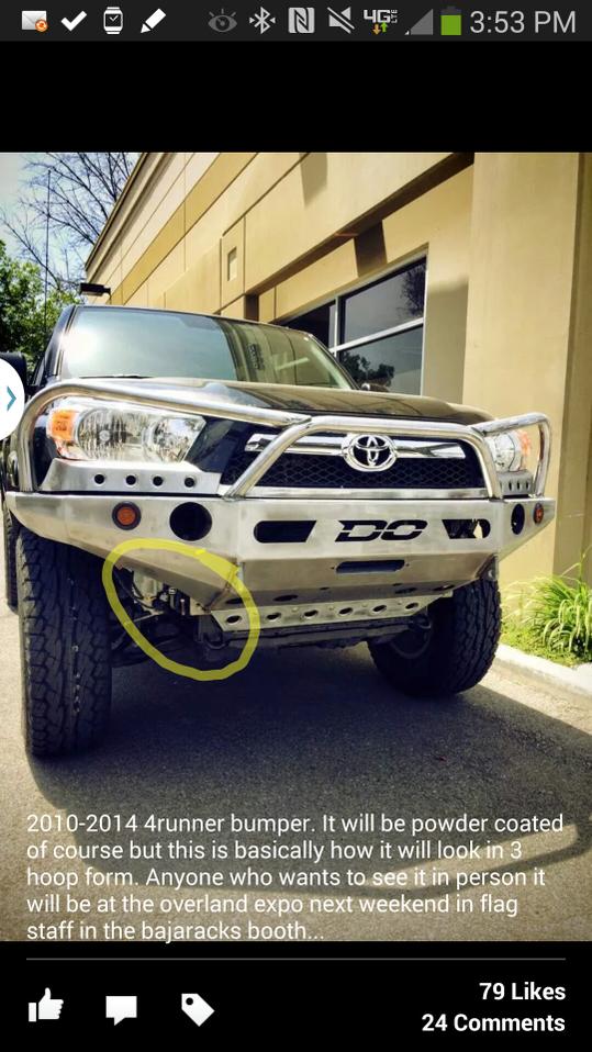

Their FB page says that the 2014 filler plate below the headlight will be different and they also stated that they will remove the extra hole in the bumper for the 2014s. One difference I see between DO and Shrockworks would be the better coverage and protection that Shrockworks has. I am sure that DO will not leave that exposed.

Liked it better before the hoops we're added, if anything center hoop only. At least you will be able to order it which ever way you want.

Yes this will be the 2010-2014 bumper The only difference we see as of now for the 2014 will be the headlight pieces.
We will most likely do an aluminum, the price will be roughly 300-400 more than the steel version. The big cost increase is the aluminum but also the 1in shakles that will replace the 1/2in shackles now. We feel that bumping up most of the material sizes is key for strength in the aluminum.
Price wise on this bumper, it will be in line with what else is out there. Maybe a little more maybe a little less on a GB.
Lead time, we know we are no better than anyone else on lead times right now but we are working on it. We currently actually have 2006-2009 bumpers in stock 10 of them. So it is an issue we are addressing.
extra water bottle protection, we are firm believers that putting a thin skid plate over a water bottle gives false sense of security and any hit to that area would just crush the skid and most likely destroy the water bottle. We also like to keep ground clearance as high as possible. Two things that don't go hand and hand.
This 4runner belongs to the owner of baja racks and he was kind enough to let us use it. There are some pictures floating around of this bumper all powder coated and his team added some washer bottle coverings but they will be removed.
