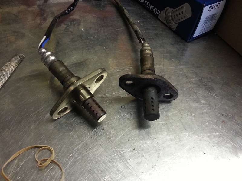

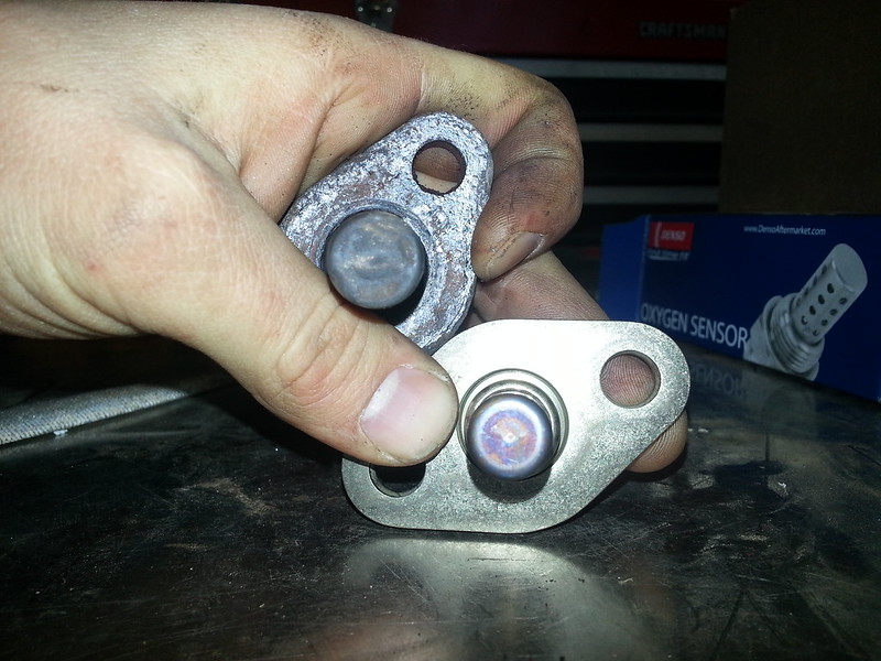

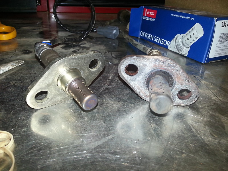

The 234-4153 does not match the sensor that I pulled out. The one I removed had a Toyota logo on it.
These pictures show the difference. I threw the old one in the trash at my parents'. My dad will get back to me soon with whatever kind of info on the old sensor that he can read from it.
20150103_123440 by samwisemason, on Flickr
20150103_123344 by samwisemason, on Flickr
20150103_123332 by samwisemason, on Flickr

If you look at the picture the new one has a lip. that is to wide... other than that everything matches up. I'm going to get under there again and maybe I just have to tighten down the nuts and force it in.

if you look at the pic from the original post it is exactly the same.
So I’m an idiot. It fits but it’s really snug. I was worried about ruining it but the force of the bolts gets it set proper.
