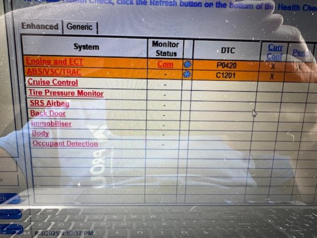

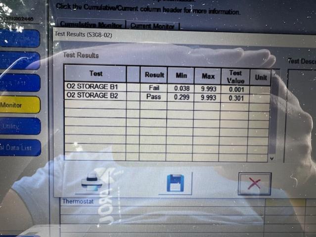

P0420 - more specifically o2 Storage B1 Fail (see pics)
I'd like to try to change the o2 sensors before considering the horrendously expensive cat / exhaust replacement.

This code is in relation to the data being reported by the downstream O2 sensor. Your diagram that was included doesn't apply to our 4runners. We only have a total of 4 sensors - 1 upstream and 1 downstream per bank.
Denso part #2344261.
Careful with Amazon unless it's Denso themselves selling them. From what I've seen though, codes P0420 & P0430 are not usually fixed by changing the o2 sensor. Exhaust leaks can cause them and of course a cat that is getting old. Some fool the system with extenders (plug defouler) and one person here covered the end with something that looked like a thimble. Thread was called something like "say hello to my little friend".
