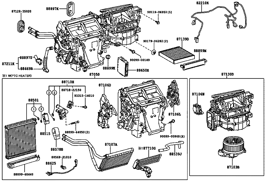

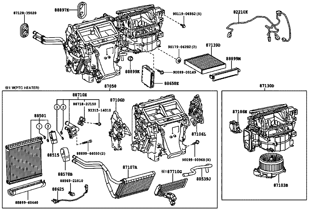

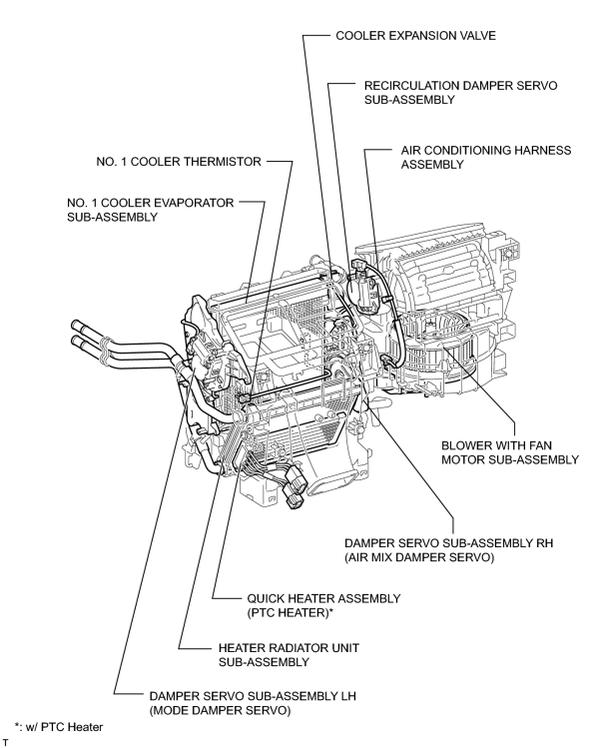

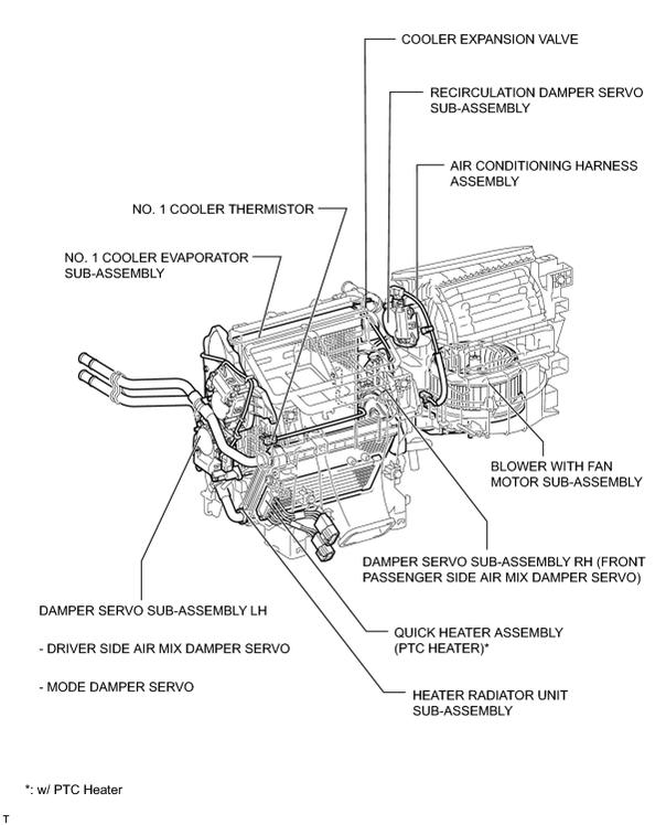

I also think you might only need one new servo. The passenger side servo has the same part number for auto and manual climate control, whereas the driver's side has two different numbers and looks different in the diagrams (second servo motor on the part for the auto). Check out the wiring diagram (attached) where it shows the servo motors.
Manual diagrams
Auto diagrams
