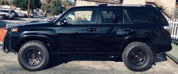

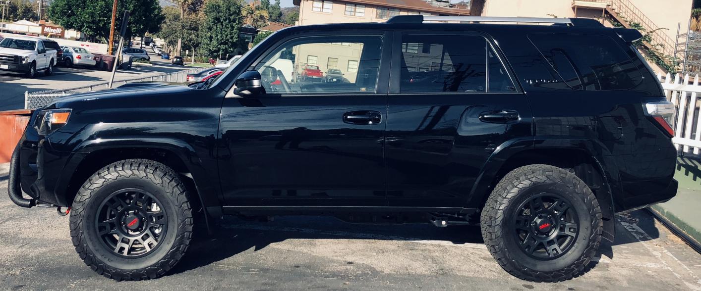

Does it matter that I have a Pro??
You will not have any problems on the Pro as the front is one inch higher than the other 4Runners and they have the fender liner mod done at the port. I ran 275-70-17 KO2’s on mine when stock without issues.
