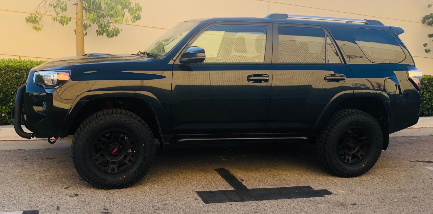

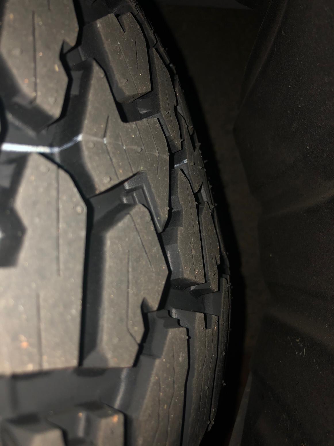

I have these in stock size, 265/70/17. SCRunner12's review is pretty spot on :bravo: They are pretty quiet compared to stock tires. So far, I'm happy with them especially since I got them for a good price. I haven't had a chance to wheel with them yet, but when I do, I'll chime back in.
These wheels look good! What wheels are they? width and offset?

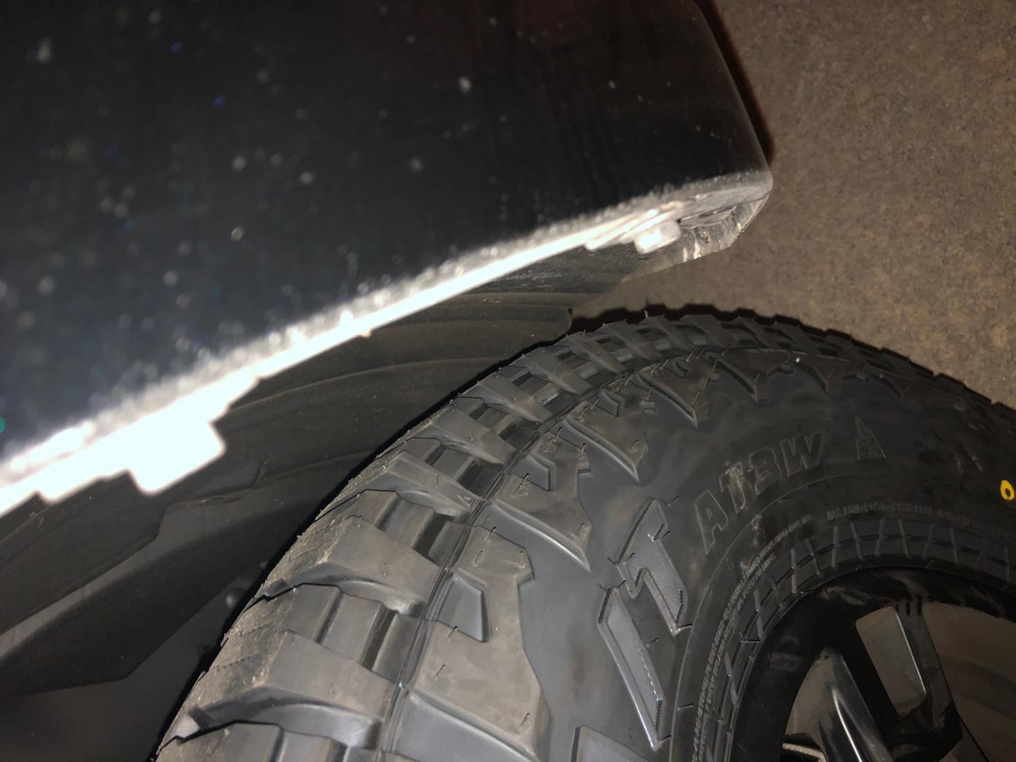

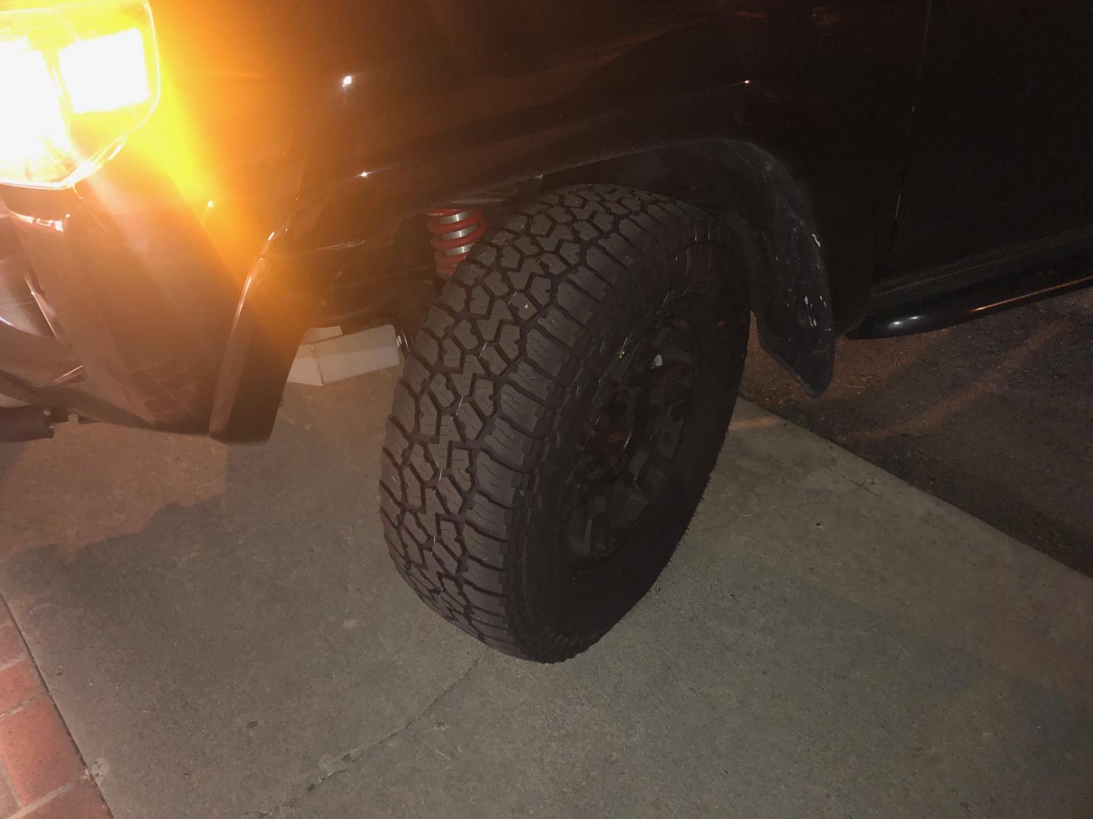

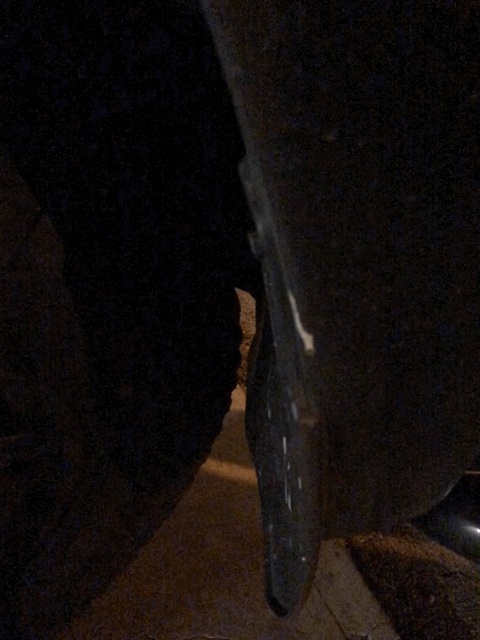

Here are some pics with a 1.5" Cornfed spacer up front with AT3W's in 285/70-17 with slight articulation. No rubbing with a minimum of 1" clearance on the front fenders or back at the mud flaps. No clearance issues with the UCA's either.

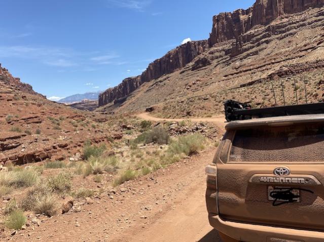

We run our stock size SL rated AT3Ws all the way down to 15PSI without any issues off-road in desert and rocks. This tire does especially well in wet snow and mud between 28-36PSI with our heavy loads.
We were at 18PSI for the last 2 photos.

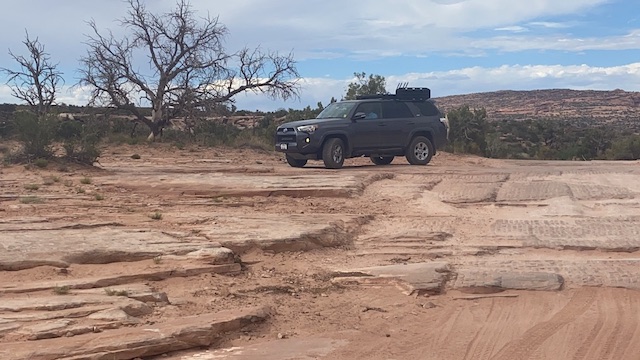

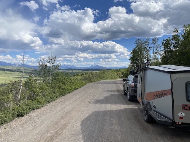

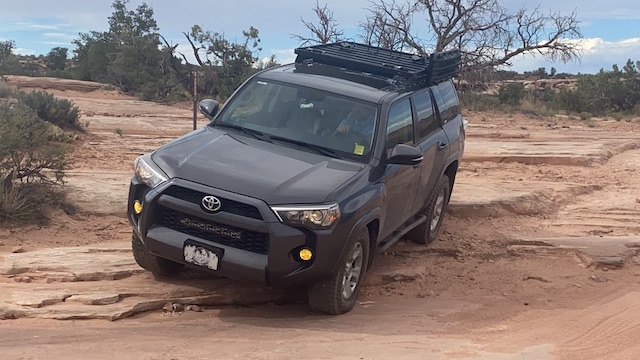

I will completely agree with what [MENTION=73851]007Tacoma[/MENTION] stated above. Over 20,000 miles on our SL 265 Falkens on and off-road with only positives. Great in rain, snow, rocks, mud, sand...you name it, they handled it. We even tow a 2,000lb travel trailer on our adventures and they have really held up to towing as well.
We do air down, 25 psi gravel/light off-road, 20 psi rock, 15 psi sand and have had no issues.
