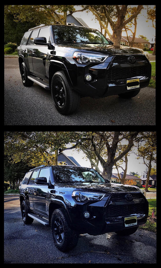

Local tire shop matched if not beat any online price I could find ...got them ordered, delivered, and installed in 24hrs..wifeys kid hauler looks so much better now..

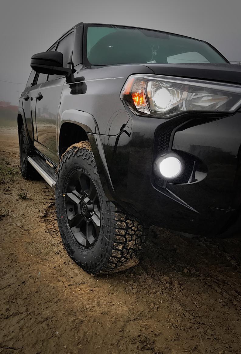

First beach trip with the falkens, spent the day at OBX. Went up to Corolla beach and had no issues whatsoever out on the sand.

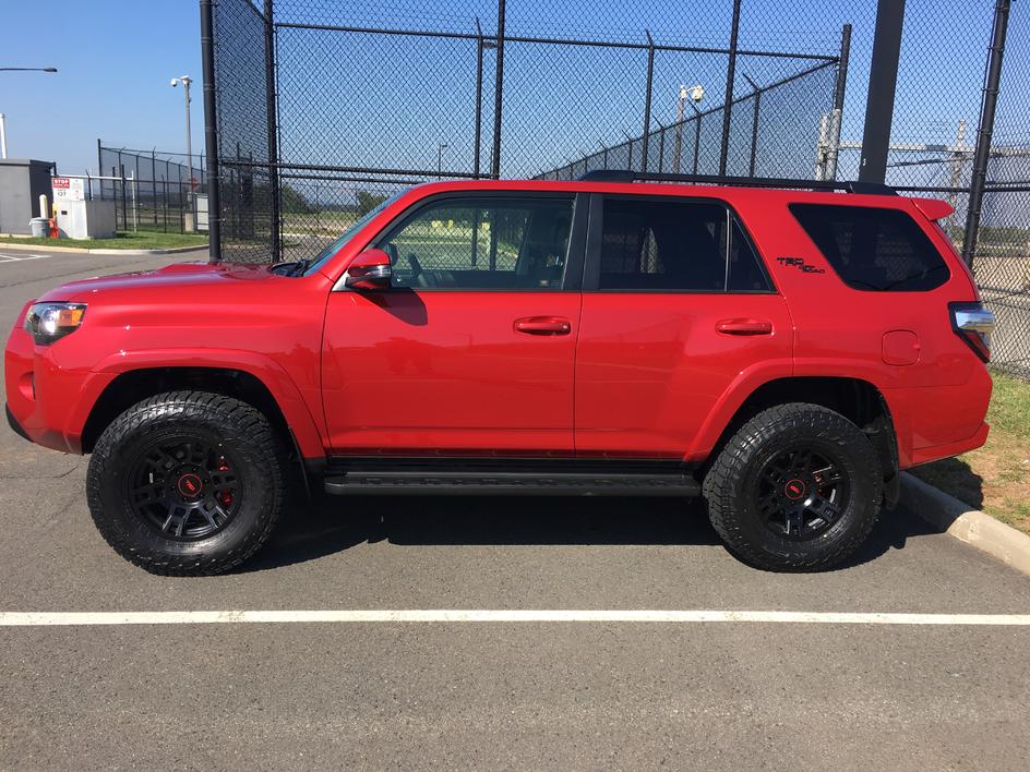

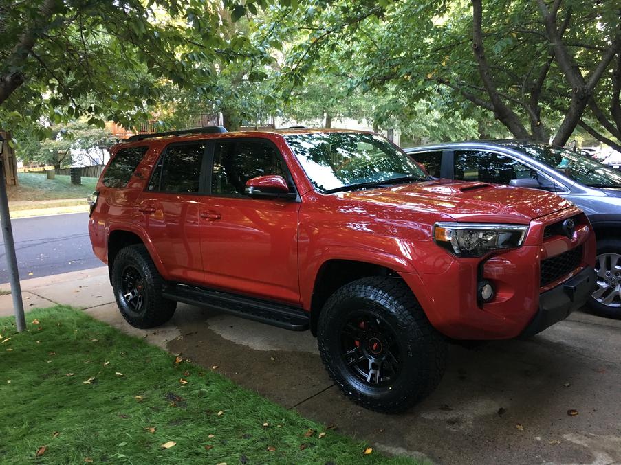

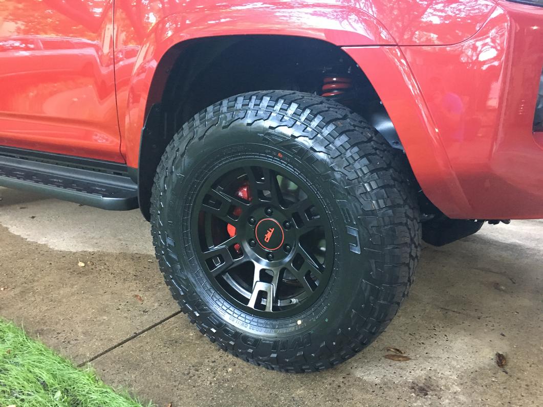

Just got P285/70/17 installed. No lift, just moved the fender liner forward, trimmed the bumper, and took a heat gun to the rear of the fender liner. I'm not running mud flaps.
Without the mods, there was a lot of rubbing when turning, especially in reverse. That being said, that may be due to the aftermarket wheel offset. Now there is no rubbing with normal driving, but an occasional scuff when parking.
Very happy with the tire so far! Much quieter than the worn duratracs I was running, and the wider tire looks good. I wasn't sold on how the sidewall looked based on internet photos, but like others have said, they look better in person.
I commute 70 miles a day, so I'll report in on gas mileage changes.
