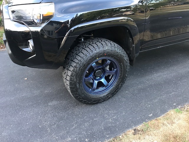

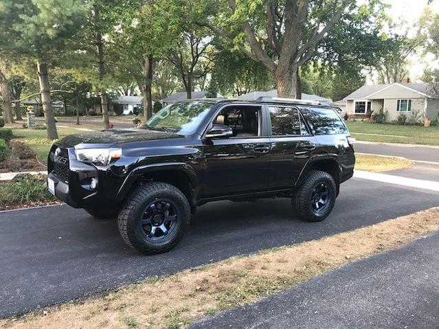

Finally got around to getting these tires today. I did a lot of research and determined the AT3W's seemed like the best bang for the buck. I'm hoping tomorrow I can try them out on some dirt.
Had stock size P-Metric A/T3W put on my new TRD Off road by the dealership before I took delivery. I love them, but then again I don't know any different :D
Beautiful home & driveway. Like the best of both worlds with the sleeper sedan and runner !! Great choices and thumbs up on matching colors
