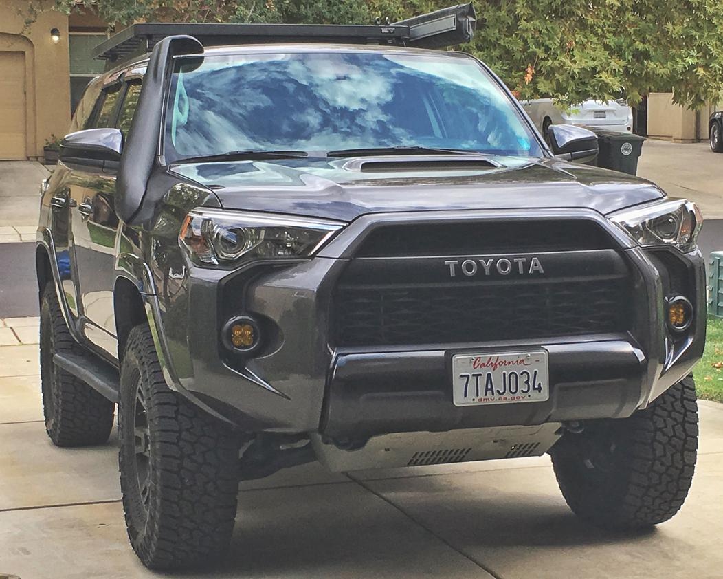

Here you go
Could you post a front picture? I have the same wheels and want to go 285’s (I currently have 275 KO2’s).

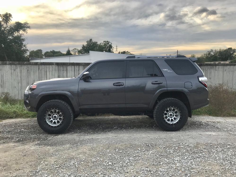

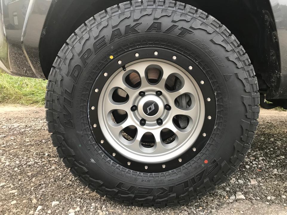

275's installed
Now just need to figure out how to get the TPMS light to turn off

Truck looks great! Can you post a head on shot as well?
How much of a lift are you running with the Bilsteins?
I'm about to install them just to level out the front on my '18 ORP and figured the 275/70 shouldn't give any issues with rubbing. Did you have any issues?

Thanks! I am definitely pleased.
The Bilsteins up front are set at 0. The Bilsteins in back are not adjustable. The lift comes from the Dobinson coils (300 up front giving ~1.75in and 599 in back giving ~1.5in). If you're aiming to level it with Bilsteins and stock coils, I'd set the fronts to the 0.85 setting. That will improve the rake. The tire fitment will really depend on the offset and width of the wheel you're using. My Ray10's are 8.5in wide with a -10mm offset and I had to remove the front mudflaps, push the fender liner in and trim a really small edge off the corner of the bumper.

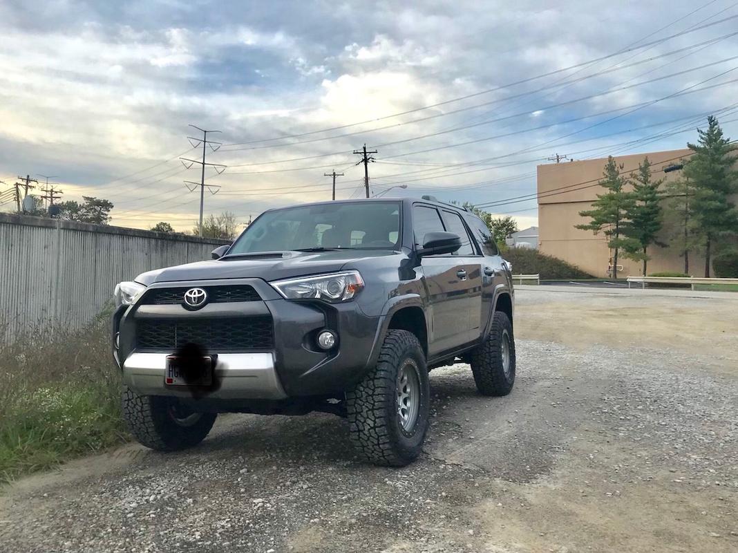

I attached a front face photo. Don't have any good headshots.
