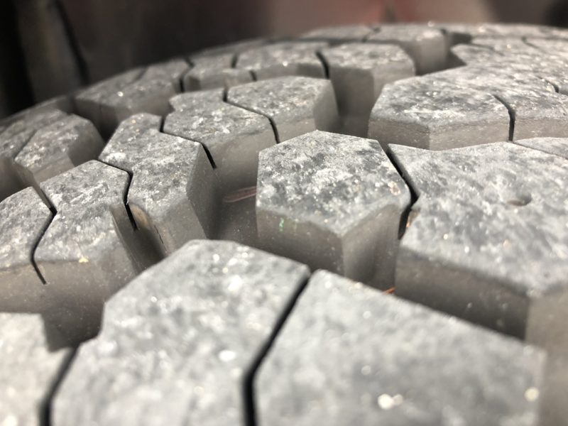

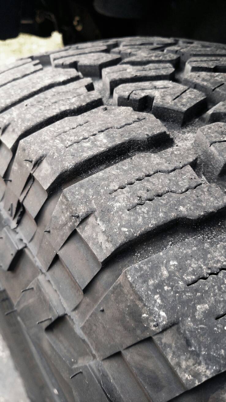

I was set on running Falkens, but that was one of my only concerns. After talking to a friend that had them I came to the conclusion that the siping wasn't very deep. And they lost a lot of their great traction capabilities after several thousand miles. I ended up going with the new Grabber ATX, and have been very impressed so far.
Grabber ATX after 8k miles vs Falken at 6k miles
I cannot tell 100% from the pic, but your friend's tires seem to be being destroyed by too much toe. They look low for 6000 mile tires and the edges totally do not look right. Of course, I can be totally wrong as well! Toe, even if a little off either way, can eat tires for breakfast. That's for sure.
Any lift? Alignments? Coil changes without multiple alignments?

Your picture of the Falken's looks like your tires are improperly inflated/poor alignment and therefore the uneven wear.. I have 23k on my Falken's and they aren't even worn down that much yet

The picture of the Falkens aren't my friends, they are ones posted by another member here several posts back. They posted that picture and said they were at 6k miles on them. But my friends did get chewed up a little before she thought and hoped they would.

What's up guys. I am the guy with the "worn" 6k Falkens, seemingly the topic of the night. :cheers: The picture was taken on a cell phone, and we all know how phone cameras feature tiny 4-6mm, (basically fisheye) lenses. I haven't noticed any uneven wear with these tires in the last (now) 7k miles, and just went out to measure tread depth across the entire width - a bit over 12/32". Now, doing some math, and assuming these started at a full 14/32" as per the Falken website for 265/75/16s and that I have a 1.5-2/32 loss every 7k, I'd have another ~30k to go until these tires start to get to roughly 6/32 range. Which, definitely isn't getting to the full 55k mileage warranty as others are finding, but for how much snow, ice, and salt I deal with on a winterly basis, I kind of expect it. For the price, you still can't beat these IMO, and unless something else comes out down the road, I'll be buying another set of these once I finally wear these out years ahead. Hope this helps. :rockon:

Hey, we already sent you off to an alignment shop :lmao:
Thanks so much for chiming in, mine started at 13/32 not 14/32nds so your wear may be a bit better. You might be getting as much as 7000 per 1/32 which is possible if you do not do much offroad.
