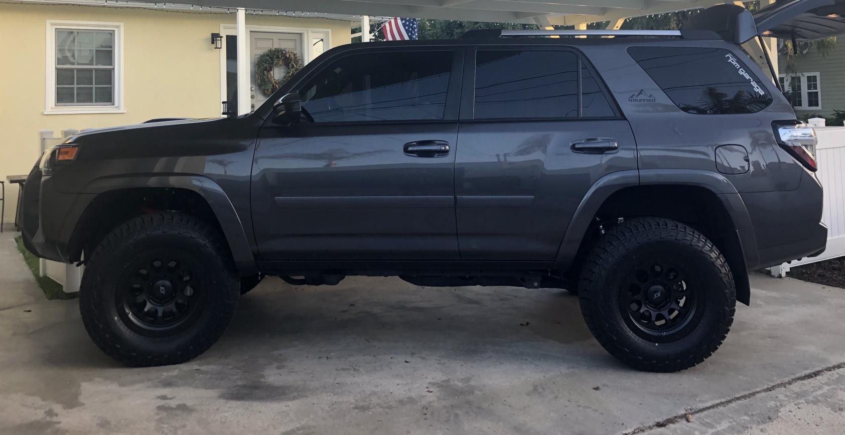

Just installed the P265/70/17’s on my ‘16 SR5 with SCS Stealth 6 wheels. I think they look great so far. I had about 45k on my stock Dunlop AT20’s. These are significantly quieter at the moment, even with the much more aggressive tread. I’m looking forward to seeing how they perform on snow (the reason I bought these) and will update when I have more feedback.
For anyone considering the same setup, I do have very minor rubbing on both sides. I’m on stock suspension and will do the fender liner mod to make a bit of room. I would not have been able to go any larger without doing some cutting of the bumper. This setup is a great way to fill the wheel up a bit more than stock while staying at stock tire size.
After:
This is pretty much the combo I'm looking for my '17 silver SR5. Are those the Stealth 6 the black or "matte gunmetal"? They seem darker than I would expect.
And, any lift or leveling on yours?
I'm super stoked about these AT3W's - just need my AT20's to wear out a little more.
They’re the stealth 6 matte gunmetal. They’re pretty much what I was expecting. It’s overcast here, so they probably look a touch darker in these pics than they would in the sun. They look really high quality in person. I’m extremely happy.
No lift or level at the moment. Everything is bone stock except for the wheels. I’m going to put Bilstein 5100’s on front and back to reduce the brake dive this spring. I’ll lift the front .85 at that time.
