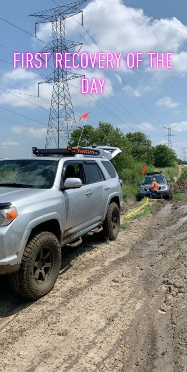

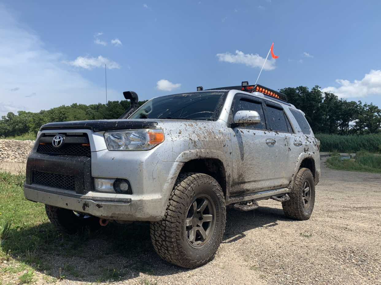

My Falkens never fail to impress (285/70 SL). I’m running around 36 psi on the street. I aired them down to 30 yesterday when I hit an off road park. They did extremely well (even in mud) and the only time I got into trouble was when I had a clearance issue which had no bearing on the tire. I had two recoveries as well when other struggled. Just an amazing tire and impressive off road.

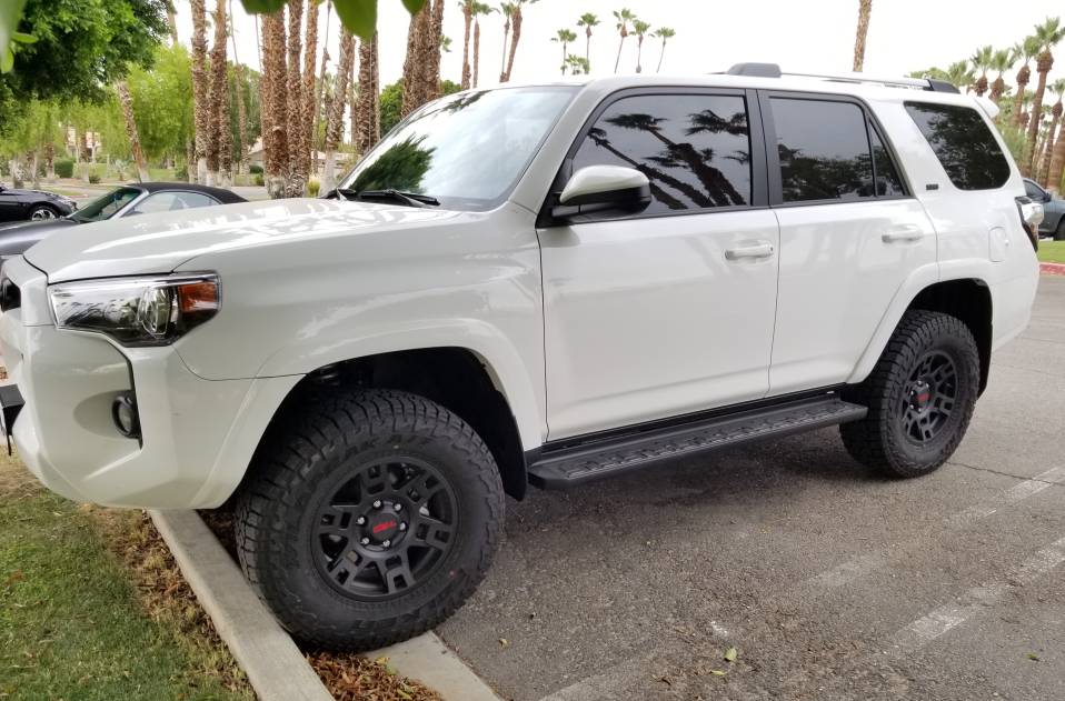

I've been following this thread and thought I'd chime in. I threw some C rated LT275/70r17's on my 17x7 TRD wheels. They look great to me. There was a tiny rub, more like a slight hum, in reverse at full lock, but the inner fender moved forward easily and that took care of it. I feel like I'm not running the right air pressure because the fine folks that installed them used the values on the door sticker (just before snapping a stud with an air gun) and the steering feels a little sluggish now. Anyone care to share their air pressures? Or a good way to come across the proper PSI?
Thanks!

Most P-rated tires are run at 32-psi. At 32-psi LT rated tires are underinflated, that's why it feels sluggish. I'd go up to 38-42 psi and see how it feels.
